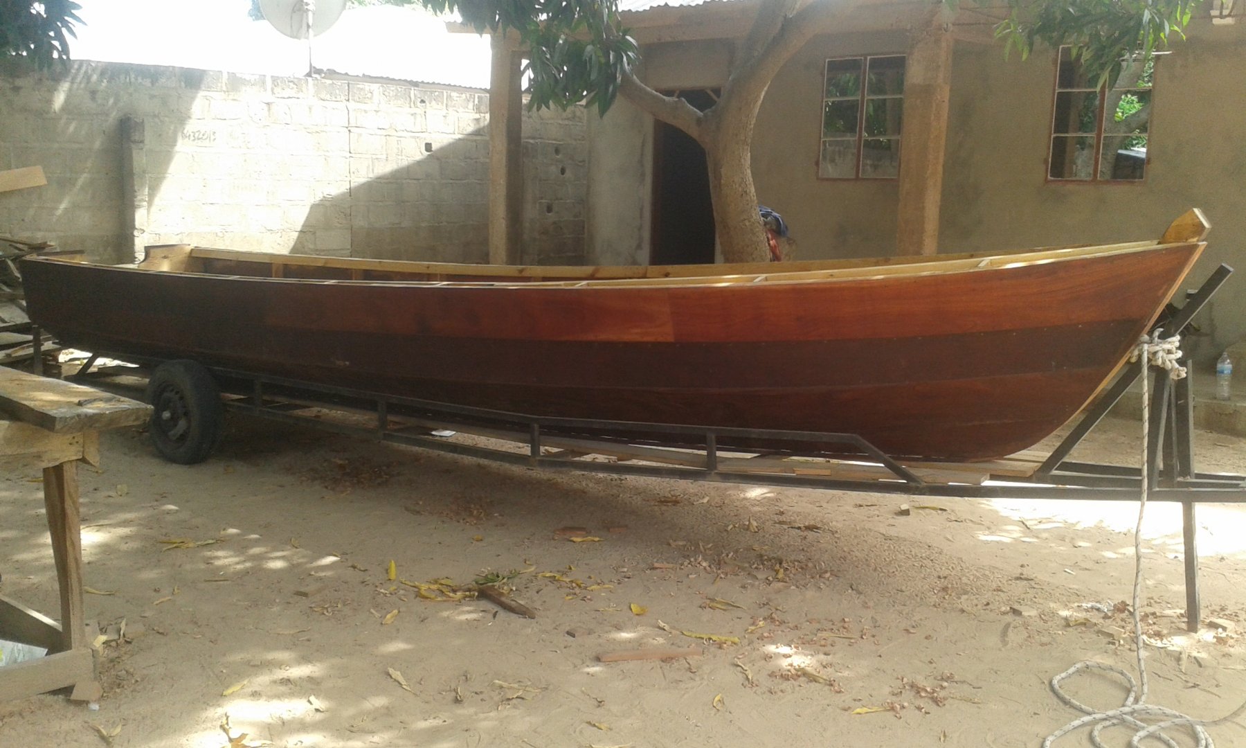

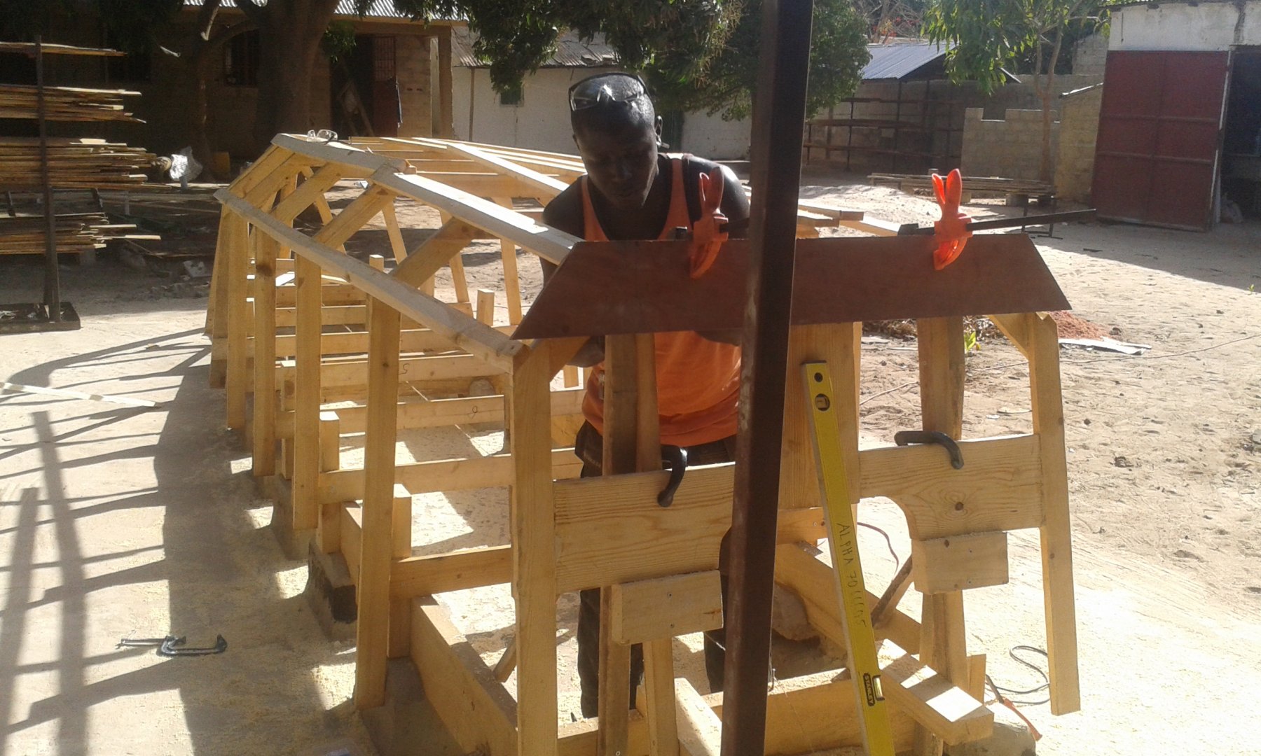

    This is a boat I designed for fishermen in the Gambia, 7,0 x 1,5
    Just now I design a larger boat with similar characteristics.
    JS

    Is the 1.5 beam the chime beam or BOA? Seems like it could get a little squirrelly on plane if the planning surface is only 1m, but you would know better than me.

    The planing surface beam is one meter. No poblem. Yes, I know better than you. ;-)

    Doesn’t chine walk?

    It's not a traditional "chine walk" but if the boat was on plane and rolled to port... the big flat could touch the water. It would create drag on the port side of the hull which would produce a yaw moment which causes a roll moment in the opposite direction which wets the flat on the starboard side of the hull. Repeat.
    I have a 5m x 1m soft bottom inflatable (google Saturn Kaboat) It rides on a 50cm air floor and has 25cm tubes outboard of it. and when lightly loaded it has this behavior if the boat leans and the tubes touch the water. It's moving slow enough it's not unsafe, but it is a weird feeling.

    With such a primitive form one cannot expect anything else. Just because it floats and looks like a boat, so it's not a boat.

    Do you have any photos or videos of your 7x1.5m running?
