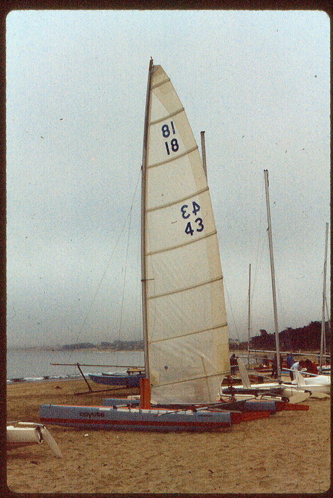

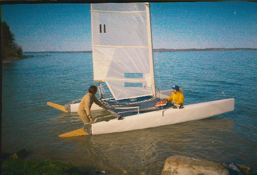

    As a newbie to this forum, just thought I would add from personal experience, that the 18 Square Meter class (in late 1970's) had a cat design called COYOTE which had a standard sail profile with a deck-sweeping cut. The sail was boomless, having a plate with holes fastened to the sail and at the rear, just behind the sweeper part. A Hook on the end of the mainsheet attached to the plate. The front hole helped flatten the sail, while using the back hole allowed maximum camber. The sail configuration did have a positive effect on speed, but I believe maximum was when sail was coupled with a curved traveler which handled leech tension regardless of sail position - inhauled or outhauled.
    I find the claims of "New" technology to be humorous, since obviously the concept and design was used nearly 40 years ago.
    Below are photos (probably circa 1979 or early 1980s - unidentified sailors with a COYOTE with deck sweeper main.
