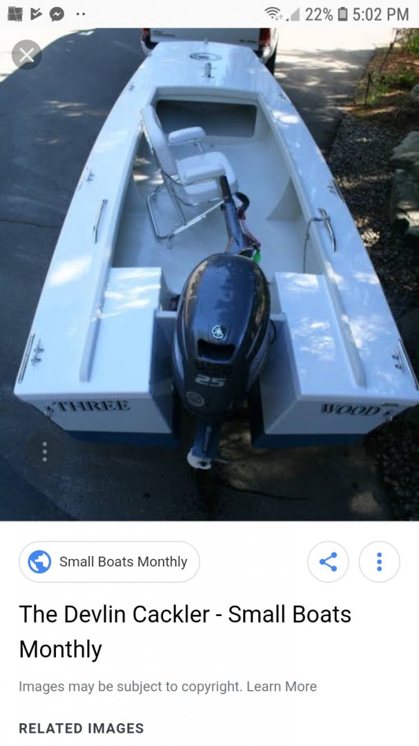

  14. Paul D
    Joined: Jun 2018
    Posts: 58
    Likes: 3, Points: 8
    Location: New Zealand
    Paul D Junior Member
    Would it help any with planing or anything with a transom like this...
  15. Mr Efficiency
    Joined: Oct 2010
    Posts: 9,878
    Mr Efficiency Senior Member
    No, you will just lose space inside the boat. That idea might have some merit if one-up, but with two persons, the other can sit forward to balance the boat. That engine in the pic looks like it would be hitting the boat before it got the full range of steering.
