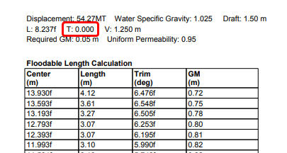

    This is as an existing vessel.The vessel has only 2 bulkheads.one at Engine room aft and other at engine room fwd.Now the vessel is going to register under an inland waterways.So at the time of plan approval surveyor asked us to provide the flooding calculation. I have made floodable length curve (attached) based on the hull and maximum draft.As per the curve,Floodable length at engine room area (3.597 m as center) is only 3.53 m.
    Length engine room is 4.5 m.
    I have given subdivision factor as 1 (Please correct if am wrong).So the permissible length of engine room is 3.53,which is less than the actual length of E.R
    What is ur opinion about this?

  10. Adarsh Edakkote
    Joined: Dec 2015
    Posts: 49
    Location: India
    Adarsh Edakkote Junior Member
    T(TCG)-Assumed as zero.
    Regarding GM value. This is Min.Required value of GM

    I do not know if giving the value of "L" in feet and the one of "V" in meters is correct. Check the input data. The boat is 40 m long but you have studied, according to the presented curve, a length of 13.5 feet ???
    On the other hand, the curve you get seems correct, although with "strange" results, for a ship 13.5 ft in length. For example, if you have a compartment whose geometric center is 2.5 feet from the Ap, the length of it could be 3.4 meters, which seems very appropriate. If you have a compartment whose geometric center is 7.5 feet from the AP, its length could be 6.2 m. For situation at 12. ft of the AP, they are 3 m long.
    After dividing the curve of the floodable length, the most comfortable is to place on the same curve the longitudinal profile of your boat, including watertight bulkheads, and check if that distribution is correct.
    If you provide us with the model of your boat, it is likely that someone can do a check. Something is your calculations can not be correct.

    L(LCG) is 8.23 m from forward of A.P."f" denotes fwd not feet.
    The vessel length is 16 m not 40 m.
    Hope this will clear your doubt
    L-LCG
    V-VCG
    T-TCG

    I have no doubts, my friend. I just seem to sense that some things are not correct and, therefore, with all due respect, I advise you to review the input data and the calculations that you have made. If you want more help, as I said before, it would be convenient to show us the model that you used in your calculations. Best regards.
