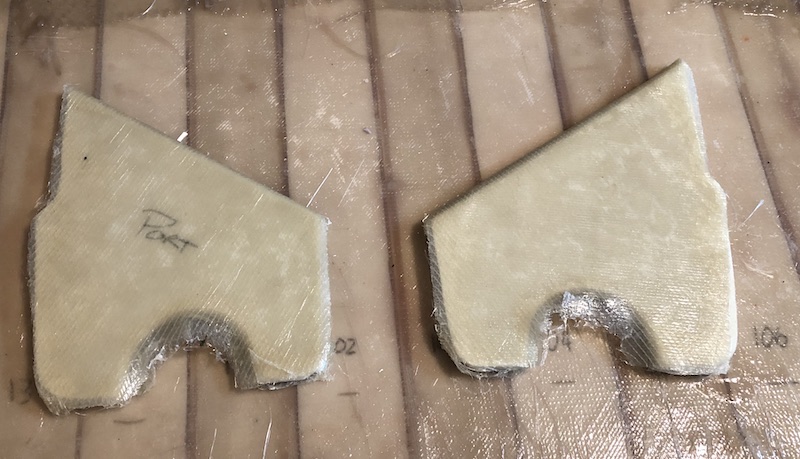

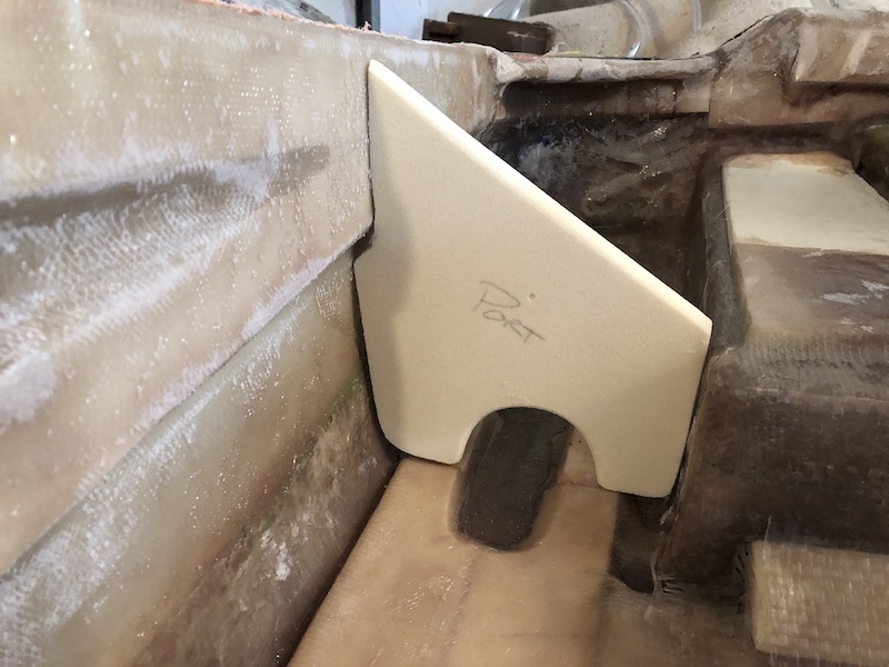

I'm going to add some braces on the sides to stiffen up those areas . . .
First I cut & shaped the foam core pieces.
Then I covered them with 1708 cloth. Here they are after curing, but still needing a bit of trimming.
I'll tab these into the sides with more 1708.

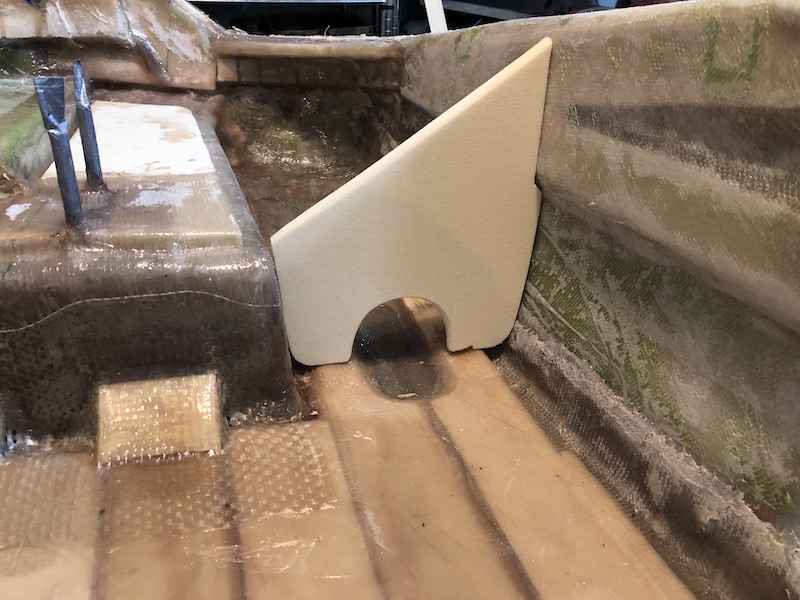

After a couple of weeks doing other stuff, I am back at it with the swim platform.
I made the rear structure shapes out of the foam board stock that I used for the coring.
Then I filled them with the pour-in foam and sanded them smooth, rounded corners, etc.
Then came the glass . . .
Now I am setting up the infusion.

The aft structure and side stiffeners are all glassed. Just finishing up a few odds and ends, then I will be pulling the platform from the mold next weekend (June 1st)
