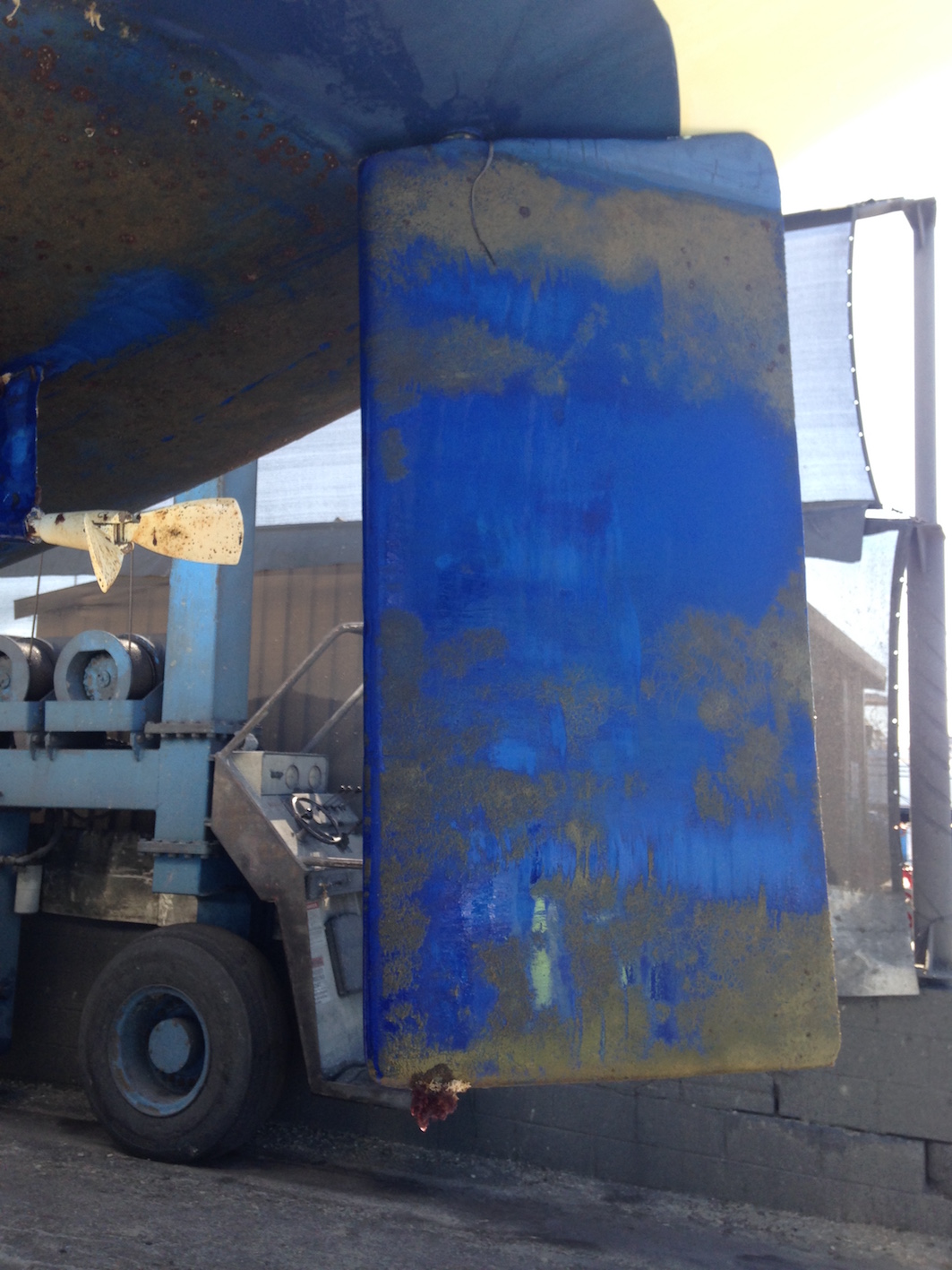

  14. Kim Klaka
    Joined: Feb 2017
    Posts: 14
    Likes: 3, Points: 3, Legacy Rep: 10
    Location: Fremantle, Western Australia
    Kim Klaka Junior Member
    My boat is as per the profile drawing posted by Joakim (the solid line profile, not the dotted one). picture attached. it is just a rectangle with NACA Section (approx 0012 reducing to 0010 at tip), with stock at around 10% aft of leading edge i.e. what would usually be considered too far forward. It is heavy (maybe 50-70kg) so not buoyant. Stock is vertical to within a couple of degrees.

    Seeing that rudder setup and weight, the following thing comes to my mind:
    - if your boat trims by bow (positive or bow-down trim) when motoring, then the turning moment caused by the weight of the rudder could be a cause of such behaviour. In other words, you might have the rudder CoG too far aft (relative to the stock), and the weight-induced moment cannot be overcome by the hydrodynamic moment. If this is true, then adding more chord can help alleviate the issue (by adding a hydrodynamic counter-moment) only if it doesn't shift the CoG further aft. Otherwise it may do nothing or may worsen the situation.
    In order to test this theory, you should put a weight at the stern to decrease (or invert) the bow trim and see if the situation changes.
    If it turns to be the cause, then you should find a way to shift the CoG of the rudder towards the stock, either by making the structure of the aft part of the blade lighter or by adding weight to the fwd part. The latter solutions will require a check of the rudder stock scantlings though.
