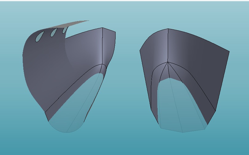

    hull on the left is a full compound surface job, one on the right is flat panel fold up. The savings seem to be great. Of course the compound surface has more volume in the bow areas. :(

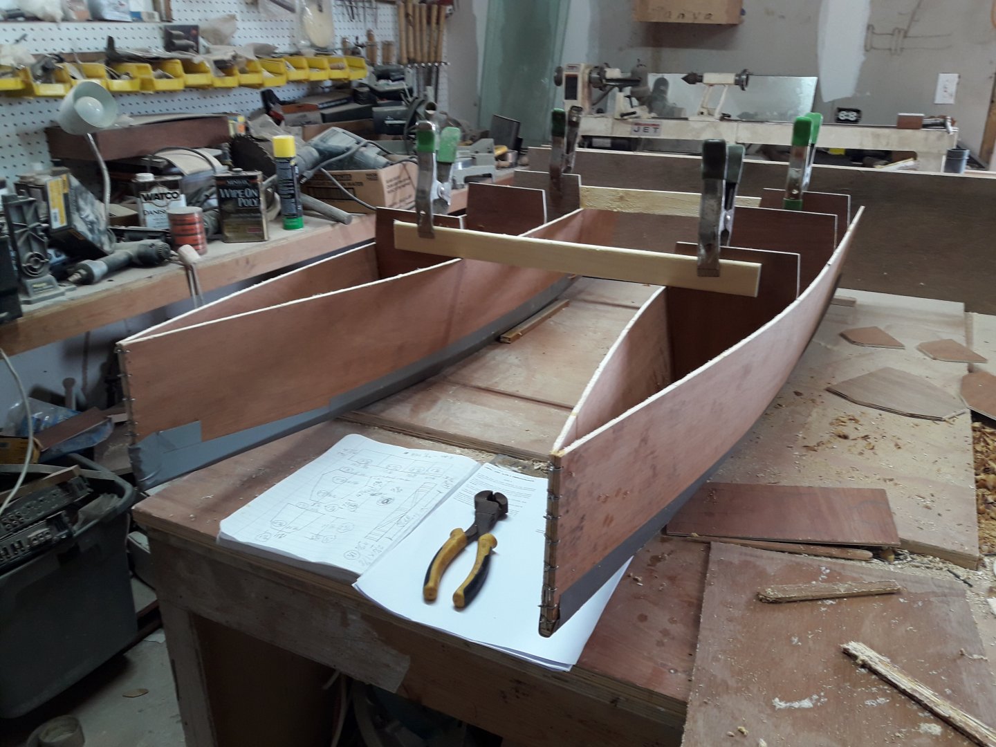

    Hi, i am from The Bahamas and i have been reading on Leon's CSC 30 for weeks now. This forum has given me a lot of info and i have started to build a model to see if this has the capacity that i would need to cruise the islands

    Actually the past few weeks I've been weighing between foam and ply construction or a mix of the two and then a few days ago on YouTube I found how cheap 105MC's are going for nowadays which is really making me question whether to go the easy route. It has to be low cost I'm not committed to selling up what I've got on land.
