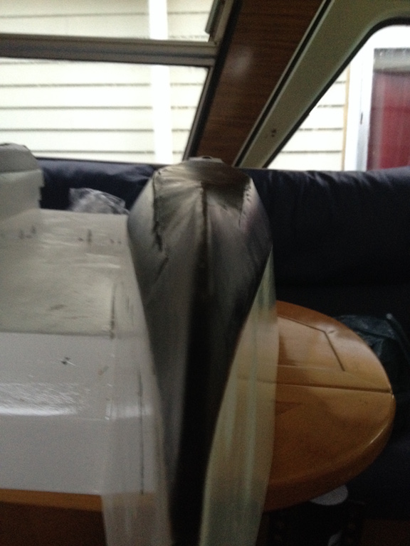

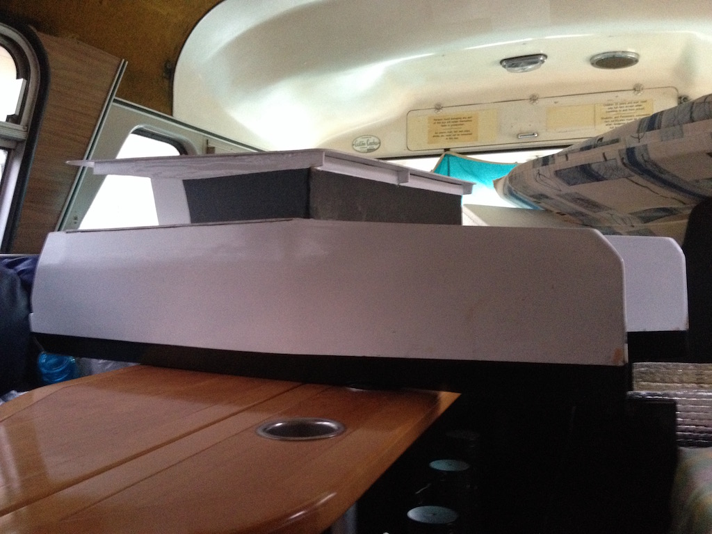

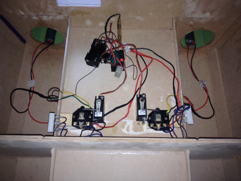

    The hybrid power cat will only really be viable once battery technology improves. There are some good electric motors out there and solar panels are improving all the time and cheap, it's the energy storage issue that needs to improve.
    I built the model so I could experience the process of building a cat to better understand it and to see if I would be able to take on a full size build.
    Now having done that I am designing a smaller cat 24ft ( twin 25hp outboards ) to suit what I would want now, the bigger cat would be better once I have the time to use it when I retire maybe.

    Here are some more pics of the model, Gus7119.

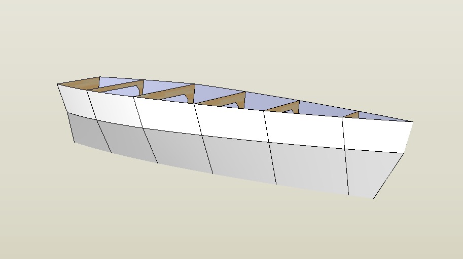

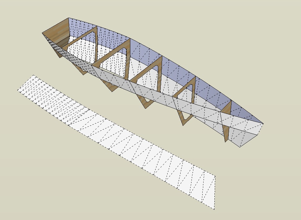

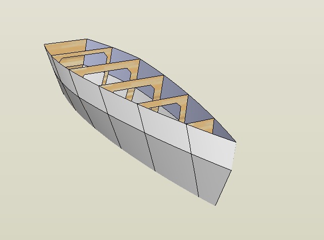

    question for the community
    if the plywood is cut exactly following the dimensions indicated by the computer (all dotted lines in the first image), would the final result look anything like the rendered hull?
    the frames are not carefully placed at this point and the cabin top is still lost in mystery. LOA is 34 feet.

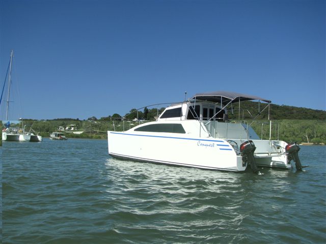

    Build it as a displacement cat, no need for it to plane, you would need a lot more hp for it to plane.
    If you look at my model you will see the hulls have no rocker to them and are the same dimension all the way back to the transom from the main forward bulkhead, very different from a sailing cat.
    Scarf or butt joints are normally used for the plywood sheets
    Here's one set up as a power cat.
  13. silvah
    Joined: Jan 2017
    Posts: 18
    Location: Oconomowoc, WI
    silvah Junior Member
    I think you would get exactly what you rendered, however I think you might find that the flat bottom will cause issues with pounding in your design. I agree with ecojet, build it as a displacement hull, it is a proven design.
    I have another thread going referencing a similar design called a Planecat. If flat bottoms were a great design, it would be in more designs, but they are few and far between. The advantages are that because there are less chines it is easier to build, and there is more interior room.
    Where would you plan to use this cat? Inland waters? Then maybe it would be OK.

    great to know
    yes, the bilge will need some more development -will use some rocker and
    a simple 1 inch ply plate as a mini keel
    takes time to ensure that the 3D curves can be successfully flattened.
