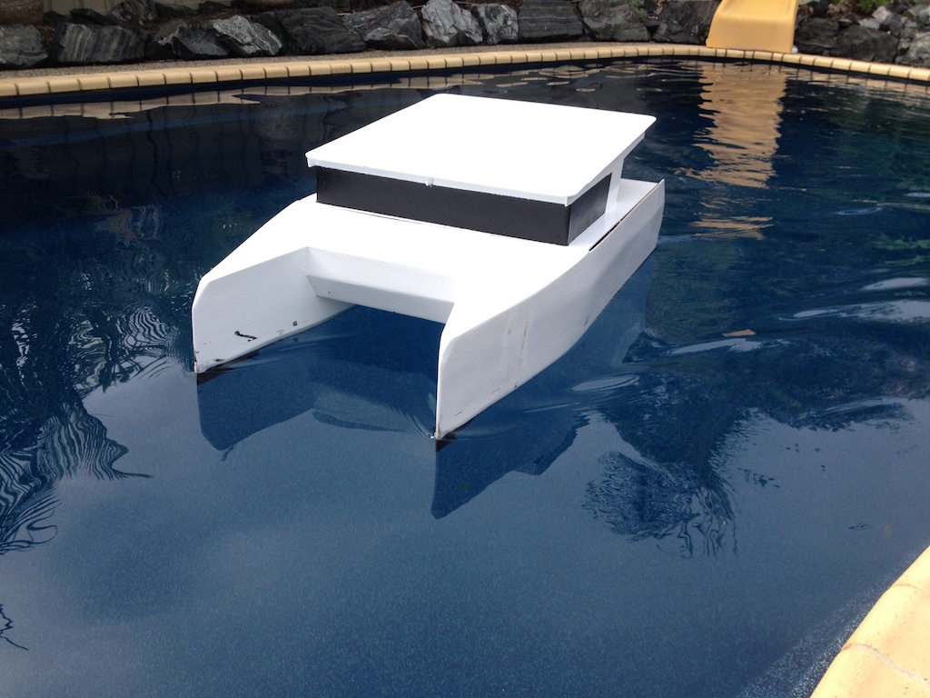

  12. ecojet
    Joined: Jan 2017
    Posts: 33
    Likes: 2, Points: 8, Legacy Rep: 17
    Location: NSW Australia
    ecojet Junior Member
    Hi, first post here.
    After reading this thread and others especially Gropers cat build thread, I decided to try and design a 35ft power cat based on the CSC plans with some modifications. I designed it as a hybrid diesel/electric cat, hence the large cabin roof to hold all the solar panels.
    I built a 1:10th scale model with little jet drives and remote control.
    It goes surprisingly well with the tiny jet drives.
    Here are a couple of picks, it's a little rough but served it's purpose and now I am starting to design a 24ft power cat as a outboard powered weekender coastal cruiser which I may build in the future.
    1 person likes this.
  13. DennisRB
    Joined: Sep 2004
    Posts: 1,270
    Likes: 26, Points: 48, Legacy Rep: 228
    Location: Brisbane
    DennisRB Senior Member
    Nice model :)

  15. ecojet
    Joined: Jan 2017
    Posts: 33
    It ended up being 10.36m length with a 5.2m beam.
    The main bulkheads were widened from 1200 to 1600, 800 to 1200 and 400 to 800 at the bottom, as it's a power cat I made the bottom wider to help reduce squating at the rear.
