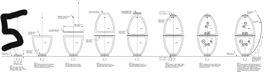

    If not a carbon mast
    Hey all
    I have a few pics below of mast ideas that Ive chosen to investigate if I am forced to make a wooden mast. Pic 1 and two are the same mast and it is the front runners so far. And number 5 is a very close 2nd. Now I hadnt realised that Id been sailing on a boat for abour 5yrs with a 11m mast built as a bet some 10 yrs ago built using the method in diagram 3. And after looking around the box mast still seems to be favoured by some and has proven to last. And number 4 is one that I dont think is for large boats more a dingy spare.
    Im not just posting these fyi I am asking if anyone has any feed back on which of these designs they feel would work best on a 30 to 38 foot cat. Obviously you'll need to use your thinking caps as its only simple lay out sketchs. But mast 1 has the T Support from base to tip of mast. And mast 5 has the support every meter although of course this can be modified for individuals. All masts would obviously need reinforcement at spreaders and jib and so on this is a given.
    Looking for any comments ideas flaws and such. If I can I'll for carbon build but need fall back position if not.
    Cheers
    All masts are wood sa couple glass finish.
  6. catsketcher
    Joined: Mar 2006
    Posts: 1,306
    catsketcher Senior Member
    Just go alloy
    A wooden, composite mast will probably be heavier and more work than an alloy section. If you use a spreaderless rig (three stays a side) then it will take you one weekend to fit out the mast. Spreaders cost lots of money although I made them out of composite for my little cat.
    A cedar mast will require a beautiful table to be built. Grab an alloy section and get sailing

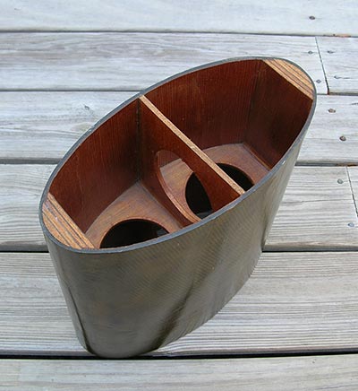

  12. brian eiland
    Joined: Jun 2002
    Posts: 4,962
    brian eiland Senior Member
    Eric was speaking of free standing there as he did many such mast But it would NOT have to be freestanding, and thus could be smaller and less strong in a conventional manner, and would not have to be a wing mast.
    Its the construction technique I was pointing out.
  13. Gus7119
    Joined: Dec 2015
    Posts: 110
    Likes: 1, Points: 0, Legacy Rep: 18
    Location: Sydney
    Gus7119 Senior Member
    Brian read all the articles from Erics site very interesting. But the loss off the two front cabins to masts rule it out. I like your idea of the 3 stayed mast, 2 to the stern 1 to bow. Although the unstated does make sense shame couldn't center mount.
    Wing mast design as standard mast..
    So Brian the below section is very much almost the same as combo of my earlier post on mast design on this page if you combo pic 1 and pic 5. You could therfore use this design for a stayed mast not just for a rotating mast or am I totally wrong? The shape is right and from construction method and comparisons to other builds it should work fine. Again please correct me if wrong?
