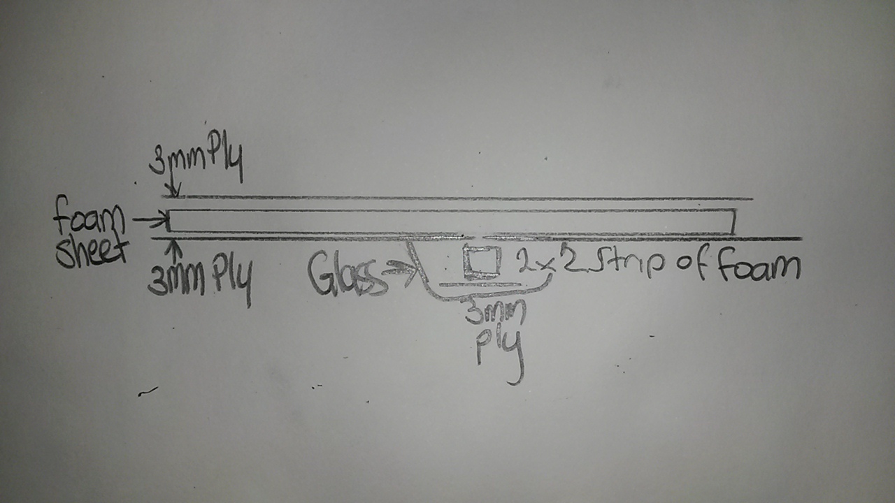

    Now heres a qustion Ive always heard of people sandwiching foam between layers of ply to make cabintops and bridge decks like the bad diagram below. Does anyone have any thoughts on this? I have sailed on a cat many many years ago that was entirely constructed this way hulls and all and it was nice. Apparently very lite and really solid and a mate saw it sailing in Pittwater today so its gota be at least 20 years if not morw old.
    Love your thoughts on use of this idea for coach house and bridgedeck floor.

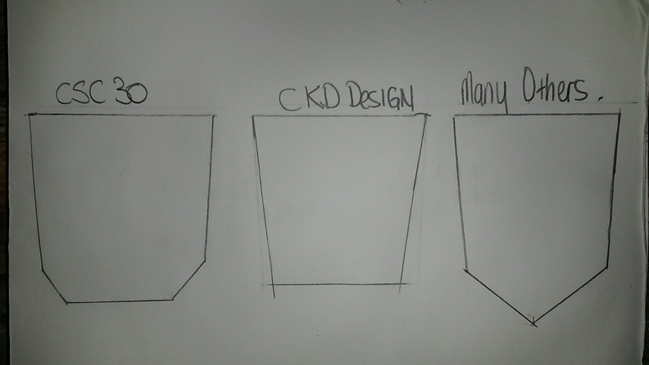

    Now below is a diagram, again a poor one, with three shapes. Lest csc30 is 1 CKD 2 and Others 3. the cs 30 has chimes which combined with keels the idea is to help stop slide. Although that said many cats have been built with none and keels. And then Wharram like bulkheads with triangle base.
    Now obviously 2 would be easiest to build then 3 then 1. But is there a major major difference in performance between the 3 designs when talking a cruising cat not a race cat. Looking for comfort while sailing and while sitting at mooring. (Very crude and obviously not to scale or with angles set)

    When you infuse flat panels on a table you are able to take advantage of the cost savings of bulk buying your resin and you also use it up fairly quickly so shelf life is not an issue.
    Re the ply /foam sandwich I have done quite a bit this way for decks, cabin tops, cockpit soles etc. Sometimes I have used ply on the inside, foam core and glass top skin, I dry fit the panels, mark the bulkheads etc on the under side, then remove it and mask off the gluing surfaces then epoxy seal and pre finish before installing. Again use good quality materials.

    As to hatches - they are easy - make a flat mould out of MDF and pine surrounds. Cove the edges and seal. Coat with wax and you have a mould for hatches. Personally I don't like perspex hatches in the deck as they let too much heat in and are slippery.
    You can put ply on foam. Lightest I have done is 6mm as people's heels have a lot of pressure. One great reason NOT to do it is that you should vacuum bag the thing, or you may get some serious air voids. A large gluing area should a runnier glue mix than say a cove (say runny hiney rather than smooth peanut butter) but still the pressure needed for a large expanse is really only suited for vac bagging. It isn't that hard at all - a compressor venturi will hold the vac after the vacuum cleaner has pulled the air out.
    As to hulls - don't worry. I will say it again because it seems so counter intuitive but the hulls don't matter too much. All of those hulls shown will take about the same time to build. YOU are by far the biggest factor in this.
    I met Peter Snell last holidays - he can build a pair of 40ft Easy hulls in about 4-6 weeks (IIRC). The whole boat takes him about 10 months and it is top quality throughout. I have an acquaintance who has taken about 4 years to make two smaller Easy hulls. Hulls are not what is going to slow you down. Hulls are fun to build but they are about 20% of the build. Saving 5-10% on 20% is not worth it. So get the right design, not the easiest to whip up as a set of hulls.

    Talking hull shapes. The multichine shape like the CSC30 is a good approximation of the ideal low wetted surface area shape which is a semi circle. Also it may allow you to walk on the bottom so you don't need floor boards. I think the whole setup needs to be taken into consideration. If your chosen shape requires floor boards, the hulls sides will need to be higher, that will mean more weight and windange, so in the end the hull resistance may be higher even if the underwater shape is better in theory.
    The numbers respond to wetted surface area.

    Catsketcher Ive become a little pig headed regarding plans and am going to go with the outline of ths csc30 except add an extra 2400mm sheet to the hulls instead of 4 sheets she'll be 5 giving me extra length for stern stsps and full coach house instead of cuddy. Using info from previous builds and tweaks from other designs. I will have full plans drawn up before I start so az not to be left sctratch my head half way through. But thanks for the concern Ivs explainded my reasoning in previous posts.
    And if he likes it or not as I dont think it was his intention Groper has given me a huge boost to back myself with his own design build. And reading where people have gone wrong has given me ideas of what to and not to do. But dead keen on anything you feel you can build yourself to help save some cash
    .DennisRB it seems that the multi and single chime are a good compromise. As the CKD is not in your diagram list I take it its not so crash hot? I have seen a number of hulls built this way with total flat bottom but no experiance of how they sail although the CKD would give you no requirement for floor boards. Although I am leaning towards the multi chi.e but if I am told the CDK waz az good Id change to it in a heart beat. But I must say it dods seem that there are alot of boats with this design.
    Now az for foam core ply. Cool it seems most agree its a good lite product for bridge deck and cabin with the bonus of insallation for sound anx heat. Please chime in if you have bad experiance or know of bad exper5with this idea. This is the one thing I will vacuum bag as the large area to try and weight down and get a good bond would be near impossible.
    Now I have heard in the past that epoxy eithed doesnt bond to foam or eats if if applied directly to it. And that a way around this is to cover the foam in a layer of wood glue and let that set prior to using epoxy on it. Is this true or not.

    Gday. I don't think the CDK shape was omitted because its not crash hot. I guess they just forgot or couldn't put everything in. But there is enough info there on similar shapes. It appears almost square, but the shape is also kind of like the multichine but without the bottom corners missing. So I would guess the wetted surface area will be between the box and the multi chine. Maybe about 108% of the the semi circle. But there are also other factors here other than WSA.

    20+ years ago we produced balsa cored, ply faced panels using epoxied 1.5mm ply under vacuum, 20 sheets at a time; and individually in a heated press using phenolic. They were both pretty good for their time, but heavier than glass faces for the same stiffness and the ply needed the usual 3 coats of epoxy applied by roller to stop it rotting. The demand for them now is near zero.
    The ply was more expensive than glass, the sheets needed joining to make long panels and as with all 8 x 4 sheets for small jobs, there was a lot of wastage and a lot of edge routing, bogging and rounding or glued on edges required. Table infused glass faced panels are better in all these respects.
    Unless you have fat ladies wearing stillettos walking over your boat, a layer of 600 db over 80 kg foam will be plenty strong enough.
    If you vacuum your own ply faced panels, resin coat the foam and apply the glue to the ply as the vacuum will not suck the air from the foam surface. Ensure there is a way for the air to get out. If the edges are pressed down first, there will be a 6' x 3' air bubble in your panel.

    Re hull shapes: Harryproas have flat bottoms with large, variable radius chines and gunwhales. Flat bottom saves the lousy job of building floors and means less freeboard to get headroom. They look better and have less wetted surface and windage than a ply box and are far less work than a double chine. If the boat is kept light enough, they plane.
