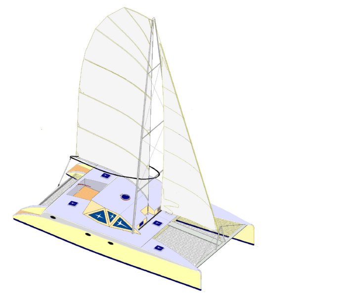

    Cheers mate. So 280 and you didnt habe to do anything except construct. Interesting it is alot more. There are cats from the 70s out of ply still 'plying' the oceans.
    As for materials other than hull. Here in Sydney like most states in Australia only about 60% of boats on moorings are used the rest sit till waterways takes them they sink or someone goes well Ive seen that boat sit there for 15yrs with not on visitor and take it. I already have my eyes on a few 30 to 35 foot monos whos rigging I know is in great shape that I can pick up for under 1000 so most deck gear will come second hand.
    Now the resale value. Not to gain sympathy or get points but as an explanation as to my thinking. I have spent the past 20yrs lookong after my family a kid with a chromosomal disorder and a wife with breast cancer that came back twice after initial diagnosis. So have spent most of this time in hospitals. So have spent every last sent on secondary care for them both. Therefore I dont have 3k to buy plans and while I'll build it properly need to save where I can. I have built one of these modified with a boat builder who died and its been in Asia for the past 5 or so years done a circumnavigation already.
    Hence why I am going with this build. And have no plans for selling the kids can deal with that or give me a viking funeral on the thing when I die. I have the skills and have been doing repairs and builds since my teens on boats from Manly juniors to 55ft stink boats so an happy to back myself.
    This forum has been a great resource and hence why if anyone has ideas mods or helpful hints Im open to then just wanted to clarify that it was going to be in ply and we go from there. Theres even a great guy who's built a model done some cad work and is working on cnc files.
    So I hope buy the end we can have a plan for a great sea going boat that we can say hey heres a free plan thats been built and tested and you may like to look at it. Or just for my build if not. But I can say that the very basic plan on coastal passages site thanks again Bob, does give enough info to get you going is you know some basics. But of course Id use an Australian designers plan if I could afford to but thats not an option. Just wish I had the plans we drew up for the one we built as the guy made them common licence after they were finished but I dont know the owner and the boat builders dead so dam.
    On last thing anyone got any experiance with the A frame mast it makes sense to me using a ferler on maim with a wishbone boom
    Hey thanks all for all this great input and discussion who would have thunk it a!
    Cheers gus

  8. rob denney
    Joined: Feb 2005
    Posts: 781
    rob denney Senior Member
    Gropers boat is 35' vs your 30'. His is designed for thick panels, yours for thin (more stringers, frames etc), his was built in a confined space so he could not build full length panels. Compared with what we know now vs then, he could have saved himself a lot of time and effort. An example is the infused 60' harryproa hull requiring no wet laminating, and no grinding or cutting cured laminate.
    To set the record straight, base costs for the 6mm ply vs 6mm foam/glass are:
    Infusion vinylester $7.50 per kg, polyester half as much, WEST twice as much.
    If the ply boat is coated with the WEST recommended 3 coats inside, it will use about 400 grammes per sq m inside and the same on the outside for a layer of 200 gsm cloth.
    The infused boat will use about the same to wet out a layer of 400 double bias inside and out.
    Some infusion resin will be in the plumbing, some WEST will be on the rollers, brushes, floor and applicator. How much depends on the operator and the set up.
    6mm ply marine gaboon ply costs $51.50 per sq m. 6mm foam (or balsa) $30/sqm.
    Infusion needs a pump ($150) and a table. Ply needs all the woodworking tools you already have.
    So, the extra glass on the infused boat is offset by the higher cost of the epoxy on the ply. The ply is more expensive than the foam. Tools and consumables favour ply. The cost overalll will be pretty similar.
    The ply boat builder will/should spend almost the entire build wearing gloves, suit and respirator, and a lot of time doing hard labour. The infuser will take less time, and almost none of it will involve dust or wet resin.
    Groper is right about the cost of building in Aus. However, if you design and build smart, it is possible to save a lot of money. For example, Bucket List (http://harryproa.com/?portfolio=bucket-list) is a 40' racer, with little accommodation but a very big rig. It costs $US50,000/$71,000, professionally built, in Aus, ready to race. A similar speed and space cat or tri would be a lot more. Similar savings apply to cruising versions.
    Re wishbone mast rigs. I have never used one, but they are obviously more windage and small section poles in compression need to be kept in column and/or be heavy and/or large diameter. Weight aloft increases pitching and reduces the point of no return in a capsize. Hoist a person half way up the mast on a choppy day to see the effect on pitching.
    Furling mains (and headsails) are fine when they work, but they only have to not do so once in a squall at 2 am with the sail part furled to really screw your trip.
    By far the easiest rig to use on a cruising boat is an unstayed mast, ideally in carbon (also much cheaper than you think), but in timber if you don't mind the extra weight, work and cost.
    Re honeycomb: There are 5 types. Alloy (should not be on boats due to electrolysis potential), nomex (light and waterproof, but expensive), phenolic impregnated paper (Tricell, sold by ATL as raw material of in panels, not waterproof), the paper stuff they use in household doors which you can impregnate with epoxy (waterproof but pretty heavy and messy to make) and Polycore, which is plastic with a scrim to glass to. Excellent product.

  13. Gus7119
    Joined: Dec 2015
    Posts: 110
    Likes: 1, Points: 0, Legacy Rep: 18
    Location: Sydney
    Gus7119 Senior Member
    Gee This has been so much better than I thought it woukd I have so many shout outs;
    groper mate love that boat looks great and an own design fantastic Im going to go look for you build. And cheers for everything else. As I cant read your post as I do reply if there arent links to your stuff could u post them I'd love to have a gander. Also its not a matter of not wanting to buy a boat. Its just cant afford it and can get large chunks of hardware monthly or weekly. Then you say you should save. Yep to right. But each time I ve done that it goes one someone or another medical costs this way I cqn chip away. I hope your here for the whole trial and tribulation and that we cqn raft up some time. And then Ill secretly put a mast and sail on your boat so your no longer a stink boater.
    isladelobos again your kicking goals and doing great things your supporthas been fantastic.
    rob denney thanks a heap for that brwak down it really was insightful. Qustion though viynl and poly shouldnt be used on the glassing of the hul right or wrong as it doesnt flex? But can be used internal. And westsystek is just a brand now isnt it? I know they created infussion ply but wouldnt use their products as far more expensive, yes or no?
    CT249 for talking sea sickness. Yep agree its subjective. Ill have to leave the wife in Australia and hope shes here on rwturn if she cant handle a cat its a last chance thing as she wont go near a mono after a few fun times I had her out in.
    Steve W cheers for info and understanding my reasoning. Id just buy one if I could but unfortunately that wont happen. And I to reckon a well built ply boat should go for as much but its seen a inferior which is a shame. Because I reckon if it was given more of a chance people would see they can be great boats. And yes unfortunately if I could but bulk itd be cheaper but I can't and am resigned to the fact. But happy!
    Really thanks and keep any secrets cheap prices ot more r ideas coming. I am starting the bulk heads the first day of Feb. So itll be my soil turning day.
    All the best
    Gus
