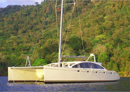

  10. brian eiland
    Joined: Jun 2002
    Posts: 4,962
    brian eiland Senior Member
    Dudley Dix 55
    Good advice there.
    I might also suggest you give this design some serious thoughts...
    Dudley Dix 55
    ...and have a look thru the build photos
    http://www.dixdesign.com/dh550%20build.htm
    You are on the right path to make the vessel a wee bit longer than you might fill up with accommodations,....leave those bows empty, and a portion of the sterns as well if you can.

  12. DennisRB
    Joined: Sep 2004
    Posts: 1,270
    Likes: 26, Points: 48, Legacy Rep: 228
    Location: Brisbane
    DennisRB Senior Member
    That Dix boat is huge. Over twice weight, 3 times the space and with 2 x 50hp engines. I don't think its anything like what the op had in mind. Nice boat though.
