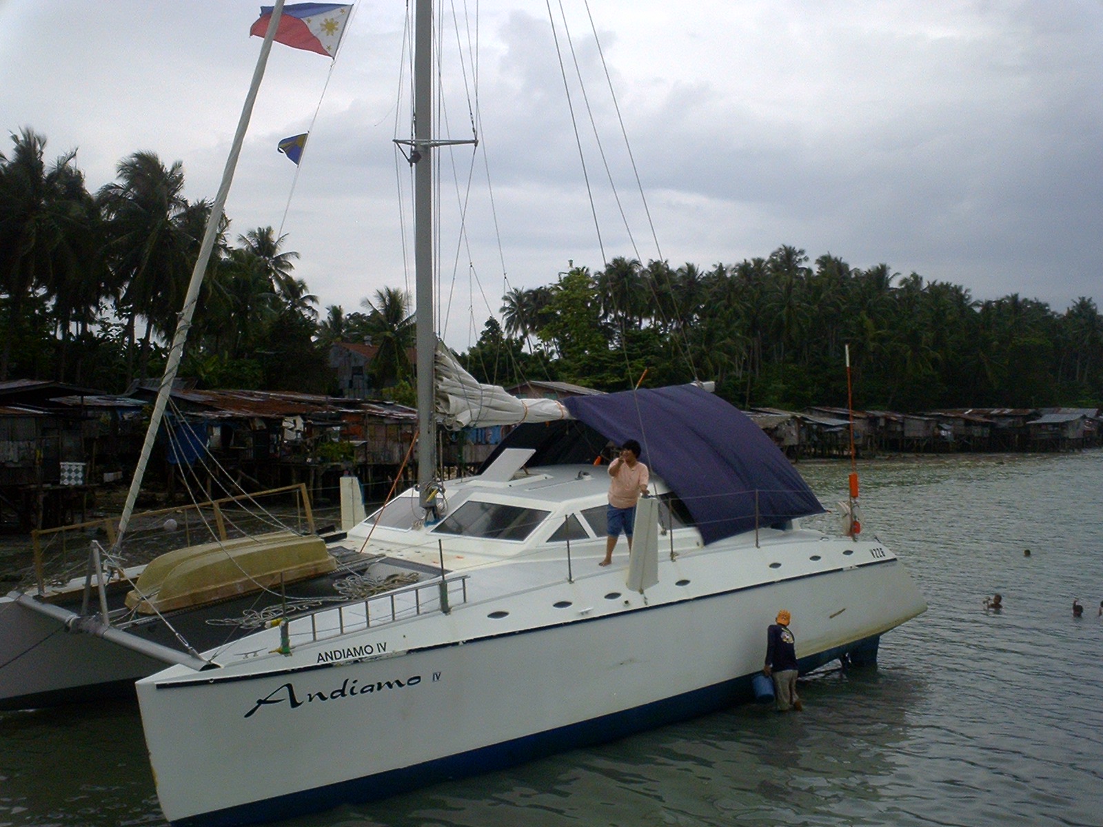

  12. Ozjon
    Joined: Feb 2016
    Posts: 2
    Location: Melbourne
    Ozjon New Member
    Here are a couple of photos of my boat (beached for a water-line cleaning) at Mindanao, Philippines.
    The wooden gang-plank was a temporary item, only carried while cruising the Philippines.
    Enjoy!
