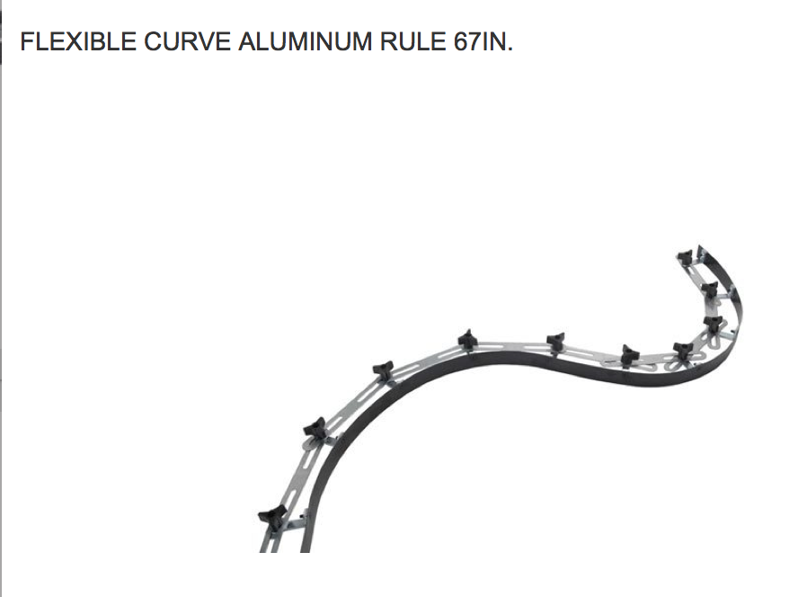

    Right, I've seen smaller with wire pins for taking curves off smaller objects.

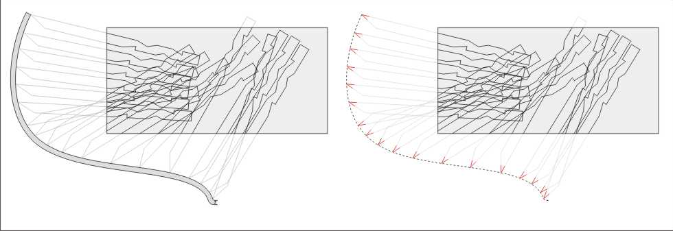

    The joggle stick method uses virtually no measurements, just drawing around the stick a bunch of times and transferring to the bulkhead material and connecting the marks with a fairing batten, very fast and elegant. Its a very easy method that works great, its the method I used for many years before the advent of hot melt glue guns and is still the method I would use if I were installing bulkheads in a bare hull that I didn't build so didn't have the loftings (otherwise I would pick the shape off the loft floor)

    The joggle stick was developed because most boatbuilders until relitivly recently couldn't read. The joggle stick doesn't require anything other then a pencil and the stick. Attached is a joggle stick drawing I provide with all my plans and it's self explanatory.

    I found this picture of the joggle stick method, you mark the pattern board with each location of the stick. simple, could be faster with several sticks and clamps.

    Google is amazing isn't it. If you look closely, you'll note that's a slightly different version the drawing I've attached above. It's been cut an pasted for years on various sights, so I'm not sure which one you got it from, but it's mine and it's good to see it used.

    Thanks all for excellent info on joggle sticks and related techniques. Much appreciated.
    I just ordered one of these - the device Gonzo identified - it should be interesting to test out.
