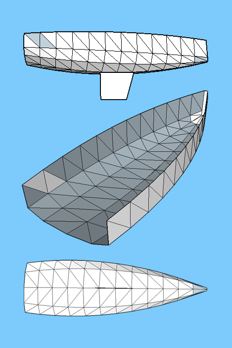

    Here is the hull design i came with so far, the keel is only cosmetic as of now. I need serious information or any other help regarding the keel design, thickness and material and in relation with the mast and sails and how the boat is heeling in the wind. To make an overview, this is a sailing boat ply/fiberglass 6.5 meters long and 2 meters wide on its peak point. Also suggestions for the mast, im thinking 3mm thick aluminum with diameter of abut 10cm, 9 meters tall above the deck so 8 meters will be surface for the sail and 3 meters boom maybe?! The mast bar only, i believe it will weight about 25 kg. This is a small boat for a long offshore adventure.
    @David Cooper thank you so much for all the info, i considering everything you said. About the outriggers and how im thinking of everything let me explain. I want a keel that i can lift, the keel will fill it with lead on the bottom and water on top, the keel will be screw it on the hull, if i want to lift the keel, im thinking that might i can pump the leads and water in another tank in the hull, keel will be then light to be lifted up and screw it in another "step" while the top part of the keel count also be unscrewed and removed as it will be aluminum or steel bars with foam and so it want be a problem for the mast and boom too. The keel will have no contact with the inside of the boat it will enters from the top of the hull and will goes down to the water. Once the keel is lifted up, then the outriggers can be deployed and screw them with some system further out (manually). Outriggers could be used also as an alternative mast just in case the mast been destroyed. This is the concept im thinking of, yet im really thinking all this in the relation with the mast as you mentioned in your previous comment. The mast could go down to the bed of the hull. I will place 3 steel or aluminum rings in the area at sides of keel and mast. so if mast or keel moves, then the whole rings moves which will be attached to the hull as frames (so i call it rings), i believe in that way it will be less stress to the ply/fiberglass hull. Definitely i don't say that what im thinking is right, or i believe it is right, but it is the concept and what im looking into.

    That looks viable, so long as the transom doesn't go too deep - I don't know the rules for that, but I'd have thought it shouldn't go further down than the waterline.
    Why do you want to lift the keel? It does no harm to leave it down unless you want to park the boat in shallow water, and any mechanism for raising and lowering it will add a lot of weight and make it more likely for the keel to break off in a storm. You'll also need lateral resistance, so raising the keel will lead to you needing to deploy another foil of roughly the same size and shape while the heavy keel is needlessly stored higher up. Just keep the keel down all the time. The only reasons I can think of for being able to adjust keel height are for taking the boat into shallow water, for easier transportation behind a car on a trailer, or for lowering the keel to a much greater depth than normal to amplify the righting force if you've capsized - this last reason would fit with a multihull idea where you have a relatively light keel which is just heavy enough to right the boat if it is extended to give its weight more leverage while an outrigger is retracted, although your hull is so wide that I can't see how you're going to be able to retract an outrigger far enough for that to work. You've designed a monohull which doesn't look well suited to work with outriggers.
    As for the mast, you won't regret making it more robust rather than lighter, and you can either step it on the deck or run it right down to the bottom of the hull. Either way, you need to put reinforcement into the deck and hull to spread the load across a wider area, perhaps by having a bulkhead there with a doorway. Look at what other boats do and make sure yours has at least as much structure in the same places. Your priority for now though is to work out what you're doing with the outriggers, because they still don't make sense.

    How are you going to "pump lead"?

    @David Cooper Yes i want a lifting keel so i can go in shallow waters. Im going to design the "lifting" keel system and will re-think the idea, a fixed keel is much better as i have read online. However all the keels are attached only down bellow the hull with some bigger screws. Im only thinking that i can do the same but with a system that will be attached somewhere that i can take the screws out and re positioning the keel higher. The lifting keel wont be an option on the go, but it will take some screw unscrew work, raising the keel higher and feel it again with leads and water. Indeed will need much more weight for the surrounded walls and frames. I will design it first. But hopefully i can search more also technical details, for shapes, size etc. Regarding the outriggers, as far as im looking at it, outriggers seems more and more useless practically. The waterline is not in the straight line as it looks line. The point in the bow, the corner and the last point in the middle of the transom are on the same height and then they form a symmetrical curve down the hull, in the exact middle is the keel. I could add another section at the back which from that point will be out of the water. The curve straight bellow from that to points bends at 40cm depth while the section above that it is 75cm at the back and 80cm at front.
    @JamesG123 im thinking of this kind of leads: Spherical form or little pieces or powder, i think it could be pumped out but yet not sure :-D
