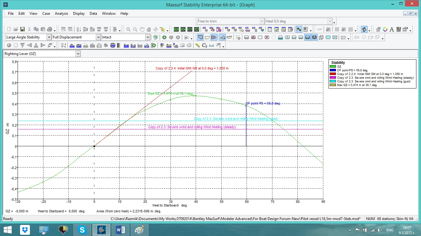

    But it is possible to test easily all if to make analogous calculation on Maxsurf Stability /look at files in this publication / .
    It is visible that K = Area1/Area2 =276,36 % = 2,76> 1
    8. Angle "teta1" must be greater than 20 ⁰??
    From the published files, made with program Maxsurf Stability is visible that agrees IMO MSC.267/85/Ch2:
    IMO roll back angle ϕ1 = 14,8 ⁰
    In the Delftship Pro outcome is too most:
    | ϕ1 | = |7,1 ⁰| + |-7,6 ⁰| = 14,7 ⁰

    Calculation on stability criteria on Maxsurf Stability it is possible to see in the added file.

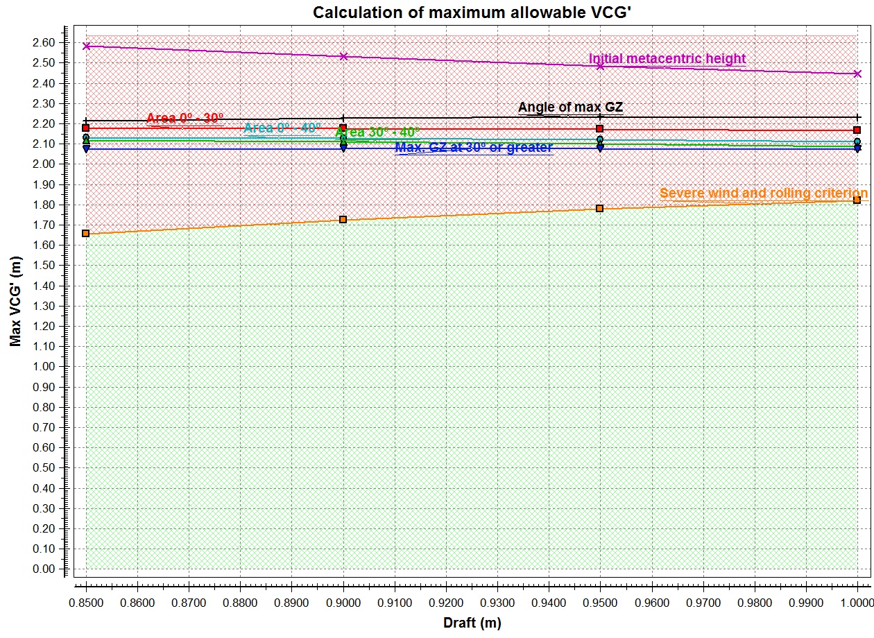

    I have made one more check:
    I has tested at so chosen stability criteria how much can to be the maximum allowable value VCG for full displacement.
    It has appeared that at VCGmax=1,75m the ship will not meet the requirements any more criterion of weather.
    If instead of VCG=1,4m to accept VCG=1,6m <1,75m then K=1,73 > 1 by Maxsurf Stability at roll back angle 15,7deg and at GMt=1,058m. But GMt must be to correct for effect of free surfaces of a liquid load on an intact stability. Must do not forget it!
