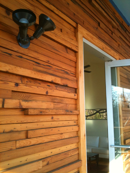

    I have seen massive grain bins built that way, random length 2x6 or 2x8 boards stacked and nailed all to hell. Here is a house of short 2x4 offcuts stacked and nailed...
    That might be another way to use those mountains of pallet wood boards, stack them up and every 4 or 5 layers drive through some nails and make yourself a house. An air nailer would be best. Use the saved money to buy a boat.
