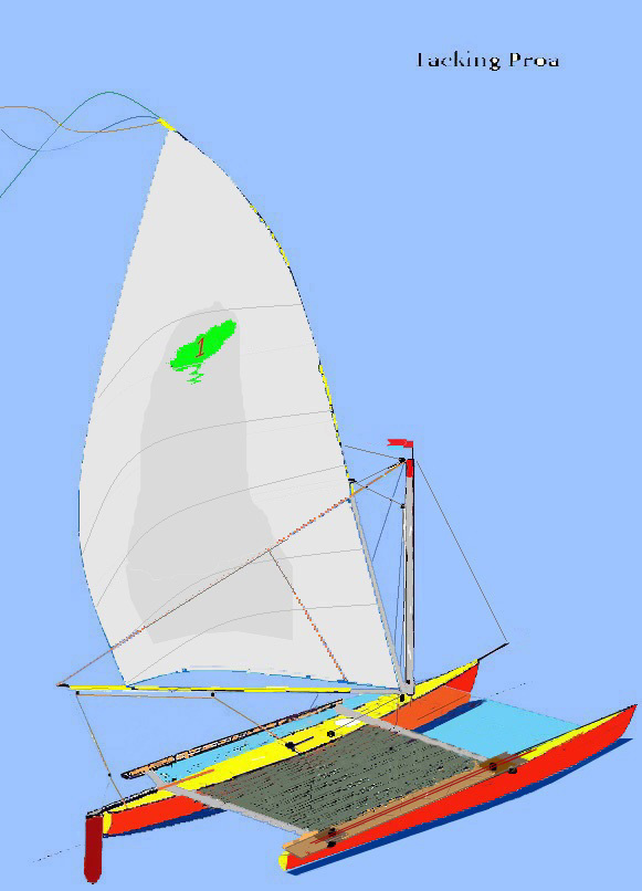

    THE NEW RIG http://www.flyinglateen.com/the-new-rig.html
    Note the lower spar. Boom or yard?
    More of an Oceanic Lateen.
    They could simplify it more by tacking down the tack to the bow and get rid of the fore leg. Probably get better air flow too. Although, those split leg masts look like they would interrupt air flow plenty.
    Have we settled on a definition for crab claw yet?

    Gaff or lateen?
    One, the lateen has spars that cross the stubby on one tack or the other, save the one shown above, gaff spars do not, which is the MO rig - and then there is the one above, a lateen, to me.
  5. sharpii2
    Joined: May 2004
    Posts: 2,043
    Likes: 204, Points: 63, Legacy Rep: 611
    Location: Michigan, USA
    sharpii2 Senior Member
    I would call it a lateen as well.
    This is because the yard extends all the way down to the foot of the sail.
    If it extended mostly to the foot of the sail, I would call it a setee.
    But if it extended halfway down or less, I would have to call it a gaff.

    Perhaps he confused greater maximum lift with greater lift/drag efficiency. The two are different.
    Greater lift comes with the plane deploying maximum flaps. But it's engines had better be near full throttle.
    Once it reaches its assigned altitude, the plane retracts the flaps, and then the higher lift/drag efficiency comes in.
    Less lift, so the plane has to fly faster. But even far less drag, so the plane can reach its destination with the amount of fuel it has.
    Since racing requires a lot of upwind sailing, lift/drag efficiency is of primary importance. So the trianguloid Bermuda rig, with its AR relatively high, and it's CE relatively low, shines in this department.
    The crab claw has its CE relatively high, when it is peaked up, but relatively low when it is peaked down. And, as far as I know, there are no reef points.
    It appears that the masts on most of these can be canted fore and aft. At least on one of them, an Indonesian one, the sail is peaked up when sailing down wind. And peaked down when sailing upwind. As the mast is forward on this canoe (a double outrigger) this makes sense. When peaked up, the CE of the sail moves forward, which provides relatively good down wind sailing manners. By peaking the sail down, the CE of its trianguloid shape moves aft, providing good upwind manners.
    Also, on a narrow hull multi hull, speed is no longer limited by the boat's wave length, like with a more traditional monohull. Maybe this is the reason reefing never seems to have been a thing with these rigs. When the wind blows harder, the boat simply goes faster. At least to a point.
    It seems that if the size of the rig is kept within reason (a relatively low S/D ratio), this could work quite well.
    One canoe I read about carried two such rigs. One was trianguloid and the other was rectanguloid. One was stored on the cross-beams while the other was in use. I guess that was one form of reefing.
    I suppose that this rig type, permanently peaked up on a stationary mast, might be of use if the sail area was going to be quite limited, and the sail was of secondary concern. The high CE of this "V" shape would catch more wind than a Bermuda rig's inverted "V" shape would.
    Also, the boom would be well out of the way.
    I have seen a "V" shaped sail used on an expedition kayak, but it seemed designed for only down wind work.

    With some embarrassment, I found out that the canoe I mentioned was Balinese, not Indonesian.
    Also, the larger or smaller sail was stored on boom crutches, not on the cross-beams.
    While further reading, I learned that the rig peaked upward automatically.
    The way this works is that only the yard is connected to the mast, and it has a sheet line of its own.
    The front end of the yard is either tethered or stuffed into the open bow, so it can move only fore or aft.
    The front end of the boom is either directly connected to the front end of the yard, or is indirectly connected to it by the open luff of the rectanguloid sail.
    When sailing upwind, the yard sheet is held firm, so only the boom can move. It is always kept to the Lee of the mast, so it can swing out freely. This is the sole way of getting a sheeting angle when sailing up wind.
    When it's time to sail off wind, the yard sheet is eased, so the aft end of the yard can swing to leeward. But the front end cannot, because it is trapped in the open bow, or is limited by a tether. But it can move fore and aft. And so it moves aft. This peaks the aft end of the yard higher, and moves the CE of the sail forward, where one might want it for downwind sailing.
    Changing tacks requires sailing dead down wind, then letting the yard and boom pivot around the front of the mast. The two sheet lines are then used to haul them aft after that. Now the canoe can turn upwind on its new tack.
    As for reefing, the boom is simply allowed to sing further down wind than the yard, causing it to act as much as a kite as it does as a sail.
    Not bad for stone-age technology.
    PS. The sails were proportionately larger than I said in my previous post. About 15 sm for about 600 kg of canoe.
