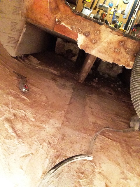

    I got in a little time on Sunday with #4Monkey, we donned our masks and goggles and cleaned out that rotted wood on the keel. Amazing how wet that wood still was. I had the shop vac running in there while I ground it out.. but it's still pretty messy and I should probably have cleaned house before taking a picture for you guys, but I was out of time and this is how it is and how it goes.
    This is primarily what I used to grind that down, and it worked ok, the other grinding disc I had was much slower going than this thing. I should see if they have a bigger one for my large grinder, although I'm not sure I want to wield the big grinder in that awkward position..
    http://www.harborfreight.com/4-12-in-60-grit-flap-disc-69602.html
    What did you guys use to grind and clean-up that surface.. next step is probably the underside of the mast step...

    Nice work on that keel strip. So it was all wet?

    I used a flap disk too. also a cutting disk. That flap disk will be useful because some paint will need to be removed in the areas where the new epoxy goes.

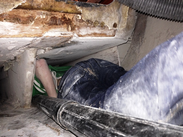

    I wanted to clean up the underside of the cockpit sole below the mast step yesterday. Well, I ended up pulling off that big chunk of crud that had once upon a time held the compression post in place... with it, came a bit of end grain that looked like it was a 1/4 of an inch end of a 2x6 followed by a bit of wet plywood. I'll try to get some decent pictures of that piece tonight. None of the pictures I took last night came out very good. So I'll try to get better ones, we also managed to get a good bit more foam out... It's going to have to all come out, because it's all wet, and every foot we dig back we find more nesting... I can also see where the port side stringer has some wood rot.. Not sure I can do anything about that unless I end up separating the deck from the hull.. :eek:
    Will report more and provide pic's when I can.

    Number 4 and I tried again last night to get the rest of that foam out.. we've gotten just aft of the CB trunk. Unfortunately, we can't get a grip on anything to pull it out because it's so far in there. We've taken to breaking it into pieces as we can and vacuuming it out, but it's slow going, the wet foam and nesting(wet fur ew!) and some other muck, clogs up the hose on the shop vac... Some tools we've tried to help with breaking up the foam.. a long bamboo stick, a garden hoe, a survival knife duct taped to the end of the bamboo pole, a flat head shovel, and just the end of the shop vac tube. I may have forgotten some of the stuff, but we are open to ideas. I think we need some kind of Bat-Tool that would go in like an arrow and then expand out perpendicular to the shaft through the foam..so we can than pull it out in one large chunk. Batman has yet to answer my calls about loaning his out though.
