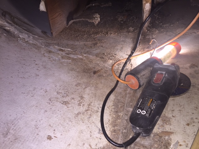

    Started to rip out the bulk head and clean up under the mast step

    oh no I'm falling behind! Looks good Beady, welcome!

    Thanks 5monkeys. I am not going to build up the post as nice as some that I have seen here. Now I am just waiting for it to warm up so I can put some fiberglass on the brace. My goal is to have the boat ready by late April so I can race at the state park on Sunday afternoon. There is a sailing association there and they have fun races, not much of a race just an excuse to get together and sail.

    Beady, the post Canracer built is like a work of art, I'm sure mine will end up looking much more...utilitarian...yeah, we'll go with that.
    It looks like it's cleaning up pretty well in there, what did you use on your grinder to clean that out? I've got to to take out that rotted wood along the keel still. Maybe I can put some time in over the weekend.
