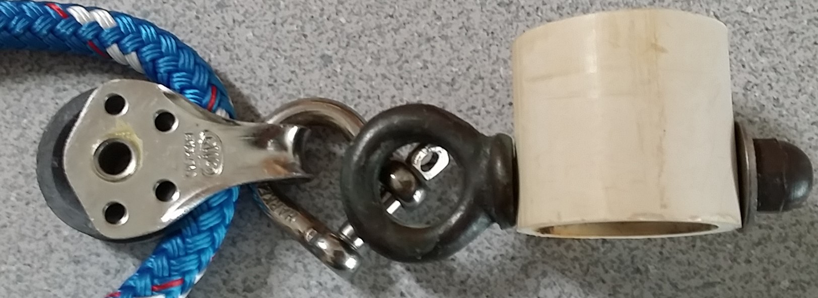

    My traveler hardware is packed in a zip-lock bags and stashed away in a boxes. I think I saw it the other day. Ok, the box was above the refrigerator. I guess it's time to unpack this stuff and put the boat back together.
    The traveler bar (that heavy steel tube) is kept in place by two of these plastic collars (shown.) The collars and bar are bolted together with bronze bolts (shown.) The bolts have an eye (positioned at the underside of the bar when rigged,) and the shackle connects to the eye. The block connects to the shackle. This allows the control line to run parallel to the bar and then straight up to the cam cleat.

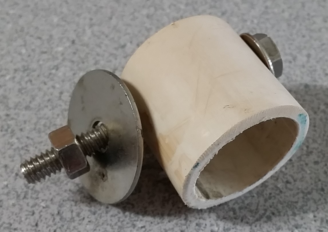

    One of the original bronze bolts broke and it was easy enough to replace it with a regular stainless steel bolt and some washers.

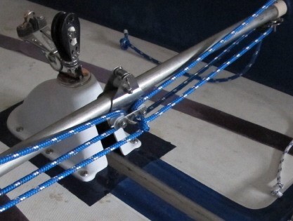

    I dug up an image of my set-up. The line is tied in the middle, led out to the block, back to the car and up at an angle to the cam cleat. Same set up as yours.

    Yeah, I can't be certain from the picture of your cockpit but it looks like you might be rigging up your traveler lines differently. Do you have two control lines?
    Mine is one continuous line and it uses those small blocks at the ends of the bar.
