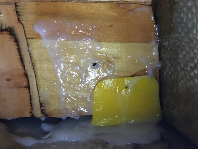

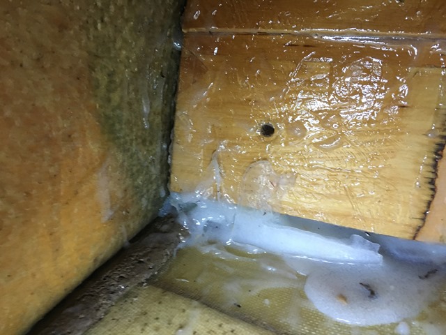

    ok, I'm swallowing what little pride I have and posting some pictures. First off, here is how she looks from the outside at the moment. I think if I spread on some thickened epoxy with a notched spreader, I'll be able to reapply the skin until some squeeze out.. and it should come out as good as to be expected.
    Next for the insides, this is where I'm open to suggestions. As I've described.. the center third of the transom I set into a thick bed of epoxy, it worked well in the center because the cockpit was there to allow it to puddle and fill up. but the outer edges that didn't/couldn't happen. I then tried to back fill the gap with thickened epoxy, but it still wanted to run out, you can see where I actually left the spreader in place on the one side hoping to hold some epoxy back but the pics show I need to add a good deal more. I'll probably try to cut that spreader back out. I wish I had some of that concrete stuff used in original construction. :)
    starboard
    Port
    I'm open to suggestions at this point. What would you all do to fill this in and re-enforce the transom from the inside?

    I think I already know the answer... I need to mix my epoxy thicker... and then thicker still... I might also lower the stern a bit more to get gravity to help as much as it can, I might also try a pastry bag for the application. Anybody ever use dollar store pastry bags?

    Yeah, I was thinking that last night when I first saw your post and I'm thinking the same thing today. Mix it thicker (very easy to do.) It might have to be in smaller batches because it will get hot. You should have a good idea about batch size and the working time.

    I took a few minutes Friday night and mixed up a batch of PB.. nice and thick with silica and sawdust. It worked great to fill in those joints. It seems to have hardened nicely, but it sure is ugly, which is fine. I don't think I need her upside down anymore. and I think she's structurally sound enough to flip. I want to do a bit more re-enforcement inside, but I think it's time to put her back on her trailer. I need to be able to move her around.. winter car troubles mean it's time to share the garage. My pictures didn't come out very good, so I'll have to try again. Just beware, it's ugly in there.

    I've said it a few times in my own project posts; "space is very limited and perfect looking epoxy work is not possible."

    I'm mostly embarrassed that I left that yellow spreader in there.. I could have realized trying to leave it in place as a dam.. was a fools errand, and once determined it hadn't worked.. I should have made the effort to cut it out. I didn't though.

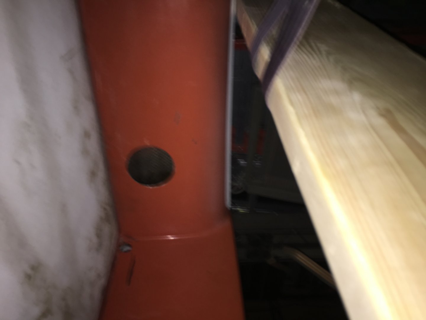

    2nd... there was a gap between the transom and the rear cockpit wall. In my case it was bigger on the starboard side (about 1/4") than to port (I dunno 1/8"). I think there are a few reasons for the variance but I'm not going into that now. I wanted to fill in the gap where the cockpit drain fits in, not the whole surface between the cockpit wall and the transom as that would be too much so just around the tube as much as I could maybe a 1/4" to 3/4" diameter around the hole. I mainly wanted this so that if water got in behind my brass fittings it wouldn't run into the bilge, but also to provide some structure as I press those brass fittings in place... I cut some 1/4" foam that I had laying around from some insulation project.. and inserted it between the drain and the transom..I wanted this to serve as a dam or shelf to keep the "peanut butter" from falling away from the hole inside. I ended up mixing the epoxy/sawdust/silica combo so thick it was probably not necessary. Using my gloved hands, I packed into that gap as much goop as it seemed willing to take and to complete the "tunnel" as much as I could. I did the same on the port side as well, although as stated that gap was smaller..so I didn't bother to create a "shelf".
    I'm sure I'll have to re-drill these "tunnels" before I can insert and crimp the brass sleeve but I think this will be good and solid. I'll attach some pic's but be warned.. apparently I can't take a clear picture ;-)
    ok, so you can't see much in the pics of the cockpit drain.. sorry.. I tried.
