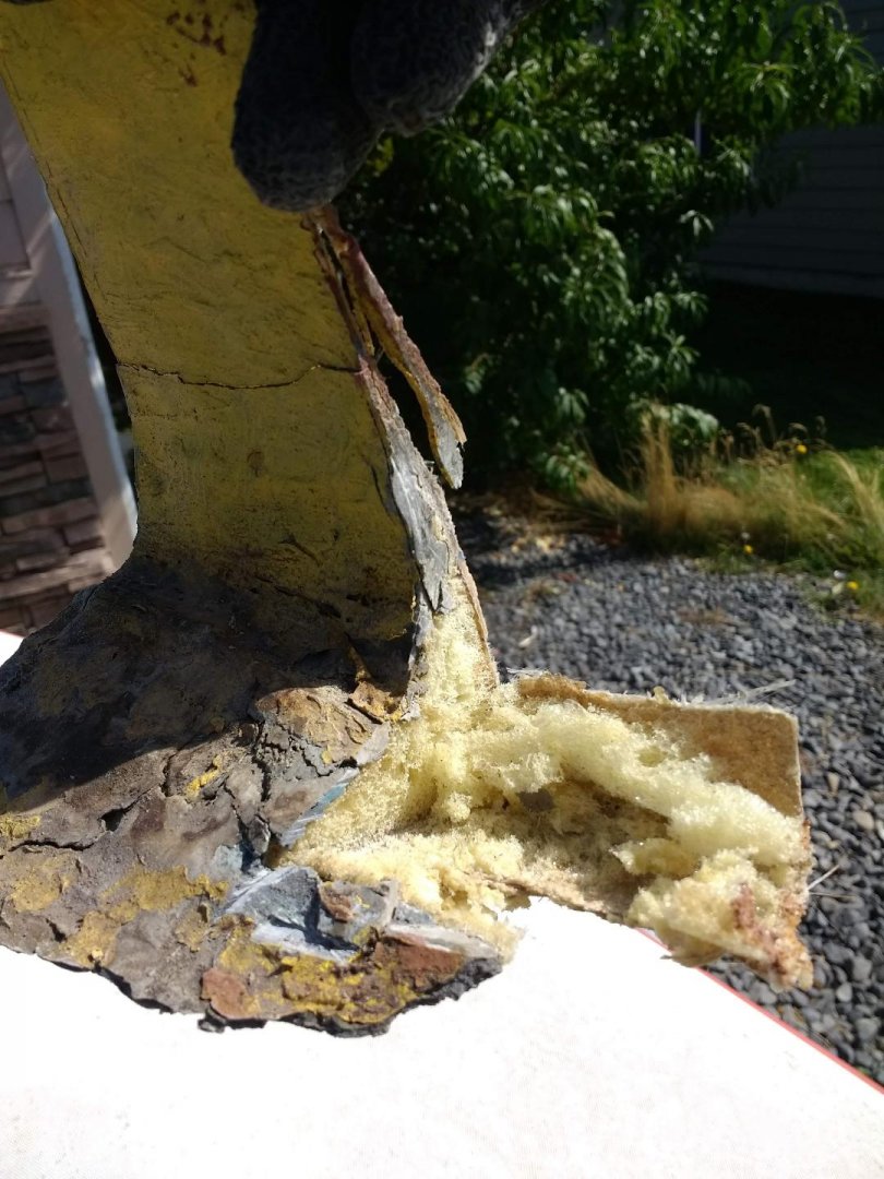

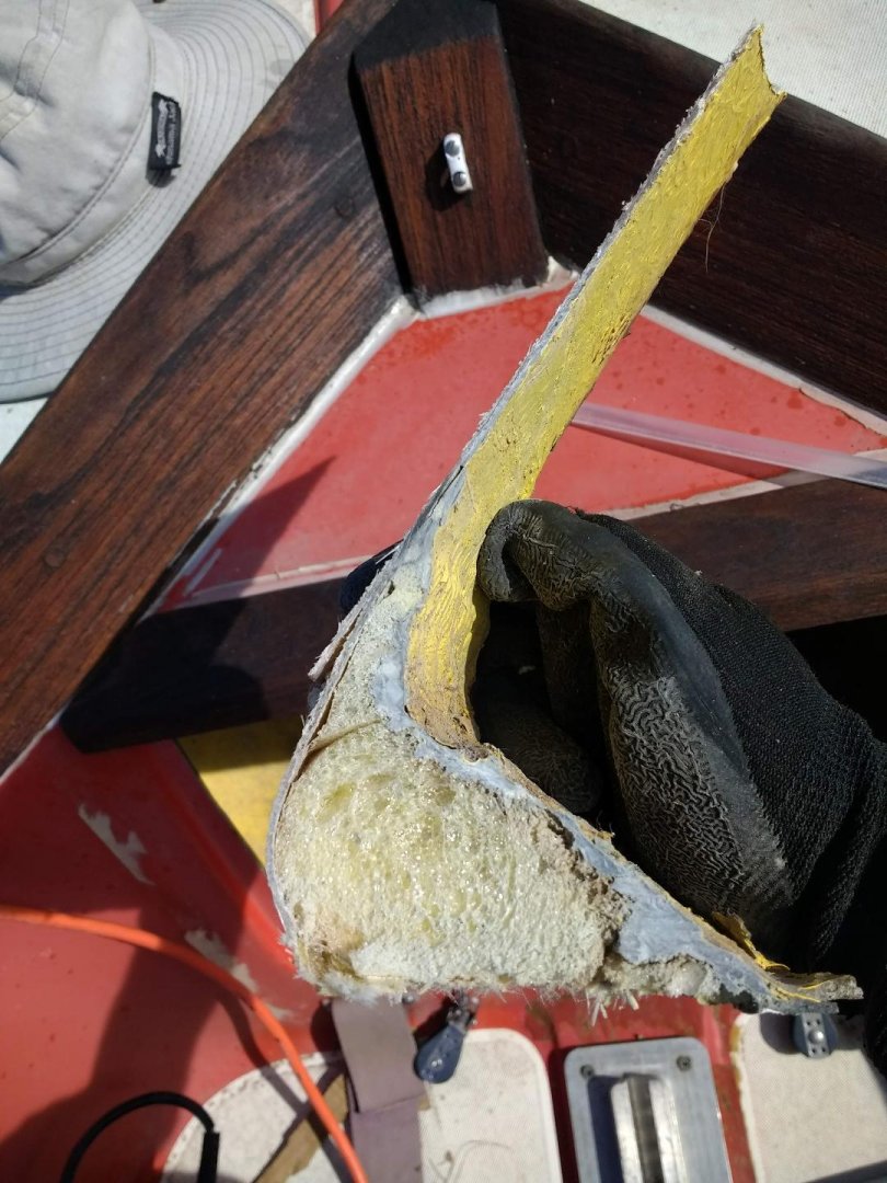

    I've got to give them credit, if it had bonded better at the bottom the foam roll under epoxy would have been pretty solid, as it is though the foam didn't bond so the whole thing comes loose. Some cross section pictures below.
    I had some leftover teak oil from another project, fun to dress up the wood trim a bit, also in one of the pictures.

    Oh man...that bulkhead. I think that's spray foam insulation and Bondo. Just a guess.

    A new bulkhead will be a nice upgrade.

    Oh My! Look at that foam... I agree a new bulkhead will be a huge upgrade. Keep up the good work.
