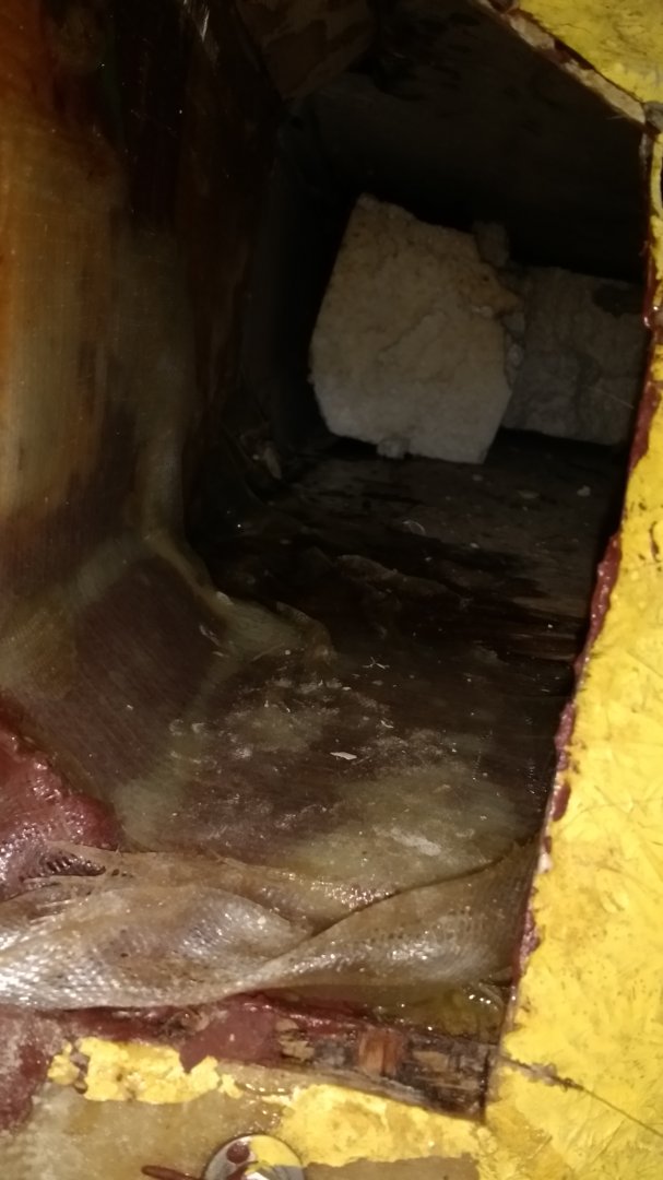

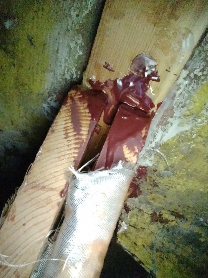

    I installed a 4" cedar board at the bottom of the boat, then cut two fir boards to brace between it and the underside of the deck to support the mast. The Fir goes back to the centerboard slot. I put a triangular strip as a fillet on each side of the bracing board and then put a few layers of glass over it. It's heavy and ugly, but I think it will function.
    The glassing did not go well. The cloth kept sagging and the epoxy drained down the boat. Boat is upside down, so the sagging was towards the underside of the deck. The thickened epoxy in a tube you recommended worked really well. I tried to make my own with phenolic and glass microbead filler materials, but it ran more then I wanted. Maybe I needed more filler, I'm not sure. Worst part was the weight of the fir boards sagged the deck about 1/4" and I ended up needing to shim the fir boards to get good contact at the front. I'm not too stressed because I got the mast support mounting screws to go all the way down into the Fir boards, so even though the glassing at the top is REALLY ugly, I think if I can do a better job glassing the bottom it will be okay. Plus, while the glassing is pretty bad, it sill has like three layers of glass and lots of epoxy holding it on each side, and two layers on the back securing the fir boards to the centerboard slot. I plan to fill the cavity between the boards with spray foam, and then seal it up when I flip the boat over.
    I tore off the old centerboard gasket, definitely kind of a hack. the slot is full of holes. I'll fill the un-needed holes up with epoxy once I get the caulking cleaned off and then redo it. I ordered the catalina gasket just to make things easy. Once I get the gasket on I'll flip it over and work on better glassing the bottom of the mast support once it is down (I tried glassing in "celing" mode with the boat upside down, but that was just a big mess).
    When working on the mast support I noticed the fiberglass over the wood support panels on the bottom of the hull are crumbing. Also noticed a few spots I think the only think keeping the water out was a thin layer of paint (really light spots on the hull showing light in marking previous repairs). Kind of a tough call how far to keep rebuilding the boat. I feel like to get into it too much further I need to split the boat apart just to get access, but that's probably more of a project then I want to do.

    Flipped it right side up and have been working to get all the wood used in the mast step support fiberglassed so it won't rot. Whoever owned it before used JB weld over foam to afix the bulkhead and it's been slow going to get it all cleaned out. It's been pretty smokey to work outside for a while and I'm starting to make progress again as the air clears out a bit.

    JB Weld over foam? That's a new one. I'd give them props for trying. Post a picture of that stuff if you get a second.
    You should just pull that bulkhead out. It's not worth saving.

    Take out those bolts with the washers, grab the original bulkhead at the bottom (with a pair of work gloves) and tear the whole mess out of the hull.

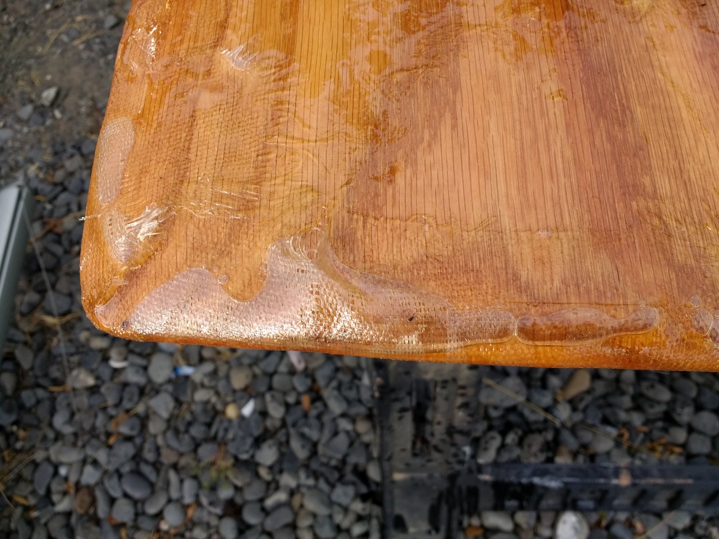

    I made a rudder out of home depot oak. It's the wrong kind of oak I was reading though (red oak), so I coated it with a thin layer of fiberglass cloth. Where the cloth folded over the edge I need to sand down to open up the bubbles and fill with epoxy, glassing curves is still a bit tricky. Do you think one layer of fiberglass cloth (I used a fairly light cloth) is okay or do you think two layers is needed? The cloth was a bit oversize for one side of the rudder, so the edges really have two layers already.
