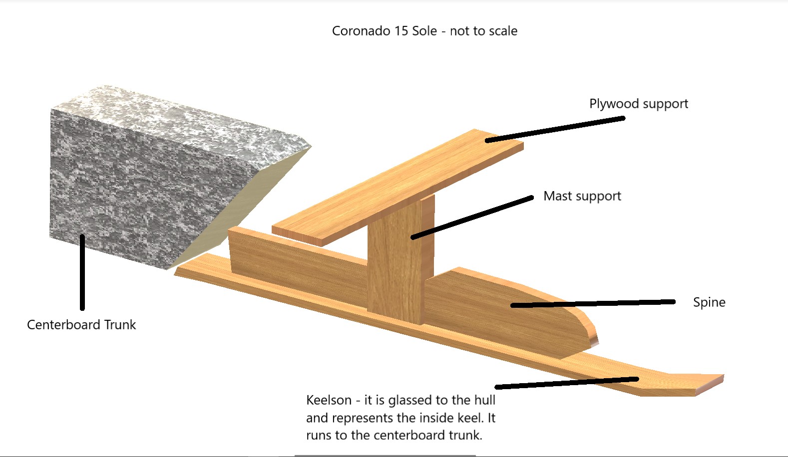

    Hey guys. Just thought I mocked up a crude and not to scale diagram of the Coronado 15 sole.
    Any suggestions for how to remove the keelson? Slow going for me as I am doing it by hand with hammer and chisel.
    Any feedback on the image would be great. Just hoping to make sure everyone is on the same page.
    I doubt that I'll heat the fiberglass. I'm more inclined to use a spreader clamp that applies pressure onto some plywood from within the cuddy. Then epoxy and glass it into place. If I can repair the trailer then it *shouldn't* revert back. Am I on track with this idea or way off the mark?

    The glass is not very strong and if you can get the chisel under an edge, it won't be to much trouble (no promises though.) I recall using a grinder for part of the job. The glass extends out past the edge of the plywood, you might be able to peel the whole thing up with the chisel if you're careful.
  12. Canracer
    Joined: Aug 2009
    Posts: 621
    Location: Florida
    Canracer Senior Member
    You have the right idea here. The spine and mast support could be all one piece. And it would be stronger if it matched that angle on the centerboard trunk. The forward section of the spine (in illustration) has a complicated shape. Maybe that's how the factory piece looked but I wouldn't try to copy that original arrangement.
