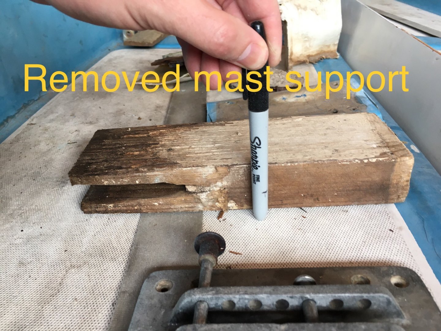

    Just thought I would also share these images as I removed the old mast support. It’s regular pine with a cut channel to straddle the spine. Got a quality piece of teak to craft a replacement and will do so over the next couple weeks. Upchurchmr has some quality images that I’ll imitate.

    when you put the mast support back in, coat it liberally with epoxy. Possibly even with glass/ epoxy just to make sure you have enough epoxy to protect the wood.
    There is also a plywood piece bonded into the floor just under the mast support and the ply stiffener you can see in the second picture.
    If this is rotted, you will need to grind out the glass covering it and put in a new support.
    Otherwise the mast will just compress the rotten wood, shifting the position of the mast and moving the deck glass around in the same manner that broke the gell coat around the cutout in the first picture.

    It appears to be rotted. More than likely it too will have to be ground out, replaced, and glassed.

    And yes, that "raised spline" should be removed if it's rotten. From your image it looks like the bulkhead (on each side of the compression post) has detached from the inside surface of the hull. If you pull out that bulkhead you'll have much more space to work.
    This is what's behind the compression post and in front of the centerboard trunk. That center section is a stiffener. Everything was installed on top of a strip of plywood that was glassed to the bottom of the hull. The wood absorbs water from the exposed end grain and the piece rots. When it gets soft everything starts to move around and slowly pull apart. You might consider pulling out the detached bulkhead and also remove the plywood strip. Build the new compression post on a solid foundation.

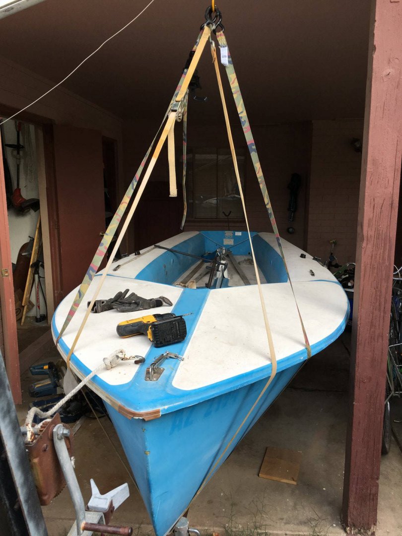

    I’ve been working in the sole of the boat. It is slow going, as like all of us, time is limited. But I noticed today that there is major sag in the bow, like a hyperextended joint. The boat is 40 years old, it’s previous owner kept in the sun uncovered for 10 years, and I think the way it sits on the trailer’s roller accentuates the problem. I don’t have the resources to pull the boat off and set it somewhere else or the ability to turn it over. So I strung tie down straps under the bow to correct the issue. Now when I replace keelson and glass it should be in the right position.

    This is a common problem, though mostly seen on powerboats with poorly fitted trailers. 'Glass has a "memory" if it's subjected to loads continuously over a long time. If the boat is "released" from the load (poorly fitting trailer) it'll remember the imposed shape it was forced into and will not pop back into it's previous position. There are only a couple ways to fix this and none are very enjoyable. The first and least desirable is heat. You can prop, brace, cuss at and convince the boat back into the shape it formerly was and apply heat, with a heat gun and the molecules will realign to the new forced in shape, once allowed to cool. This is a crap shoot, as it's real easy to add too much heat, which can general distortions and other issues. Next and the most commonly method is fill and refair the areas affected by the distortion. This means lot of putty, weight and elbow killing sanding. The distortion will still be there, it's just covered and refaired to mimic what was once more appropriate for the boat.
    A lot depends on what type of distortion is present. Sometimes you can make "relief" cuts to ease the strains on the distorted areas, knowing you'll have to fill and add reinforcement and replacement fabrics in the process. Strapping her down might work, if left this way for a long time or in a outdoor Arizona setting for a few years. You'll have to monitor this effort and move straps as the hull starts to return to shape and it's slow work. You may be able to strap, brace, etc her back into position then lay some additional laminate on the inside to hold this shape, maybe some ribs to help.
    As a rule, on small, low value boats, the effort isn't worth the time or materials.
