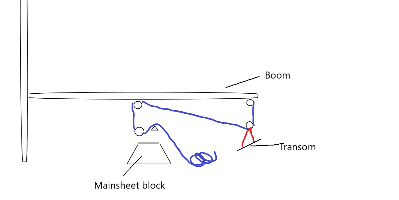

    I haven't been able to take any pictures yet, but I drew it out according to what I've been doing and the previous owner showed me.
    After the original post, I can see how wrong this is, but I still can't clearly see exactly how the main sheet should be rigged.

    I hope this is clear. The first sketch is same as you were drawing. Works good for lighter wind. The second sketch is for heavier wind, but requires more length of the main sheet.

    8F901AA3-A96D-4A97-BABE-920A611556D0.jpeg perfectly clear upchurchmr. Your drawing is consistently what I see scouring the web for information. I found a decent picture in sailing anarchy and have posted it below. Does it look like we are on the same page?

    Yes, that is the same as the second "sketch". You see the short white connector rope? If you take it out and the upper pulley its attached to that is the first sketch for lighter air.
    Pity this does not show the bridle, where you had the mainsheet going down to the bridle - that would have taken your head off when you tried to tack.
    You might want to plug the old 1" holes for the old style traveler. And the mounting holes directly above. The backup structure for these screw holes is plywood. If you don't seal them with epoxy, the plywood will start to rot and there is not easy way to fix it.

    That image seems a pretty convoluted way to rig a sheet. Two double blocks or a double and fiddle mounted at the mid boom point, with the tail landing on a cam cleat. The line from the bridle runs up to the turning single at the boom end, down to the boom mounted double, then down to the deck mounted double or fiddle, then final through the swiveling cam cleat. Most fiddles include the option of a swiveling cam cleat so even less pieces to play with. The bridle can be rigged as a traveler:
    Now this is end of boom sheeting, but it still works on a mid boom sheet. Also for light air work a simple bungee cord can be rigged to hold the assembly off the tiller.

    This is a very light boat.
    No need to over think this with such a complicated setup as shown.
    One benefit of having the mainsheet cleat in the midboom position is that you can keep watching where you are going instead of looking where you were.
    Looks like at least 5 extra blocks in this setup
    Using a "traveler" setup at the rear bridle seems valuable, but it seems to be standard in this class to not.
    This seems to be showing the rig for a masthead boat with the other pulley setup for masthead tension adjustment, not needed for a fractional rig as on this boat.
