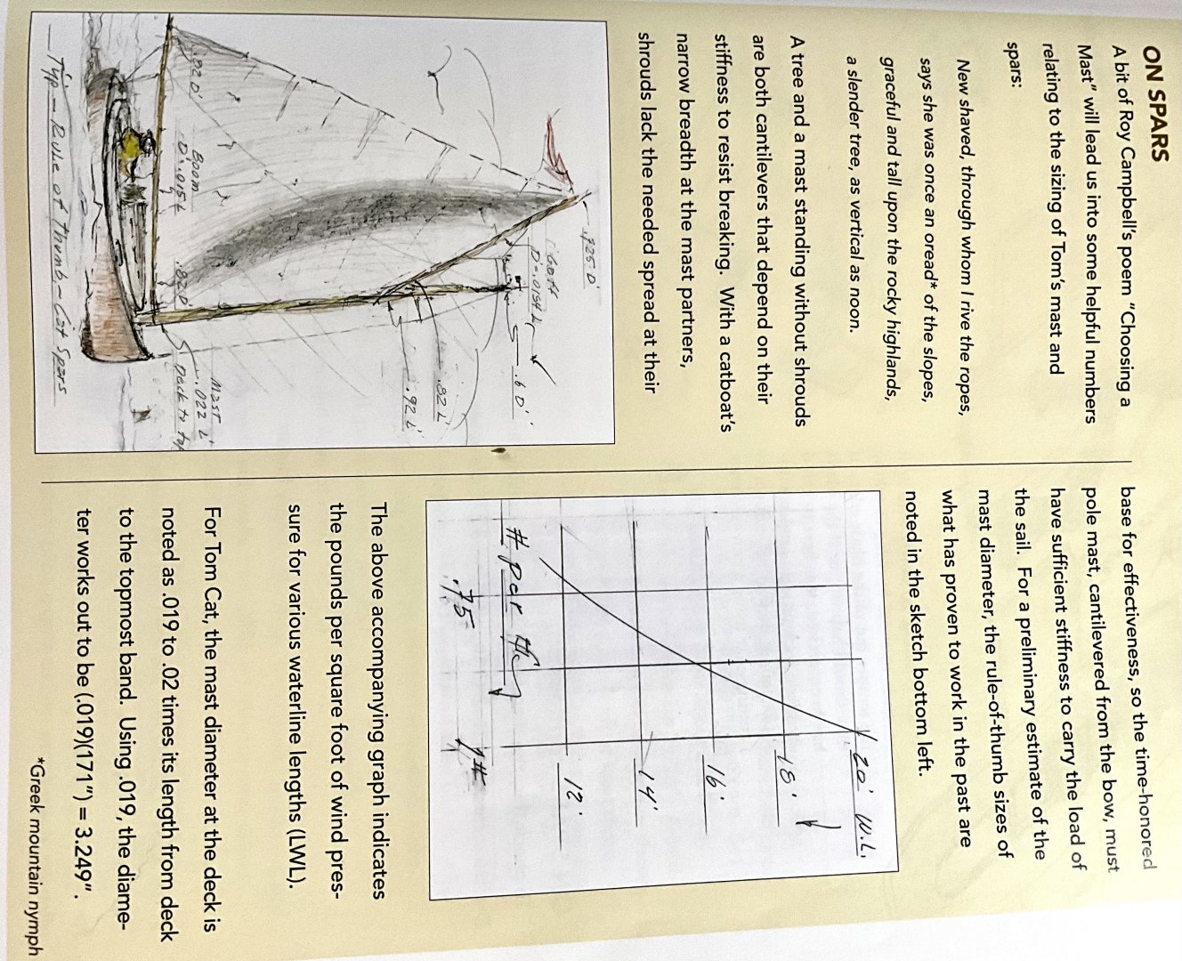

Giving this some thought it is not difficult to come up with an aluminum cross section that will carry the load that the existing solid 3 inch spruce mast would carry. I am assuming that
the exising 3 inch diameter is designed to allow for whatever factor of safety that you are comfortable

Other factors to consider
1) you need to ensure that the mounting will not cause a stress concentration then failure
2) The modulus of elasticity of aluminum is about 9 times that of white spruce so it is stiffer
THE BIGGEST ASSUMPTION IS THAT THE 3 INCH SOLID WOOD MAST MEETS ALL OF THE LOADING THAT THE MAST MAY BE EXPOSED TO AND THAT A SUITABLE FACTOR OF SAFETY HAS BEEN INCLUDED.
