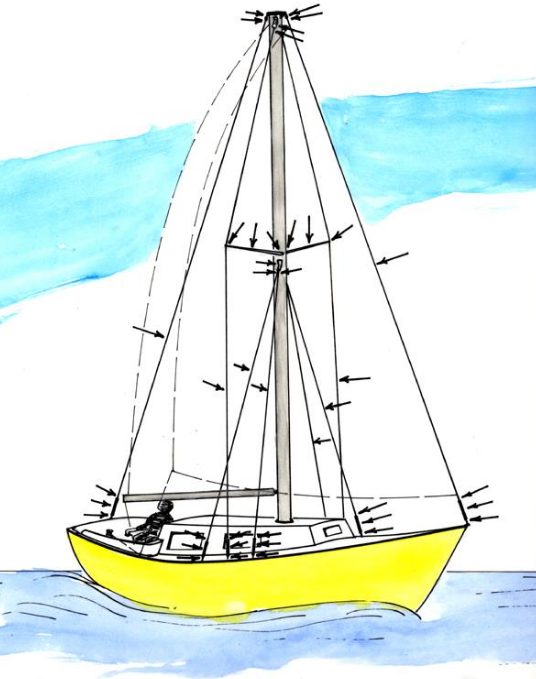

    Here is an illustration of the potential failure points in a stayed rig. This isn't even all inclusive. Screen Shot 2020-09-01 at 5.55.11 PM.png

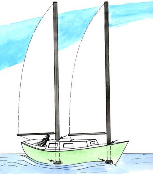

    Now how to construct a sufficiently strong mast base for an un-stayed mast on a beach-cat?

    Your last sentence indicates that you're certainly not someone who is actually asking for objective feedback. Do you really think that everyone else with far more experience is so ******* stupid that someone with no experience knows vastly more?
    A pair of 43lb masts in a small cat IS heavy. In small cats, you're not always reefing before you meet stronger winds than you expect, because issues like acceleration, nosediving and wave-induced wind strength have very considerable effects.
    What's going to keep the boat upright while you reef?
    The 2.5 inch (approx) T6061-T6 alloy mast of a Laser dinghy, which has something like 2mm wall thickness, can and does fail in strong winds. A Laser has dramatically less righting moment than a cat, and it has a "pinhead" sail that lowers the heeling moment. I'm no engineer but I would be surprised if such a thick section without stays would survive on a cat. As a top multi designer once pointed out to me, stays are incredibly efficient from an engineering viewpoint which is why they are used in bridges, radio masts, etc. The top cat designers and sailors are designing some of the world's most efficient racing boats, and they use wires.
    The drawings showing the failure points in stayed versus unstayed masts are wrong, as are many points in the article such as the utter rubbish claims that rating rules require wires. Anyone who writes an article that contains such false statements, and who has not corrected those statements when their falsity has been pointed out on this very forum as happened, is ignoring reality. I have sailed boats that have broken gear in the points indicated in the drawing, and yet the rigs have stayed up. I also own unstayed rigs and have had them snap, in ways the drawing does not allow for.
    Low aspect sails are not a waste of area. Even Marchaj shows that they work well at wider apparent wind angles in terms of lift, as well as having lower heeling moment. Designers are not ******, and the good ones use high aspect when they should and low aspect when they should, which in turn depends on righting moment and other factors that affect issues like apparent windspeed and angle. Actually, given the way that "real world" high aspect sails work compared to how they work in theory, I tend to suspect that the theory isn't allowing for what happens in the real world. I may have missed it, for example, but I can't recall seeing any theory to explain why the world's fastest classic A Class cat goes at its best downwind in light airs with 19% mid-chord camber and 20 degrees twist. Similarly, look at windsurfer rigs, where the fastest sails tend to be of fairly low aspect ratio for handling reasons, because high-aspect rigs don't perform on the water in the same way they do in theory.
    By the way, you can put draft in a sail without any seam taper. A surprising number of windsurfer sails are built that way, creating draft simply by using luff curve. However, to flatten sails by luff and leach pressure can dramatically increase compression on the mast, which can cause breakages in unstayed masts.
    The line in your sketch that leads to the aft corner of the head will cause the sail to develop enormous depth to develop, because forces will follow a straight line; in fact it's hard to see how the sail pictured will work with any efficiency at all.
    Top designers and sailmakers are NOT brain dead fools who have spent decades doing stupid stuff. They do what they do because it works. Top designers are often incredibly open and helpful to people who respect them enough to ask "why was a design done this way" and learn from the answer, instead of assuming that the top designers are wrong.
    ---I had no comment on the article itself, was just an illustration of how many individual parts and attachments a stayed mast can have, all potential failure points. An unstayed mast obviously has WAY fewer potential failure points and you have to engineer all those points. It is relatively easy to make the base strong, not as easy to string up a web of lines and build in attachments for all of them.
