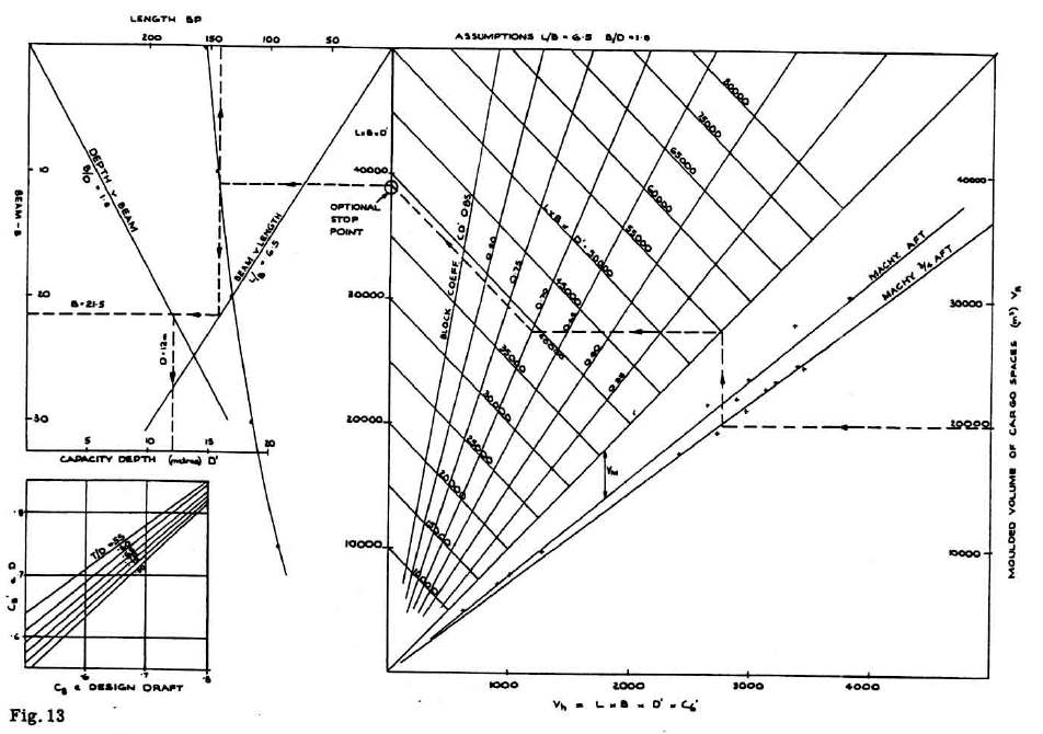

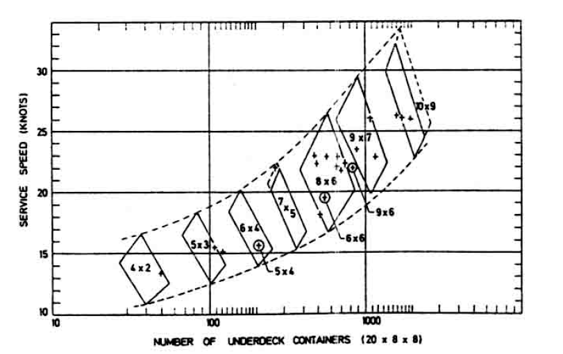

    If you know the number of container, you can sue this graph to obtain the optimal BxD ratio:
    That will then give you the 'midship' cross section.
    So that then roughly fixes you beam...no of unit (+structure allowance) and the number of units length wise.
    Add an allowance for fine entry fwd and aft for props...so no. of TEUs x 1.20 = Lwl.
    So now you have L x B, so using this graph:
    You can use the LxBxD you have estimated...or use the moulded volume, knowing the volume of each TEU, to cross reference volume against the LxBxD.
    Hey presto
    Ghost Boy, philSweet and bajansailor like this.

    A suggestion re deadweight - you can get approximate values for L, B and D from Ad Hoc's advice and useful diagrams above.
    And for deadweight, this is listed for container ships on Marinetraffic.
    Here is a typical example (currently berthed in our port at Bridgetown, Barbados). I like her name 'Sea Steamer'. :)
    https://www.marinetraffic.com/en/ais/details/ships/shipid:733240/mmsi:566840000/imo:9366158/vessel:SEA_STEAMER/
    Marinetraffic also gives you the L and B for each ship.
    So, you could compile a data base of container ships from Marinetraffic (there are an awful lot of them available here), and see how they correlate re Dwt, L and B?
    This approach might be a useful 'initial start'?

    thanks a lot sir for your explanation. Sir, I have one request to you. Could you please tell me the books name of the graph you have uploaded as well as need a better copy of those graph.
  11. Ad Hoc
    Joined: Oct 2008
    Posts: 6,898
    Location: Japan
    Ad Hoc Naval Architect
    It is the Classic paper written by DGM Waston & AW Gilifillan called - Some Ship Design Methods, published by RINA in 1976.
    This was essential reading material as a student.
