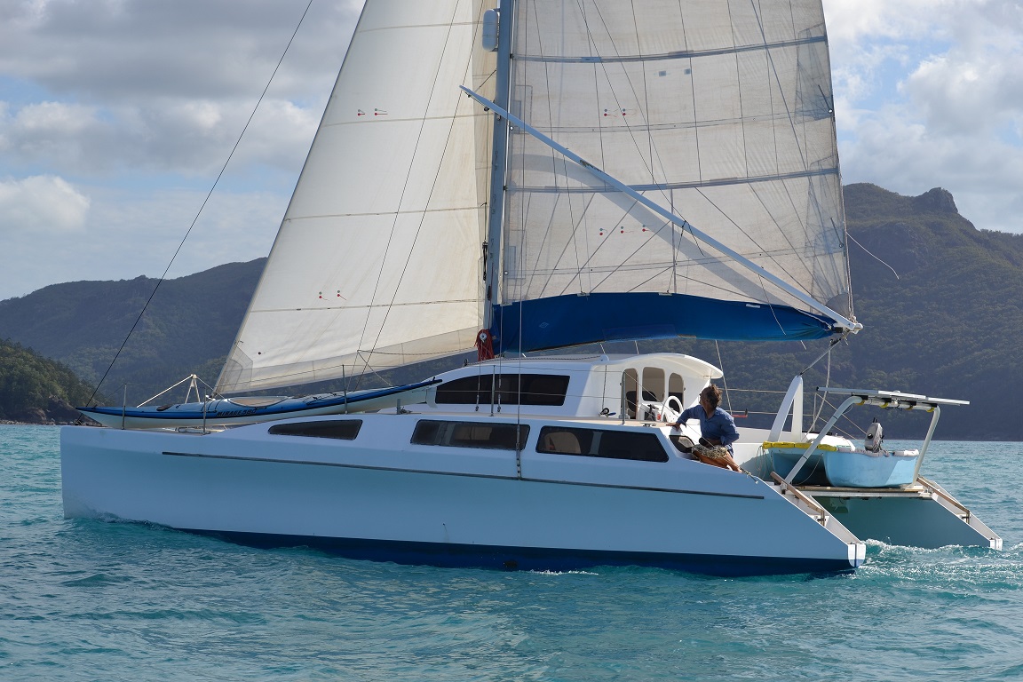

  6. catsketcher
    Joined: Mar 2006
    Posts: 1,306
    catsketcher Senior Member
    Access into the hulls is pretty important, you go up and down tens of times a day. In some old designs you had to crouch down and even get on your hands and knees - not good. Friends with a Spindrift like this put on a 45 degree blister at the bridgdeck/hull join that had the steps within it. Helped dramatically.
    As for my cat - we started off wanting something with great visibility and thought we did not need the extra room of a bridgedeck cabin. But an open cockpit is a pain - no shelter from the wind, rain, spray so as we cruised our cockpit shelter grew until it sheltered the entire centre cockpit. It worked but looked awful close up so I cut it all off, put the cockpit back aft and built a see through and see over cabin, that looks like a normal cabin. You can see through it easily though. We spend lots of our time inside underway as we can still very well from inside.
    cheers
    Phil

  10. catsketcher
    Joined: Mar 2006
    Posts: 1,306
    Not readily available - it started out as a windscreen with a roof, then got ply sides as we cruised with no back. I never finished it as I was always going to do it again - it worked well but was bad to look at. Now it is pretty much a normal cabin. Twin removable doors and a lots of opening windows - one in front of the wheel, one at the centre front and one each side of the windscreen. Low enough to see over as the cockpit is higher than the trench that runs sideways across the bridgedeck.
  11. jamez
    Joined: Feb 2007
    Posts: 514
    Likes: 32, Points: 28, Legacy Rep: 231
    jamez Senior Member
    Thanks Phil. Nice looking conversion.
  12. DGreenwood
    Joined: Aug 2004
    Posts: 722
    Likes: 40, Points: 28, Legacy Rep: 507
    Location: New York
    DGreenwood Senior Member
    Wow! Great looking cat. It looks like you balanced function and beauty very well.
