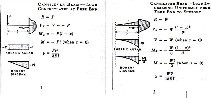

    Not sure where you found that diagram, but i'd ask for my money back!! :eek:
    The shear is constant, in the absence of any other applied load for that simple cantilever analysis. That curves shows the slope/deflection, but is also wrong way around. The built-in end is always zero.

    Sorry, you are not going to get your money back;). Equation 1 is when it is a pure cantelever and the shear is constant, I use equation 2, slightly modified with a partial load on the far end because I think the hull does not get lifted out of the water. It just tend to rotate on the center of gravity.
    I use equation 1 on cat sailboats when one hull gets lifted out of the water due to the lever acting on the mast, rotating the two hulls along the middle of the crossbeam vcg.
    A third equation which seems to be more appropriate for a sailing cat is a couple when there the lever twist the midspan of the mastbeam due to windload acting on the mast. This twist the mast into an "S" shape. Not much progress though. One equation is for a fixed beam, the right one written in Russian.:D
    1 person likes this.

    There is no 'increasing' load in the diagram of the demihull being 'fixed' to a built-in connection as you show here. The weight of the demihull does not go up and down, as that would imply weight being add then removed and also from the demihull to the fixed built-in end. It would thus imply the draft is constantly changing too.
    You need to be clear what load case it is you are attempting to analysis, rather than applying what looks like a similar situation when in fact it is not.
    It matters not if the hull is totally or partially lifted out of the water. There is a simple bending moment, the force x distance. The distance from the built-in end to the centre of the demihull (assume the CoG remains constant on the demihull) is constant. The force is the hulls weight. The max is when the hull is out of the water, and lesser when partially, as it is still supported by buoyancy. Thus either one designs for the partial load case or the worst load case. It is a no brainer, one must always design for the worst load case. Thus assume the hull is totally out of the water.
    As for the rotating of the two hulls. Again what load case are you referring too? There is the classical transverse bending moment, then the pitch connecting moment and the torsional connecting moment. These are different from when hull is out of the water and the other demihull is the "built-in" end as a simple cantilever.

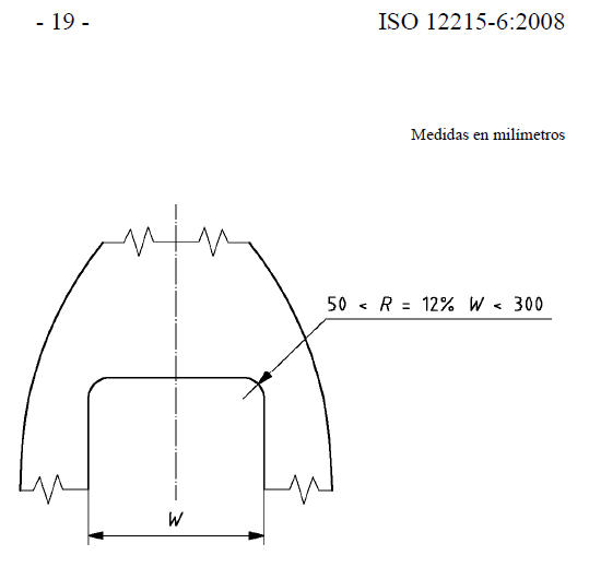

    I'm sorry to dig this thread up again. But, I'm reading this thread again now, but, I don't think I get an answer yet, how to analyze this radius. Now I realize this radius is connected with structural continuity. So, how can I know my radius is enough for continuity? In which WAY can I play and see? by FEM? by Trial constructions?

    The closest thing I found in the various regulations, to give an answer to your question, is the attached figure.
    I do not know, really, if that can help in your problem.

    So, as yourself this Q. How do you analyse a simple bracket joint between two structural members at right angles to each other? What rules are there to say which is right or wrong, in terms of radius etc?
    Once you realise that one..then you see that the only way, to satisfy yourself, the radius is not an issue is to use a generous radius (a factor of safety if you like), or if you wish to have a more quantifiable answer, use FEA as a metric for measure.
