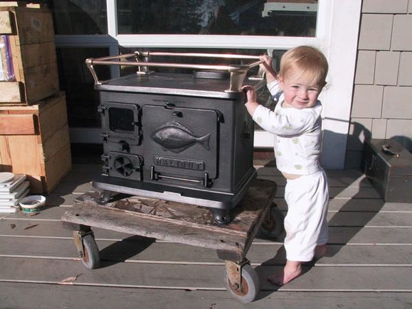

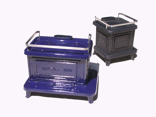

  11. CatBuilder
    CatBuilder Previous Member
    Yes... get one from Andrew...
    http://www.marinestove.com/sproducthistory.htm
    There are several models available aside from the Little Cod. If you buy a stove from Andrew, you are supporting this country (well, NAFTA, seeing as how you are from Nova Scotia) and someone who is making a living for his family by providing us boaters with a very very high quality product.
    These stoves run on wood or coal. I have used both in them, but strongly prefer wood because of the type of heat developed with it.
    The "bio brick" type fuels work as well. I've burned them in the Little Cod for an entire winter in Maine. All told, I have approximately 5 or 6 years of winter liveaboard, with my wife, under my belt using these stoves as the sole source of heat for our boats. We have no other home, aside from our boats and we live aboard 365 days a year.
    These are serious stoves, putting out 28,000 BTU.
    They are very warm and pleasing. You can cook all of your meals on the stove while you are aboard as well. We almost never used our LPG stove in the winters since the Little Cod was always going.
    Not only that, they are a part of your history in Canada!
    Two of our stove pattern sets have their roots in Nova Scotia, Canada. The Lunenburg Foundry produced a wide range of marine equipment for commercial vessels and yachts since the company's founding in 1891.
    Lunenburg ceased producing stoves in the early 1990's with the closure of their iron foundry operations.
    Utilizing Lunenburg's vintage foundry patterns, Navigator is continuing producion
