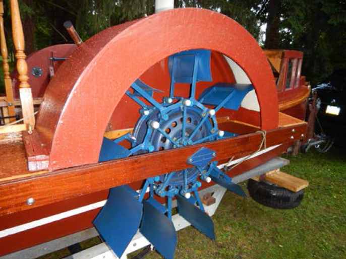

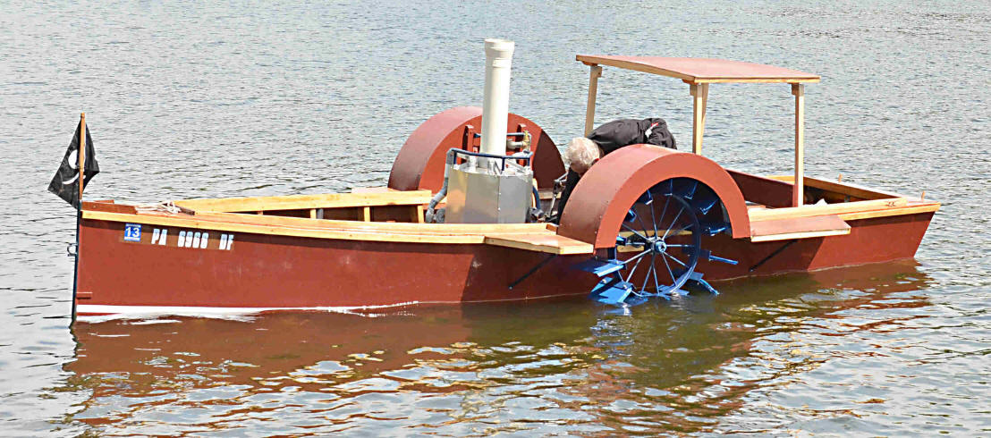

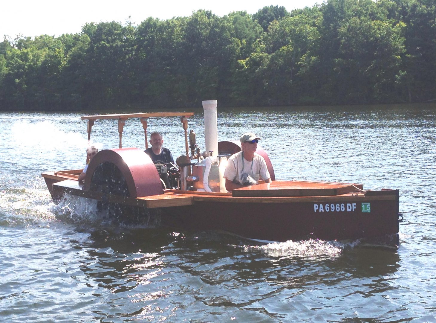

    From SamSam: "I found another interesting one..................... This doesn't have all those cams and levers in other designs, which schemes don't keep the paddles all that vertical anyways. These are completely vertical 100% of the time.................... I believe the normal paddle wheel is efficient enough without the added complexity, the problem with paddle wheels is the whole paddle wheel apparatus is just generally cumbersome and inconvenient compared to propellers. It just depends on if you want a paddle wheel or not."
    A few incorrect statements here.
    The feathering paddlewheels of the last half of the 19th century had no cams whatsoever. At least I have never seen cams on the feathering mechanisms, and I have examined hundreds.
    Keeping the paddles perfectly vertical is presented in the patent SamSam is examining, but the old conventional feathering mechanisms could be configured to do just that also, however, the optimum hydrodynamic geometry would not seek to always keep the paddles vertical anyway.

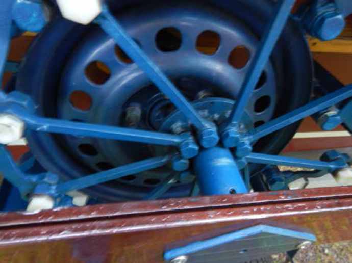

    Conventional paddlewheel (with fixed paddles) is "efficient enough" without all the complexity of a feathering mechanism? I guess that depends on your priorities, the feathering wheels were on the order of 15%-25% better propulsive efficiency than the fixed paddle designs. This is at the expense of having the feathering mechanism, and (in the case of my sidewheeler) having 72 rotating joints in the water. I have run for 3 years with fixed paddles, then I made feathering wheels, they have been in service for 4 years now, without any failures.
    Yes, screw propellers are a much better design, except when you want to run in shallow water, or in water with underwater grass, which stops many steamers these days. Pictures follow,Margaret S. Sidewheeler, with fixed paddles, and feathering wheels fitted later.

    I would expect feathering wheels to kick up less water, at least when going faster, but what about noise? Does that in your experience translate into much less noise?
  8. fredrosse
    Joined: Jan 2005
    Posts: 397
    Likes: 55, Points: 38, Legacy Rep: 56
    Location: Philadelphia PA
    fredrosse USACE Steam
    Feathering wheels kick up less splashing, so less splashing noise. But all those joints working back and forth add some machinery noise. Not very noisy on either account tho. The rotating joints on my wheels are 5/8 inch diameter Nylon bolts, running in ordinary steel nuts. They are lubed with special food grade grease, and believe it or not the grease does not wash out with years of very much washing action. I chose the Nylon bolts so they could break if I hit something badly, rather than bending up the paddles. I think they are plenty strong tho, having hit underwater logs several times without breaking anything. Actually the wheels, shafts, etc. are from a truck, so they can take plenty of load. Boat speed is about 5mph max.
