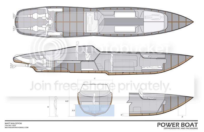

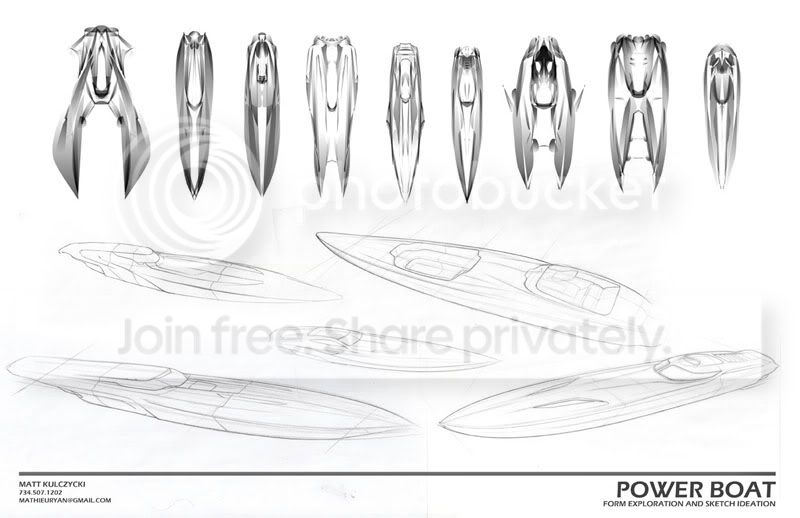

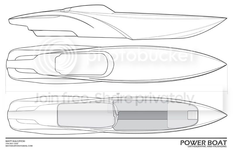

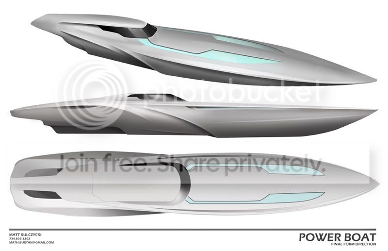

    I am a college student going to school for Industrial design. This semester one of the projects I am working on is a powerboat. Thought I would share my progress, although it is conceptual I still wanted to keep some of the main elements real. Look forward to your opinions!
    ,Matt

    Matt; you draw sexy looking boats. That is good. You have some serious design flaws and that is not good. For starters you will need to get the props in the water in order for the boat to go.

    I understand that surface drive boats have props in that location?

    About half the prop diameter still has to be below the transom edge. :p

    Nice design. The propellers have to be submerges about 50-60% below the bottom. If you continue the line from the bottom, it should intersect the shaft or a bit above it. Where are the fuel tanks? The powerplant appears to be a pair of turbines.

    I have 2 fuel tanks just in-front of the turbines, Not entirely sure about the position of them or if they should be lower into the body. So you are saying that the prop needs to be at about the water line or below it? I planned to have the waterline at about 3.5' which is where I put the prop. Though I dont have a solid background in boating so I need some clarification.

    This kind of boat will plane. In planing, there will be almost no water above transom lower edge, except spray.
    Turbines drink LOTS of fuel. Accordingly, tanks have to be fairly large. And in boats they are usually located low down, in the bottom.
    And even larger lots of air. To supply it, there has to be very substantial air intakes (so large you could crawl into), additionally, if operation in any kind of weather is intended, air intakes need reliable all-weather protection from spray, created by sea waves and mostly, by the boat itself. Spray-filled air is not healthy for turbines.

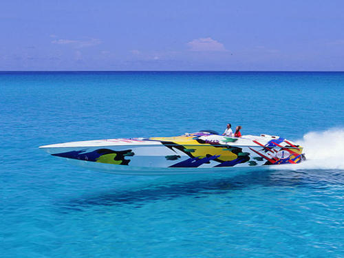

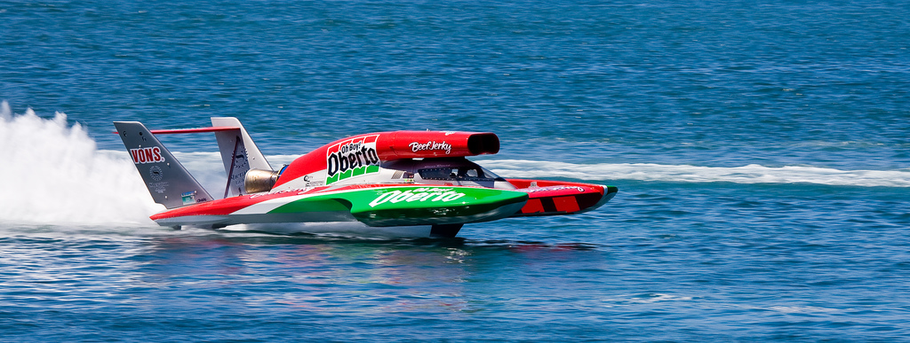

    This shows how much of the hull is in the water at plane.
    Granted, we're looking at an unlimited hydroplane here, but the concept still holds. A vessel on the plane moves mostly across the top of the water rather than through it, and so the props need to be at the very bottom of the hull or they will be totally out of the water at speed.
    This is closer to what you're looking at, but, as you can see, the concept remains the same. Your boat may have 3.5' of draft sitting still, but will have almost no draft under way.

    Have you calculated the displacement of this boat? It looks like it may be exceedingly heavy.

    The steps at the hull bottom shouldn't be faired or inclined backwards. They have to be sharp, vertical (or even slightly forward-facing) and ventilated.
    Also, it looks like there's not enough buoyancy aft to support the engine room weight.

    Correct me if Im wrong, but I assume a design concept is an idea drawn by a free thinking, talented artist, like the original poster, then given to the engineers , naval architects and marketing men to create a real boat.
    Many of the modern yachts I see began as impractical artist concepts, full of design detail , that were then re engineered and carried over into the finished product..
    The boats presented look good and should draw the attention of NA's, boatbuilders and end users.
