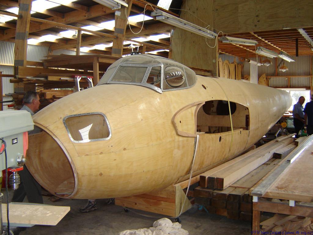

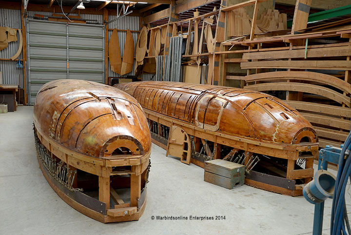

    The Mosquito was moulded, but a lot of plywood panels were compounded. Look at the pics. Scantling inside plywood 1/16 (1.5 mm) Balsa 7/16 (9.3 mm) outside plywood 5/64 (2mm) and that works...(A link about the details;
    http://users.skynet.be/BAMRS/dh103/fuselage-construction.htm

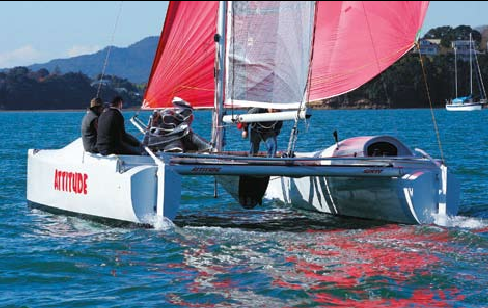

    I have joined a pic of Attitude a 2005 8.5 m 950 kg catamaran made in 4mm and glass compounded plywood, a very good design and work, costing 1/3 of the composites catas, and the PDF of the article about this boat. I counsel to open it and to have a look at the pics...

    Interesting in your post, Ilan Voyager, that you've shown the John Tetzlaff 2005 built 8.5 catamaran Attitude; he used the same construction technique on the slightly larger This Way Up, which was a few years earlier.
    Aside from the stressed plyTornados in this country, the earliest in this technique would be Malcolm Tennants Bamboo Bombers; two were built in Auckland back in the late 1970s. And of course even earlier, in larger multihull sizes, like over 25 odd feet, the early 1970s Gougeons' Adagio has to be either the first, or close to it.

    Gary, Attitude is a good boat with an excellent ratio price/performance. And it won races...Your own posts on another 2009 thread about compounding.
