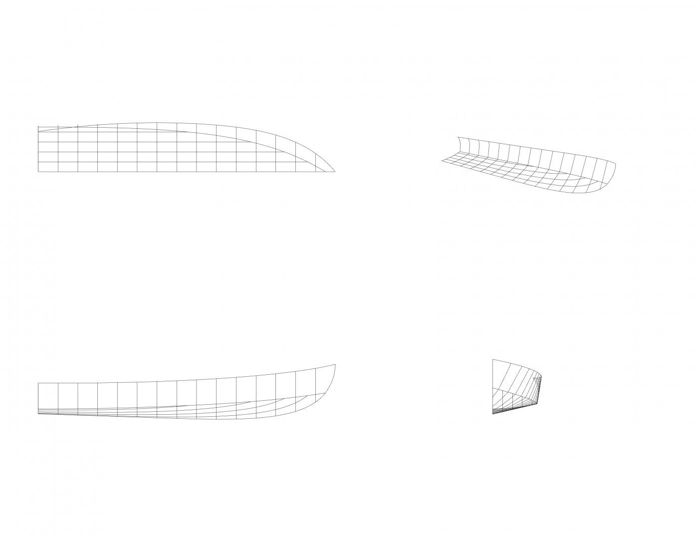

Tangent developable surfaces, which can be created by sweeping a line tangent to a curve along the curve. The surfaces in the post above were created from the edge curves by determining untwisted ruling lines between the edge curves and using the Rhino command DevLoft.

Do the surfaces have tangency at the ruling lines? Are the edges of the surfaces at the centerline coincident with the stem/keel? Are the edges at the chine coincident with the chine?

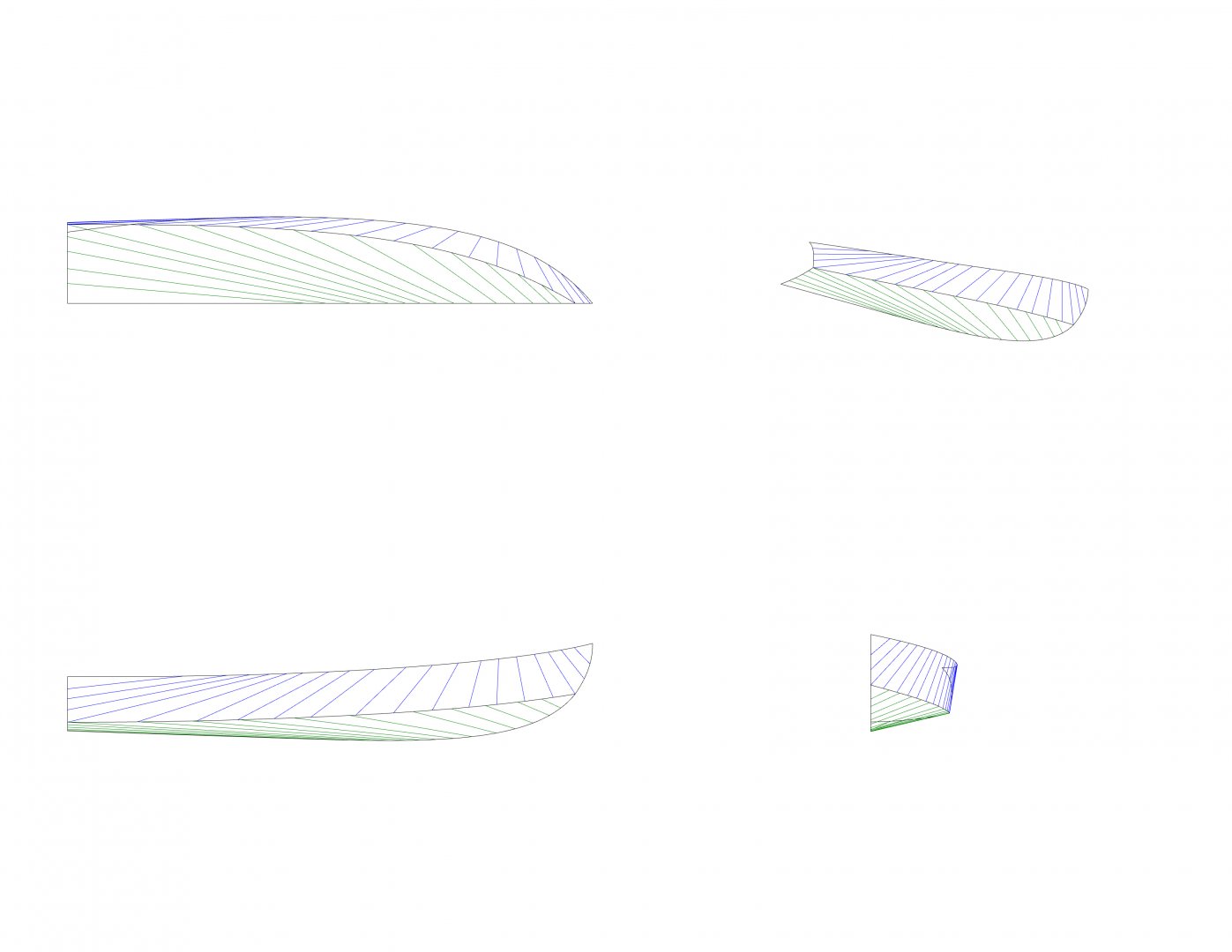

What do you mean by this question? The ruling lines were extracted from the surfaces.
The stem/keel, chine and sheer curves were used directly in the creation of the surfaces. The surface edges are coincident with the curves. The hull is 300 inches long and the maximum deviation of a surface edge from a defining curve is less than 0.009 inches. That deviation could be reduced if needed.
Reason for your questions/skepticism?
I think I do not understand. So, the ruling lines have been obtained from the surfaces and not vice versa?. Strange, very strange
How can this deviation be measured? It looks like science fiction. For me a deviation of one per thousand is more than enough.

The ruling lines shown were obtained from the surface. The developable surface was created by the algorithm in the Rhino V7 command DevLoft. I do not know the details of the internal code of the algorithm but my testing of the command has shown that it creates developable surfaces when used appropriately.
Alternatively I could have determined "no twist" ruling lines between the pairs of curves and then created the surfaces using those curves. The resulting surfaces would be essentially the same.

It’s hard to envision the hull without being able to spin the model around a look at it. I know what a warped bottom hull looks like and I know it’s not developable. I want to know what this hull looks like in comparison.
If you were to draw a section line at a quarter buttock, would be be able to identify where one surface meets the next or at all edges tangent?
The reason I ask about the keel/stem and chine curves is because they are different curves. If you have two straight lines and two different curve and you make a surface from edge curves the surface will not be developable, unless the non-straight curves are sister curves and are diminishing to a perspective point coincident to the two straight curves.
Coincident and small deviation are similar, but also different.

The bottom and side surfaces meet at the chine and are not tangent. The bottom and side each are comprised of 3 NURBS surfaces and the individual surfaces of the bottom and side are tangent with each other and effectively curvature continuous with each other.
