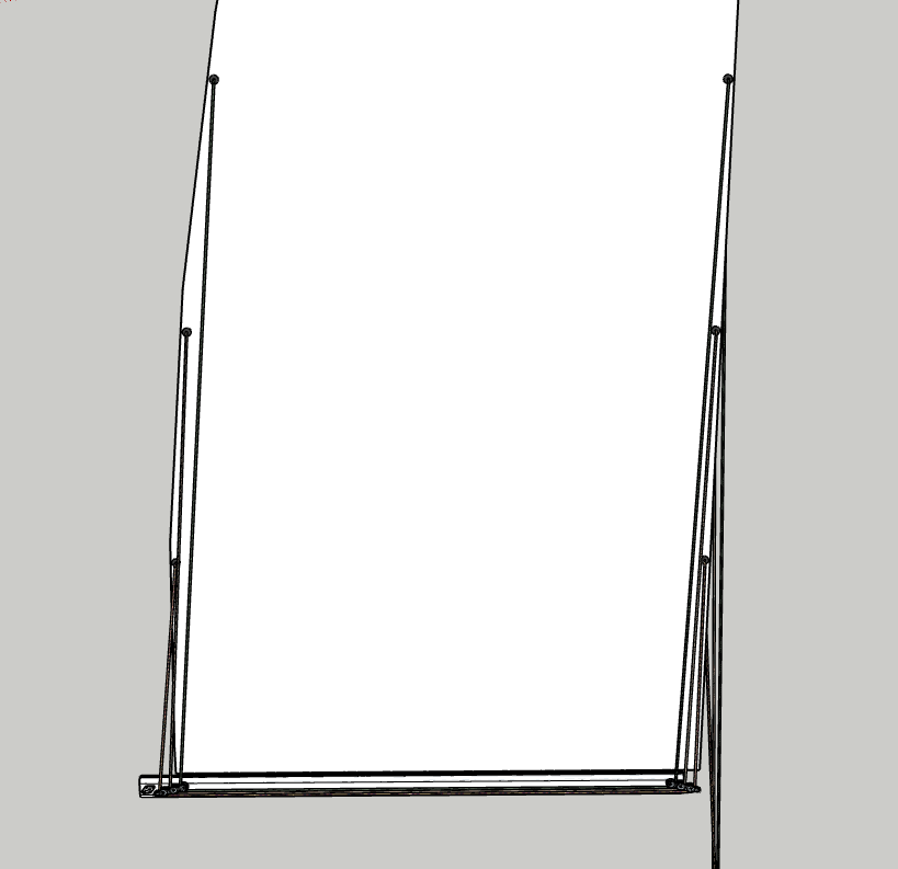

    Not as easy as I thought. It looks like a cantelever with a diminishing load but there is also torque (rotation) due to force on the sail at a distance away from the mast. This makes it a compound load (combined load formula). There is tensile, compression, and shear.
    The shape of the boom is definitely tapered and open on one side but has a fixed cap on both ends to hold the furling mechanism. To idealize the section and find N.A., this needs integration of areas.
    Further, the boom is supported by a vang, making the effective length smaller. So diminishing load + support. This requires superposition method to calculate strength and flex.

    On second thought, the open end of the boom will close when the bottom is subjected to tensile. Am I correct?

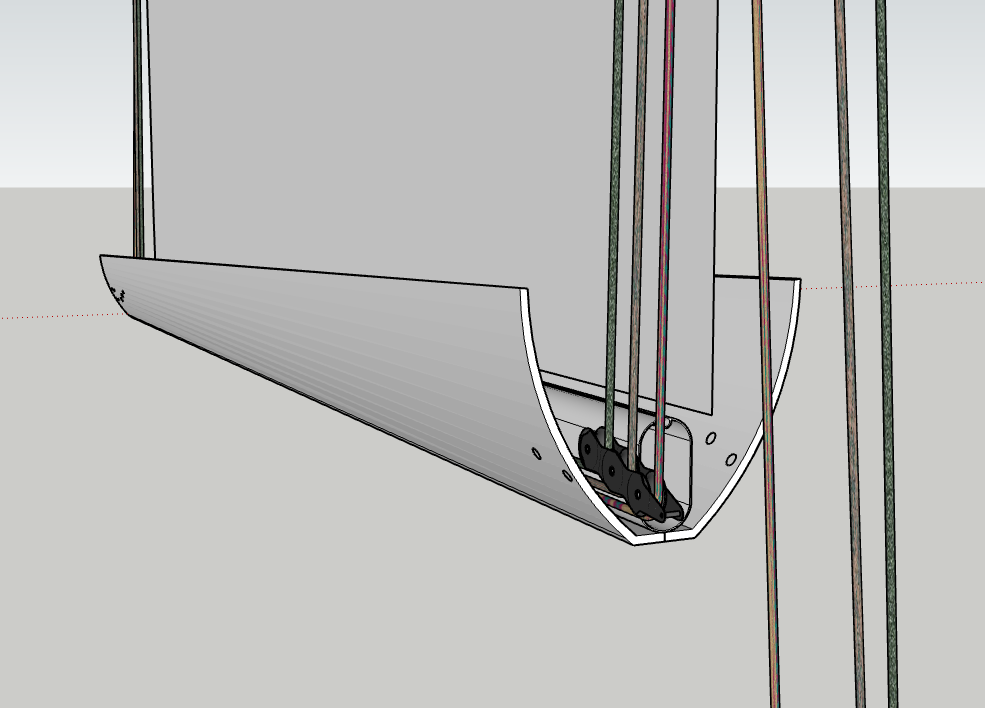

    Can't comment on the engineering, but as far as fabrication, it wouldn't be too complex to first mold the U-shape boom, then add an inner layer to create the partial box. You could fill the cavity with an extremely light foam, or bond in a rigid piece and vac bag more fabric over the joint

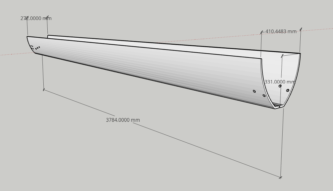

    I think you are right in that the best way to approach this is by just creating a closed section with non-structural wings forming an open cradle for the mainsail. After reading everyone's input, I agree that a fully open section in cored composite is probably too complicated, especially given my limited engineering abilities.
    Also, I reached out to GMT Composites for more information. They estimate a pocket boom for my boat would weigh ~68 kg (150 lbs)! This is almost 5x heavier than my initial design, implying that the skins must be >3x thicker.
    1) 68 kg is just too heavy to even consider, the current aluminum boom is ~20 kg (44 lbs).
    2) Making the carbon laminate 3-4x thicker would bring the cost of carbon from ~$800 to ~$2600, plus a lot more resin ($$$).
    A much more reasonable option would be to clean up the old boom and add a lightweight cradle section to the top. This wouldn't require any critical structural changes, would only add about 6-7 kg (15 lbs), and only cost about $500 in materials.
    It won't look as good but it will be more functional and still give me confidence in the end product.

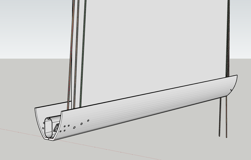

    I agree, a closed section and open box would be relatively straightforward to build. Probably the easiest would be to shape the closed section in foam and wrap the laminate around it, then build the open section from a simple mold, bond and tape the two sections together. However, this will not be cheap, as the closed section laminate will need to be pretty thick, adding weight and material cost. It would certainly look a lot better but at the end of the day, I can't justify spending thousands on this project.

    I have run similar calculations before and the problem with this structure is rigidity. The problem associated with this is not strength but rigidity. To approximate the rigidness of aluminum alloy, it has to be made up of carbon fiber, prepreg, filament winding, or infusion. Hand lay up has too low modulus. Wet bagging is barely passable. Cross sectional shape also plays a part. Open channel will not work. should be rectangular or hexagonal with just a slot.

    I think the force distribution should be higher at the clew. The tension on the luff should be higher than that at the center.

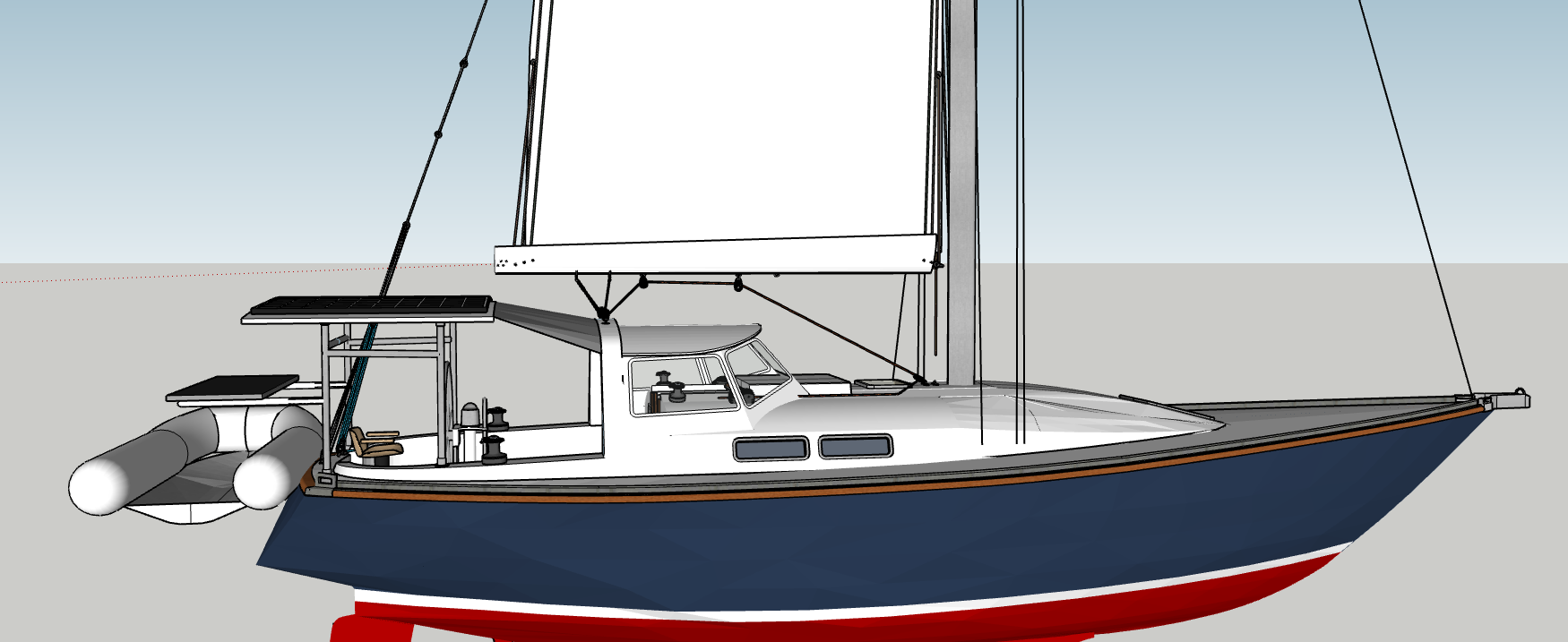

    Updating this thread with my latest design. It keeps the original boom in place but adds a much lighter cored composite sail cradle mounted from the bottom. I like this design for two main reasons: 1) provides much better support for the sail than a sail bag and 2) hides all the loose reefing lines while sailing. I stripped off about 13 lbs of unnecessary hardware while reconditioning the boom. The cradle will weigh ~14-17lbs and then an additional 3.5 lbs of hardware will go back on. So all in, I'll only be adding 4-5 lbs.
    The cradle will be made from 1/2 inch divinycell and single skins of 12 oz biaxial e glass. I haven't done much for calculations with this configuration because the original boom is still the main structural component. The cradle is only supporting the weight of the sail when lowering. This laminate schedule and core dimension should be plenty just based off of my personal experience working with these materials.
    Let me know your thoughts.
