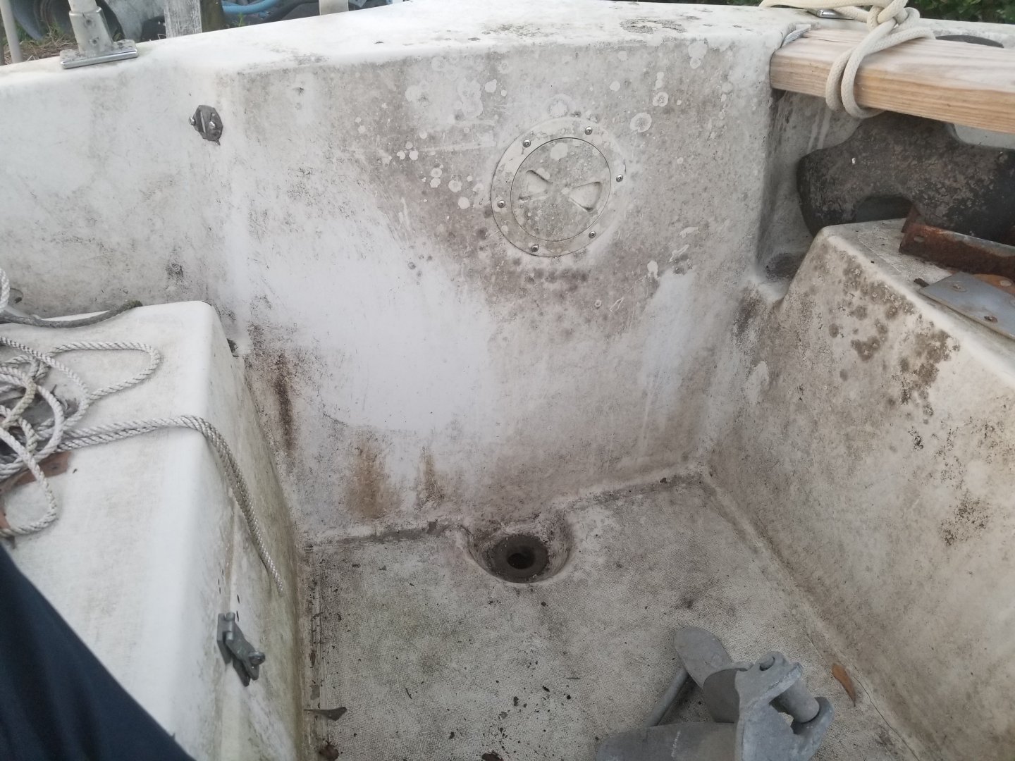

    New here and new to sailboats, so please let me know if I'm not in the right place.
    I'm working on a Reinell 22 restoration project, concentrating first on seaworthiness. One of my biggest concerns is the cockpit self-bailing system. The designer has a single drain in the center of the aft sole of the cockpit, connected by a 1-1/2" hose to a thru-hull in the (full) transom. I'm not sure if it was/is a scupper with a flap or just a plain thru-hull, but it is at the lowest point on the transom - well below the waterline.
    Common sense backed up by just a little bit of reading tell me this is a very bad idea. I'm thinking if it stays there, it should have a seacock and/or a ball valve before the hose section. The flap-type scuppers I'm seeing say they're not for use below the waterline.
    I prefer the idea of glassing it up and installing at least two scuppers at the level of the sole, which is just a few inches above the waterline. There is about a 4-inch gap between the cockpit aft wall and the transom, so I'm assuming it would need a flexible connection between the two to prevent cracking.
    This is definitely NOT a blue water boat, so I'm more concerned about a hose leaking than I am about the cockpit being swamped. Am I overthinking this?

    MT, does your boat live afloat, or do you keep her ashore when not using her?
    If you have any photos that you can post of your cockpit, and of the current drainage system, that would be useful.
    I can see your train of thought, re how it would be better to have the drain exiting above the waterline - and having two drains will drain the cockpit much faster than one if you get a big wave landing in the cockpit. Have you ever been out in conditions where this could have been a possibility?
    On the other hand, if the section of hose is in good condition, and ideally has two S/S hose clamps (in good condition) securing the hose at each end, then the odds of the hose spontaneously failing while you are out sailing must be extremely unlikely.

    After closer inspection, it turns out the cockpit sole is maybe 2" above the waterline - if the paint line is to be believed anyway. So after the sump and the 90d fitting, the hose would still be below the WL.
    Yes, it will be a tight fit, but I can reach over from the port quarter berth, which goes all the way back.
    Here's the requested pictures. I obviously haven't cleaned the boat up yet.
    Thanks again for the help.

    Thank you for the photos MT - I think that she does look like a suitable candidate for installing a pair of drains going straight out through the transom, above the waterline - no worries then about a hole in the hull below the waterline, and you get an added bonus of being able to drain the cockpit twice as fast with two drains rather than one, if a wave dumps into the cockpit. .
