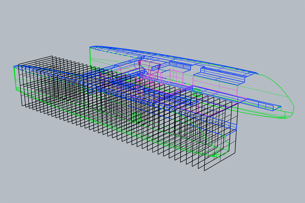

  12. jorgepease
    Joined: Feb 2012
    Posts: 1,620
    Likes: 51, Points: 48, Legacy Rep: 75
    Location: Florida
    jorgepease Senior Member
    I know this isn't the finished design but it's probably not too far off... Pretty simple!
    The rest of the boat is dead flat with only tapered lines. I would consider this very basic carpentry skills, especially with CNC. Where care needs to be taken is in laminating the sheathing to make sure it's not flattening out, that takes a bit more skill. Spring-Back on sheathing is not a problem, cinch it a bit and set sections in place bolting from the middle out while releasing cinch straps.
    I am still thinking this through but I have a feeling that the mold stations should be done in three pieces. What I hope to learn tomorrow at Contender Boats is a little bit about their hoist systems and assembly line. My mold would get in the way of a travel hoist (if by luck I can find a boatyard with such a monster hoist) and if I don't have a trolley lift, then a 3 segment mold station could come in handy because I could pop the mold, not the boat. A simple setup using counter seam clamps like these but with interconnecting tabs would hold station molds together. Dowels might also be in order ...
    The battens are full length ply with puzzle joints and slightly notched. I would either make elongated holes to allow for easier alignment to an insert in mold station or clip system the same for the sheathing.
    The final structure is rigidly locked together.
    This takes a lot of planning but the fabrication is efficient and when ready to use ... I could assemble a full mold using this system in about one week with two helpers. I am talking bout the base assembly, both hulls and bridgedeck fully sheathed and caulked and taped and that mold would be very strong, just not something you would want to be slinging around with a crane.
    it's not as good as a conventional mold but with care it should withstand an indefinite number of pulls and if anything is damaged it's pretty easy to replace.
  13. groper
    Joined: Jun 2011
    Posts: 2,506
    Likes: 174, Points: 73, Legacy Rep: 693
    Location: australia
    groper Senior Member
    ah man your just not getting it - assembling the mold isn't where the time goes - 90% of the time and effort goes into achieving the mirror finish! any boat builder or carpenter can strip plank a hull or a mold over some CNC stations. A 40ft catamaran hull only takes a week to strip plank by the same guy who takes 3 years to finish the entire boat.
    Achieving the mirror finish takes multiple passes of, bogging and sanding, priming and sanding, priming and sanding, before finally painting. Every join on every sheet of material you use requires filling and feathering. The difference in thickness between sheets is required to be only a couple of thou - otherwise the gloss finish in the part you pull will show it up like dogs balls.
    Before you go any further - I urge you to test your theory. Go ahead and make a mold for something and then infuse something in it. will it hold together when you try to move it around? what if you have to lift it with a gantry crane - does it all fall apart and crack etc? So now what - are you going to rent such a huge warehouse that you don't need to move all your molds around, everything is laid out like mulitiplast factory in france? common man - you don't have the budget for that kind of contruction methodology...
    Ive done this stuff before and my molds were usually destroyed removing the part because they were not proper molds designed to last more than 1 pull. The taping would get pulled out of the joins, the paint would peel off, you name it it happened. You need to build the molds very well - just like the boat itself - if you want it to last and that takes time and money which could be spent on building your boat. Remember you only have a few more good years left in you - would you rather be out sailing or grinding glass?
    My brother has decided he wants to go halves in a yacht with me - so were off to Croatia to buy a yacht :) Ill drop buy florida on our way back and say hi - I hope your not upto your knees in sawdust when I get there, id rather raft up to your boat in the bay and have a beer instead...

  15. jorgepease
    Joined: Feb 2012
    Posts: 1,620
    Location: Florida
    Brian, it's direct to female. Part geometry is extremely simple and I am using CNC. I have looked at all the ones in that area that stated they allow DIY work. Their prices are for painting the bottom or minor repairs and maint, building a boat is going to be a lot more expensive and they have lot's of rules such as I can't block the boat, re-block, hoist, use my own scaffolding and on and on which I fully understand so a boat yard is not my ideal choice.
    Skip, there is no fairing. all the sheathing is laminated with cabinet laminate. I have already tested this, it separates easy, it's too glossy to paint without scuffing, it's a glossier finish than melamine. Now if I wanted a mirror finish I could probably polish it up to that but I am not gelcoating, going to have to scuff it anyway.
    Not sure what you mean about different thickness, once the sheathing gets laid down it's bogged between joints and sanded. When the laminate goes down, we are talking about 30 thousands thick without deviations, I still leave a gap for vacuum proofing (say .125 in) which gets bogged and sanded and then taped. If there is anything to see it will be the tape line but who cares, I still have to scuff it up which will remove that line. I am going for a very high finish so we will spray some sanding primer and sand that out to a high grit, followed by paint and several coats of clear.
    I know the molds can't be moved, I stated that. You assemble, load, infuse, disassemble. I wish I could build the mold and leave it but you are right, I don't have that kind of budget. Having the molds dismantled will make it easier to store and truck, it's a bit more work, not terrible.
