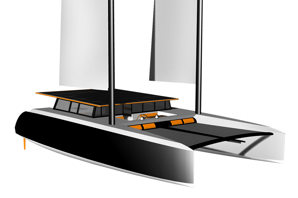

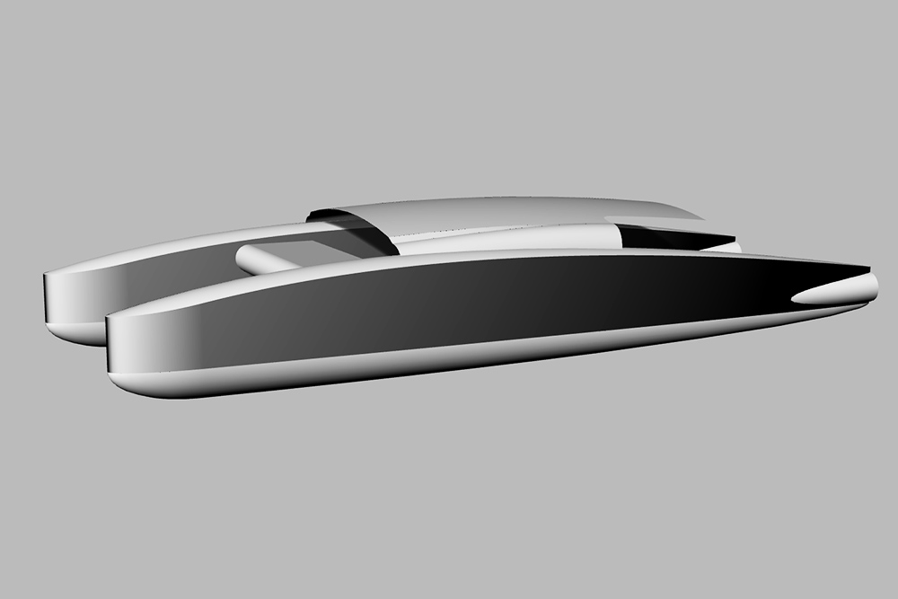

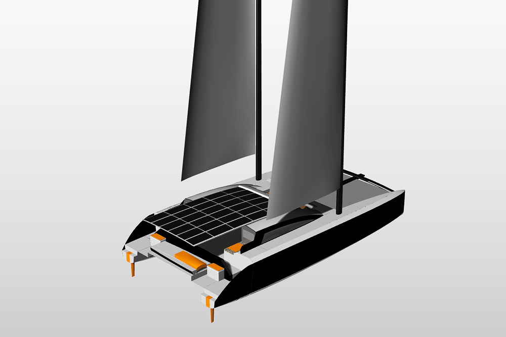

    I'd say I'm excited but I'm always excited when I make an improvement lol!!
    My last design the roof was radical looking, I like that Lambo look but it was too much. I studied the SIG 60 roof and it's got a more severe bend up front and levels out going back. I tried that on mine including inclining down on each level to give less side profile and I think it worked!!!!!!!
    Also, forgot to mention I added the taper to the top of the hulls and lifted them 6 inches. The result is the hulls look no taller, they actually look narrower and I could raise my interior floor so the wing bunks are back at 36" height and I can re-explore the option of sticking the batteries under the floor!!
    Sad that I didn't start with yacht design when my uncle offered me a job and to send me to NA school 40 years ago!!!!!!!!!

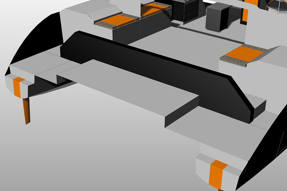

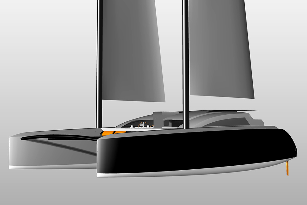

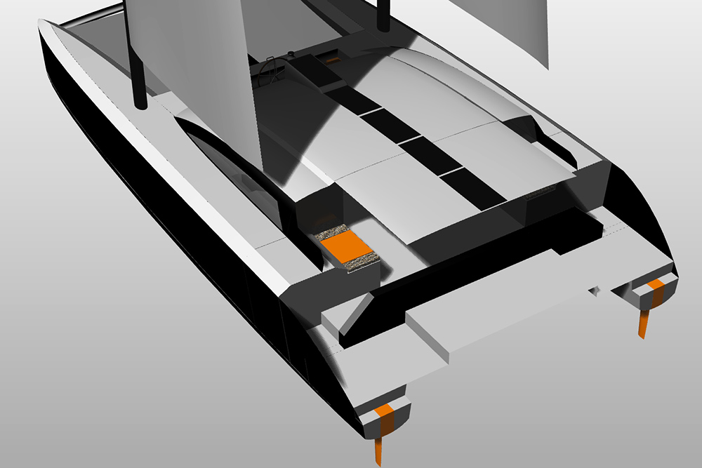

    I don't know how I will get the dinghy up there but I have a good fish cleaning station!!

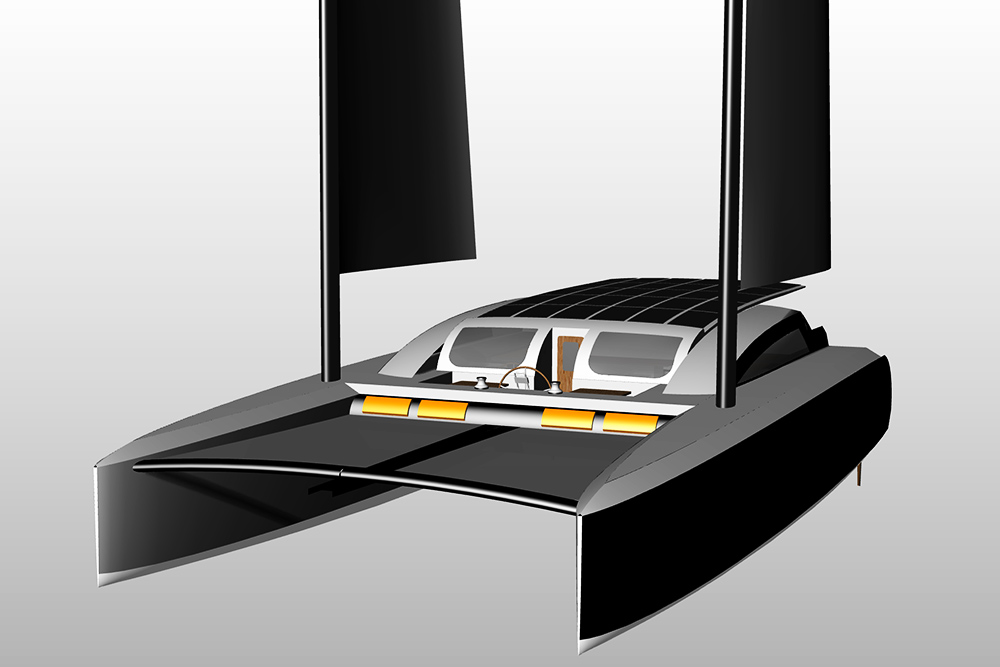

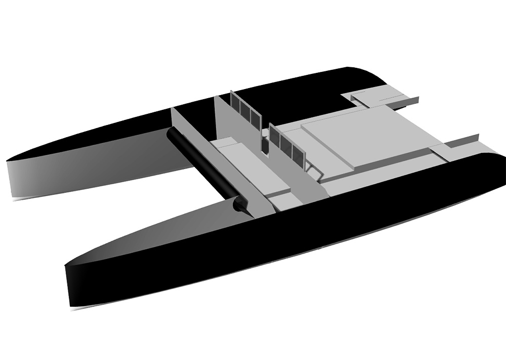

    Blocked off in front, I think it's safer, last thing I need is a wave to break on me and ruin my nice induction oven! Got 30 solar panels fitted, that's gonna be it. Big fishing or deck boxes in back, seen how people tackle the fish on decks, not me, gaf them and swing them right into the cooler in one quick move, need to add fish cutting table and a wash down ... Nice eating tables in front cockpit, haven't figured out where to put the interior table but likely it will be a foldaway. This design adds some weight with the windows but I lost some on the decks, don't think it will be much of a difference.

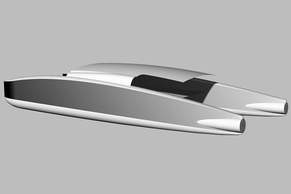

    Played around with a vintage look and an idea of making the forward hull more buoyant than aft but I don't think she will drag. I don't know why I think that shape is better, maybe because most swimming things seem to be shaped that way but I am not pursing it, was just for fun ...

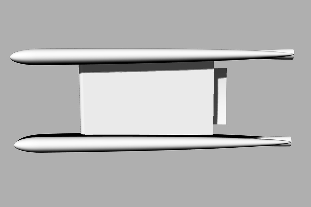

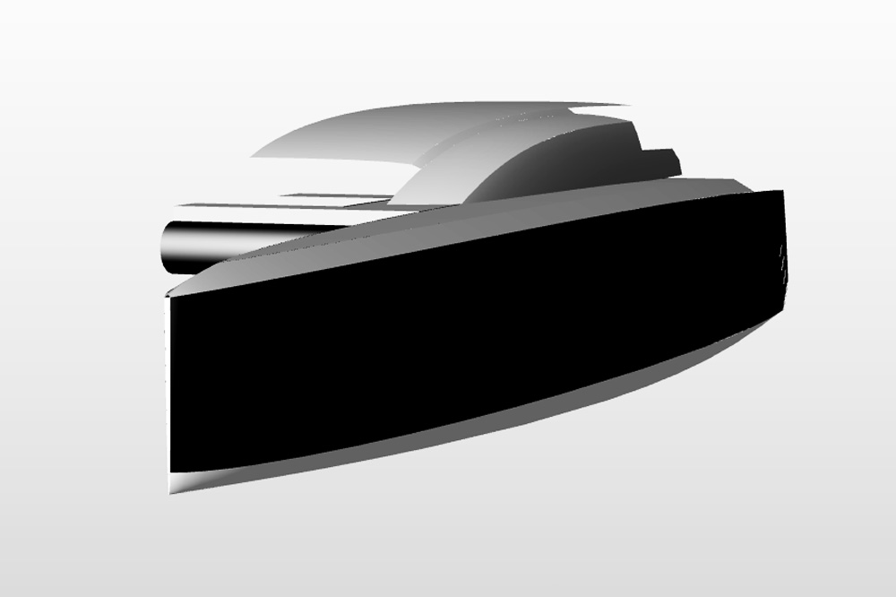

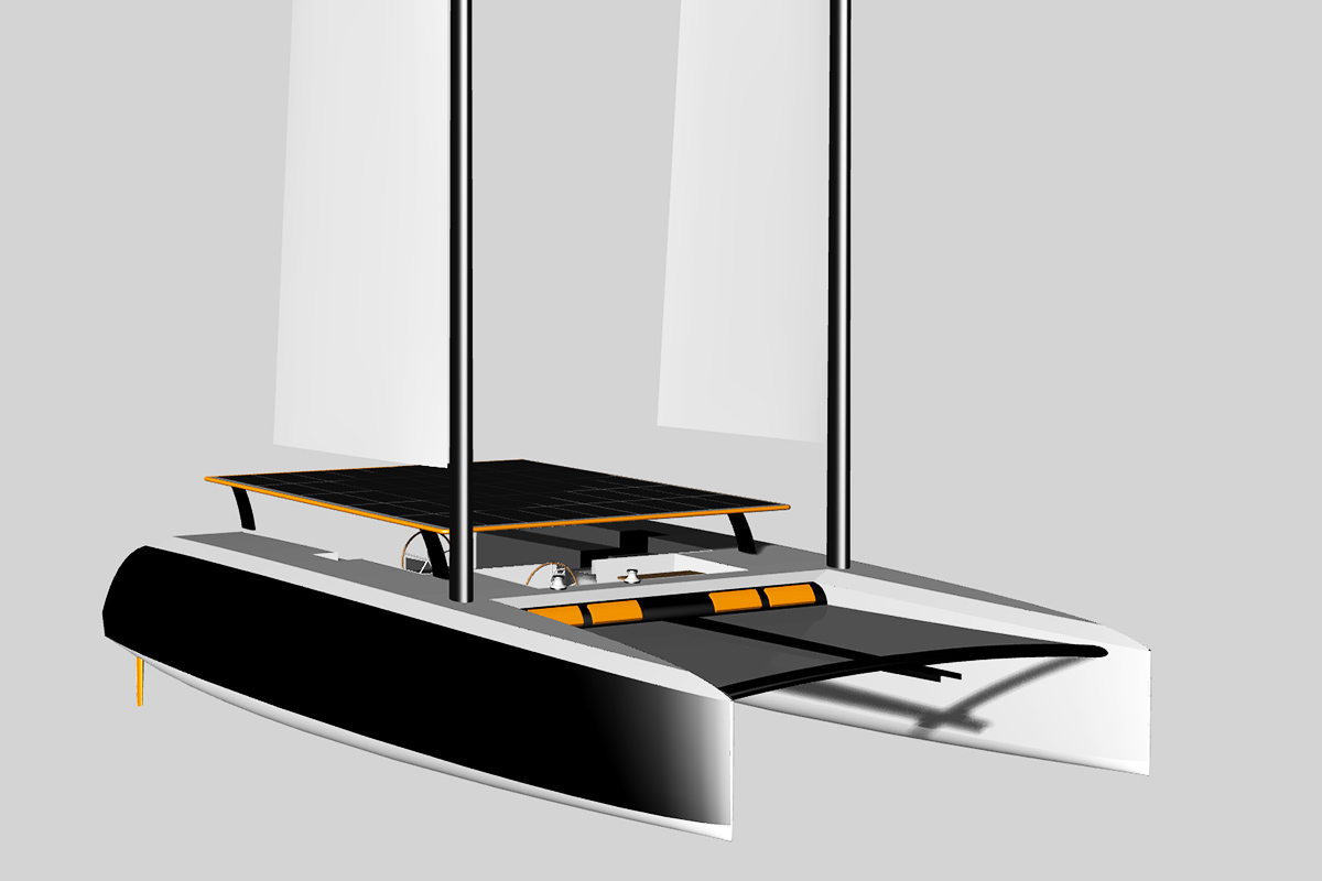

    The race car streamlined look didn't go down as well as I thought it might. I shopped it around and people prefer the flat roof.
    Here is the flat roof, without the windbreak and lowered. I kept the front cockpit helm/eating area and the aft fishing platform and put
    a second helm under the roof.
    For kicks I drew up the molds to see how hard they would be to build, pretty simple and with two molds I build almost every
    supporting surface on the boat. The bulkheads fill in most other surfaces so only a few extra panels are needed. Grey is for cutouts
    and red is extras. I wouldn't glass over the grey areas, it just simplifies mold construction to leave them in and I get an already laid out
    canvas to expedite the custom work. Cutouts for cabinets, windows etc .... not shown.

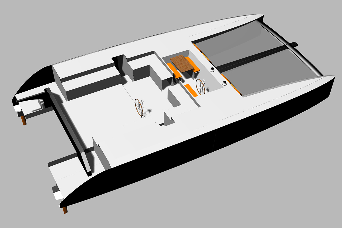

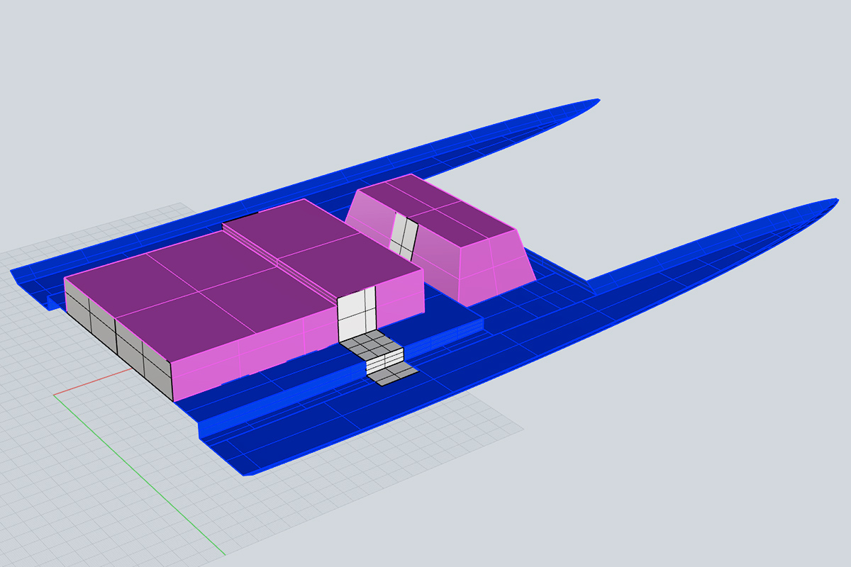

    Another big time saver, support the roof and create the frame for the fold down windows out of the bulkhead! Working my way back to see where else I can support the roof and take advantage of the bulkheads that traverse.
    One area that I know is going to be a problem is around the cutout for stairs leading into hulls, I have to block rain from getting in there on days when I don't want to roll down the sides or shut the door.

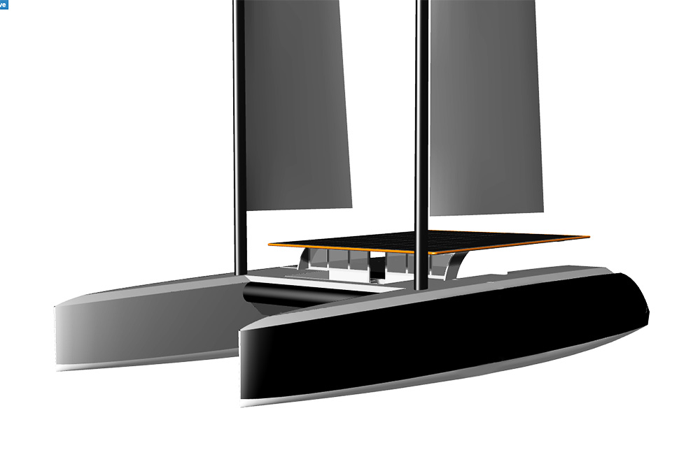

    The idea of using bulkheads to support the roof is ok but not thought through. Much better idea to create one more mold for the roof supporting structure. This is the lowest the roof has been at the cost of BD clearance but I still have over a meter. That makes three major molds to create the shell.

    Jorge - all of the australian designers that use 3D modelling to create their designs, do not suggest building molds for 1 off boat builds despite it being a simple process to offer the mold making materials as a CNC cut kit. There's reasons for this - it would be prudent for you to investigate why.
    Id also do thorough budget on this boat as its looking extremely expensive to my eye. If you only have $400k - forget it, youll never get it over the line and end up like so mamy others with a 3/4 finished boat and put it up for sale at pennies on the dollar 5 years later when the monies all dried up... seen countless examples of this, dont be one of them...
  9. jorgepease
