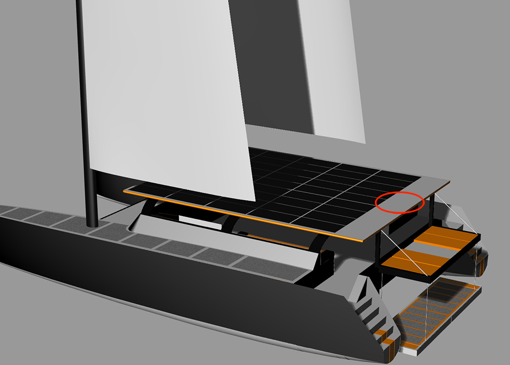

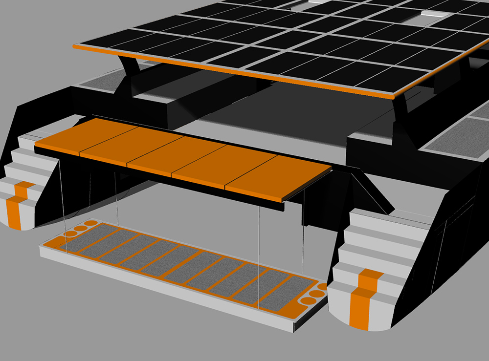

    Yeah, the tender would be under the platform actually. So you would drop it till the boat hits, release the davit drops and then lower it the rest of the way to act as a swim platform, not very elegant.
    The other way, I think might work. You just lower - by cable - one big platform. Then you don't need swinging davits to accommodate different sized tenders. The platform would have to be stayed to keep it from swinging back and forth but that is not a big deal. If you plan on scuba diving, I would load the tanks on the platform first. If I went that route I would remove the sidewalls on the transom steps so you could just use those to get back up.
    On my boat the platform would be 20' long. Good for a couple of lounges and an umbrella )) ... here is where those super lightweight carbon trusses would come in handy )) ... however there would be other issues such as the darn cable being in the way etc...
    I am going to keep browsing and see who has the nicest solution. Fountain Pajot solution ... I guess they put the tender on the roof?

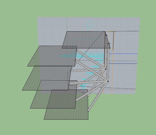

    Something that looks like this?

    That is what I was thinking at first. How would you do that while keeping it light? I couldn't figure out the lines
    Meanwhile I went further on my simple hoisted platform. The wings on the end could be a tank rack. Makes it easier and safer to place the tanks on the platform in the up position while leaning against the rear bulkhead. There is about 6 foot 3 inches of headroom. Maximum tender width would be 5 feet.

    I think that would work once when going down. As soon as you reverse direction on the arm and then try to lift, it's going to bind.
    I could move the lines closer to center but 4 lines and a truss platform would be pretty robust. I could put the tanks in the tender actually, just make a hatch in the top platform, that would let me make a smaller platform but I think the idea was to be able to access the steps as well.
    it's just under 14' span between lines. Once up it could be locked in place.

    Too busy for graphics but you want scuba racks. Good, as these will need to be strongly constructed.
    They sit between the tender and the aft beam and their tops take the pivots for a pair of parallelogram arms that
    keep the platform level as it swings. Binding can be avoided by moving the top hoist point aft slightly.

    Not scuba racks for storage, they are way too out in the open back there. Just a good way to lower them down instead of carrying down the steps.

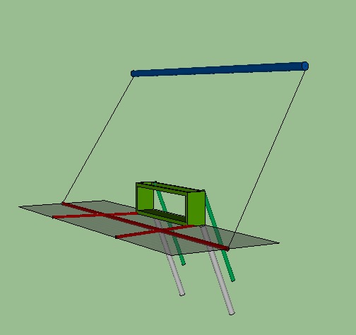

    to secure the bottles as you lower the platform I think you would still need some robust rack system.
    Here is one image. The platform has been lowered by about 10 degrees just so the arms are clear.
    The lift lines attached to the main strength beam that carries the tender. This centers the load and balances the platform so loads on the arms are lower.
    One problem is that get enough "drop" to reach the water the platform basically is flush with the top of the aft beam.

    UOS that system might work. Want to see how high that puts the tender on my design, though it might be strapped to the bottom. I think radar etc... would have to be off the rear of roof.
    To control sails, it seems there needs to be a line run down the sides of the roof in which case it could lead back to the position I highlighted.

    Good idea. slinging the tender under the platform means the lifting points can directly fall in line with the loads and the tender can launched with the platform up.
    Much much lighter platform seems possible.
