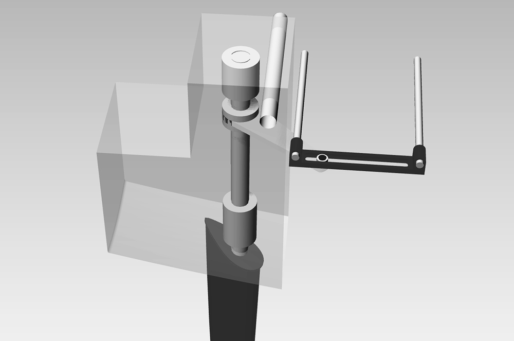

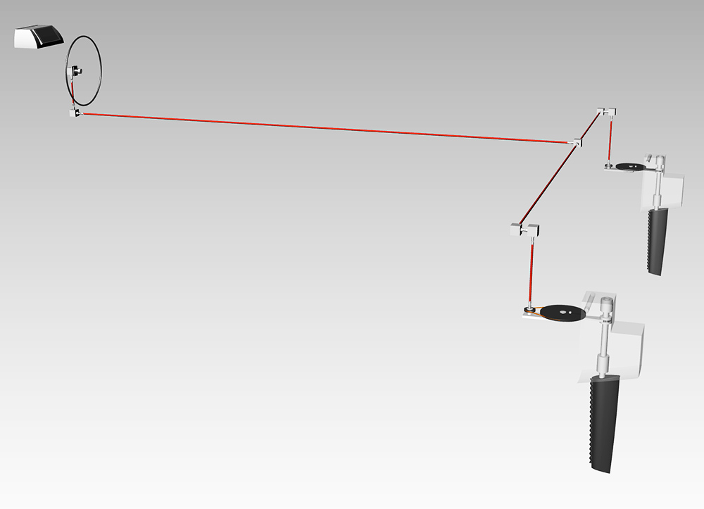

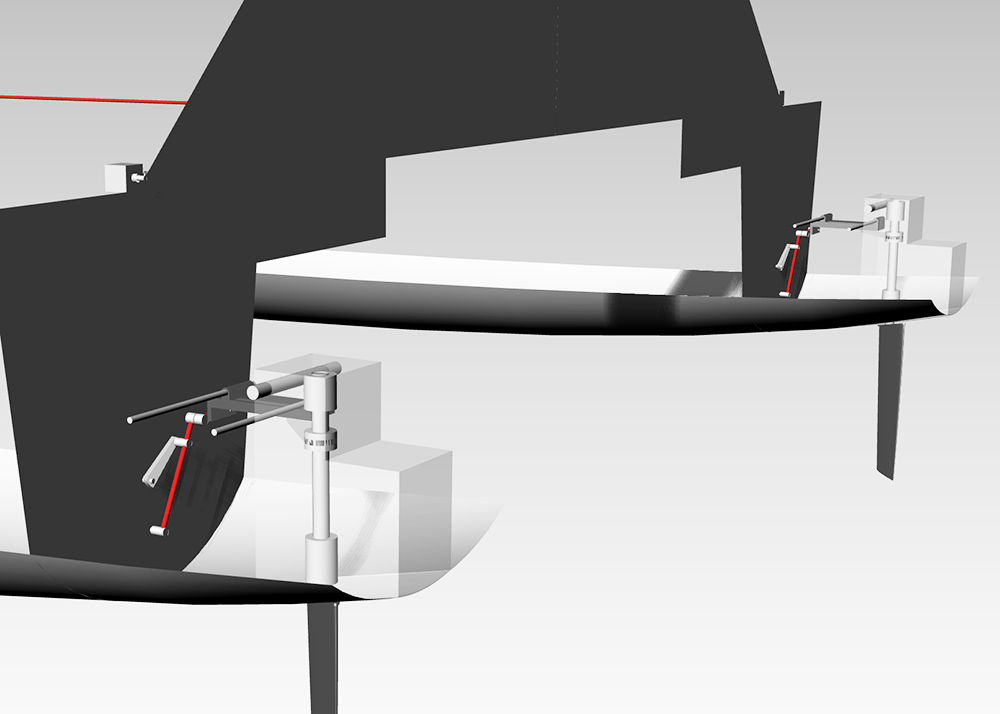

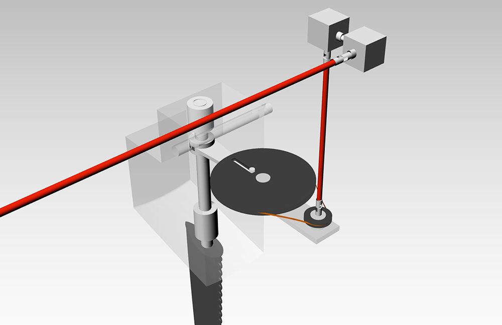

    In your system, if the rudder is turned anyway but straight, something is going to snap. Also the pivot needs to be forward or the rotation of travel is going to drive the rudder down instead of back and up.
    In mine that won't happen and it's much stronger, I don't understand your comments at all. Plus with a sacrificial nylon bushing you would have extra clearance for easy release at any angle.
    Additional benefit is the drive wheel reduces the load on the entire system. For now I have it running on top of my deck as I have to make that deck thicker anyway. In which case I would leave access panels and a way to extract the shaft. Alternatively I could just put it under the deck and cover it with a cowling of sorts.

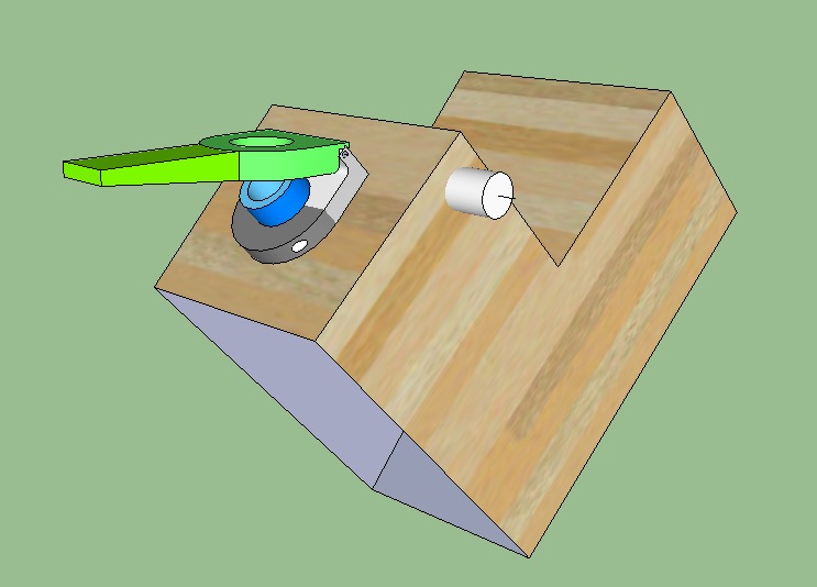

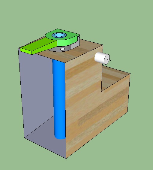

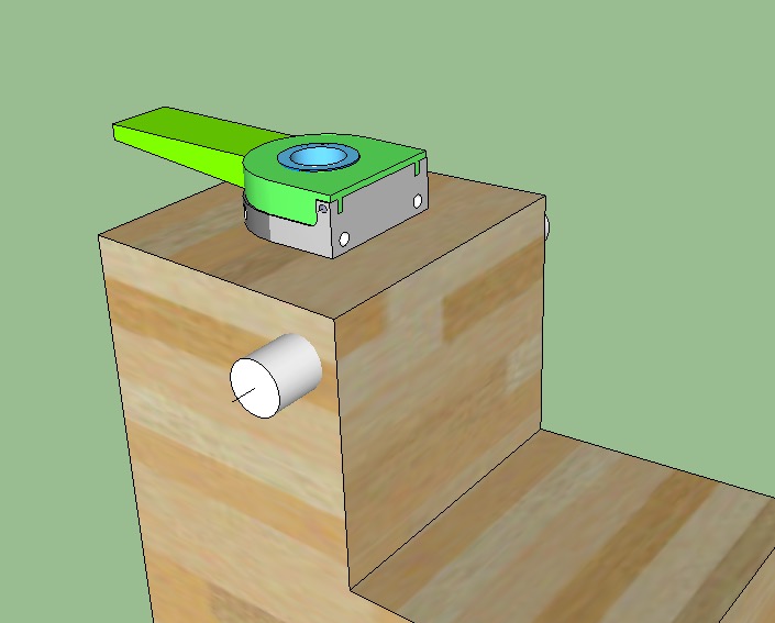

    This wheel is far more stable but, binding. Turn your rudder 40 degrees and the drive wheel to match. Then look at the forces on the sides of the slot - they seem to be extremely small as regards turning the rudder back to center. But move your model and see what you come up with.
    Yeah, cassette pivot on mine should be fwd of the rudder stock. But what I wanted to show was an alternative to the system shown in daycharter thread where the tiller is simply pivoted on a bolt that passes through the rudder stock. Very simple, but wear and tear would make the steering very sloppy.
    Have to look at how to accommodate kickup with appreciable rudder angle but for 99% of the time the kickup would used for beaching/drying out. Rudders can be centered.

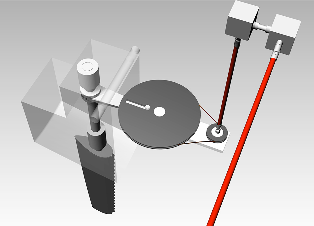

    I think most people had 40-45 foot cruisers in the one big thread on the cruiser forums. Though, I am hoping my boat comes in under 10 tons and is exciting to sail, the truth is I don't really care about feedback steering. I can get feedback in many other ways. Surely hydraulic is cheaper too? I should inquire from Jefa.
    UOS is right about the binding when rudder is all the way over and kicks out. I think a push pull system is the better way to do it so the slot stays parallel to the exit path.

    Okay here is the revised steering ... if it's even worth it ... It really would be on auto pilot 99% of the time and when I am motoring in the shallows or marina, the rudders would be up or locked straight.
    The corrected drawing keeps the slot parallel and allows enough extra space to accommodate the pivot ark at any angle. The nylon bushing makes it an easy slip without binding. I think the push and pull can be gotten direct from the bevel box using their drag arms.

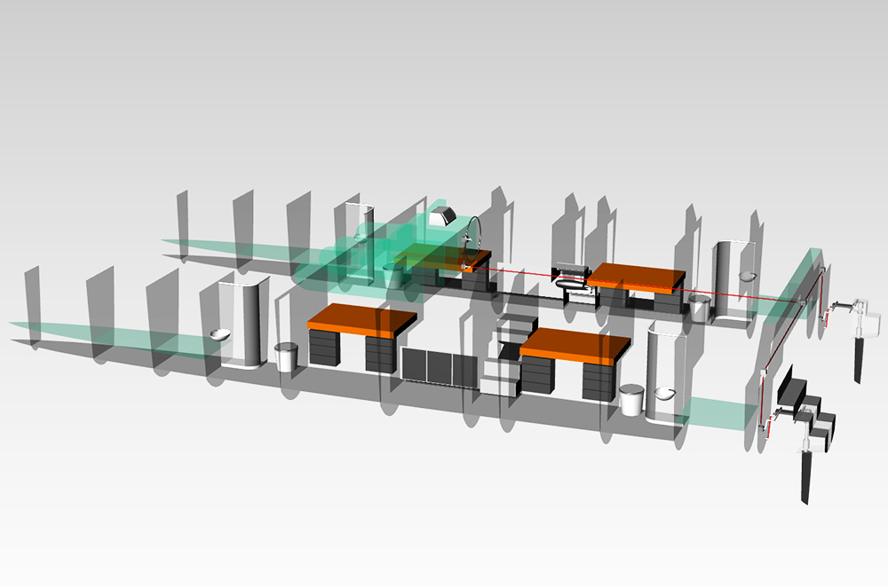

    Think I have all the bulkheads and watertight compartments accounted for. Decks are complete except for stiffners and upper bridgedeck (if I go that route). I think it's enough to start the weight estimate, so tomorrow I will start that.
