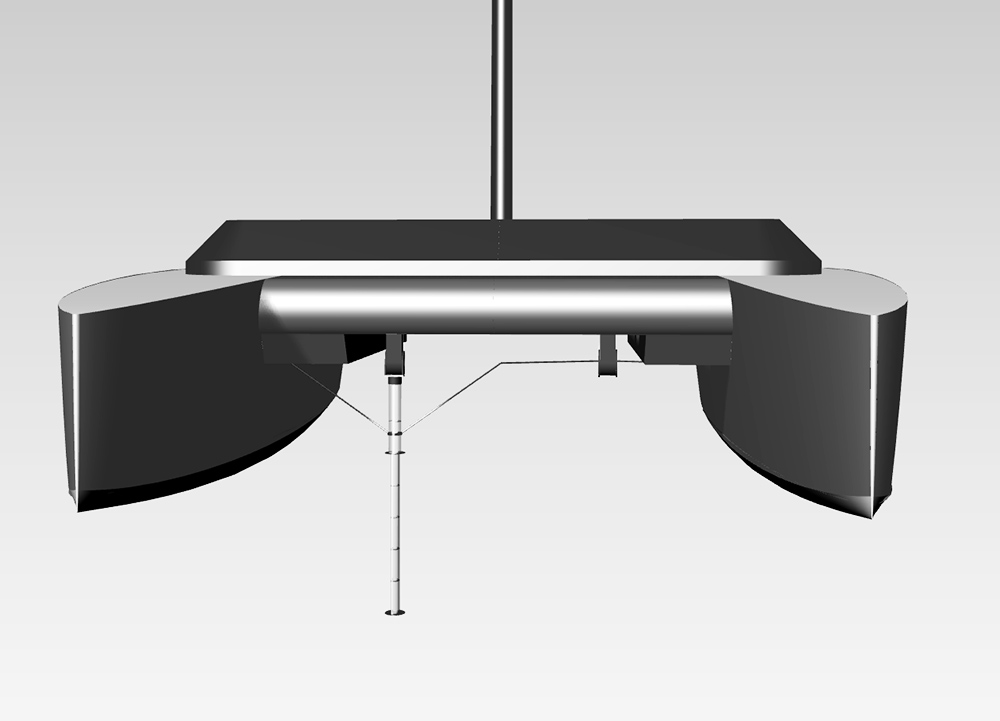

    I realize now why slats are impractical, they make perfect weed catchers. :)

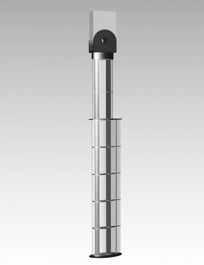

    Okay back to simple, no rotation, two asymmetrical boards one on each side. Need a tripod or mini nacelle for the middle stay to anchor to. The pivot blocks I will shoot at the same time as everything else. Moving on to rudders.

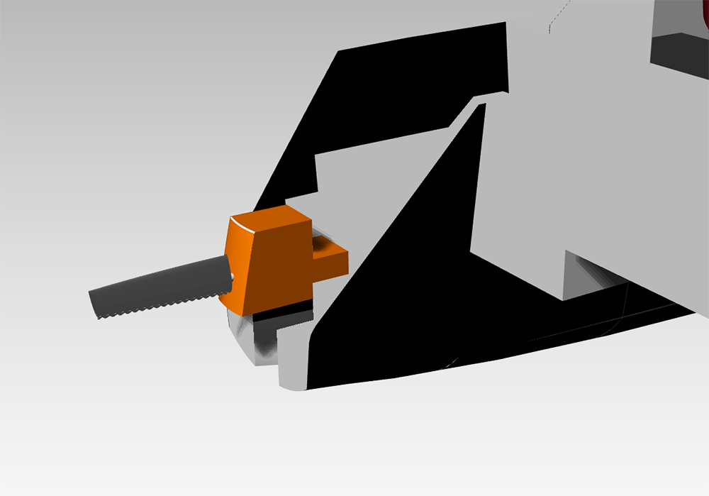

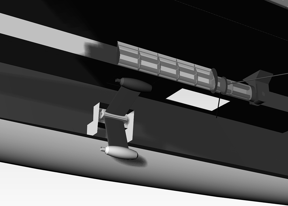

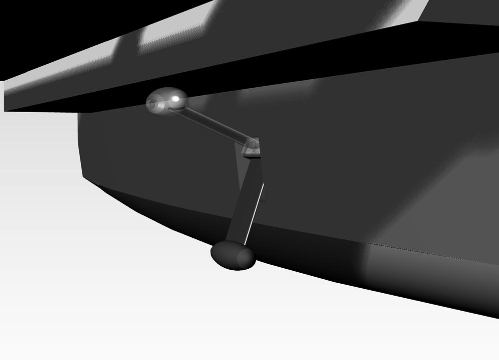

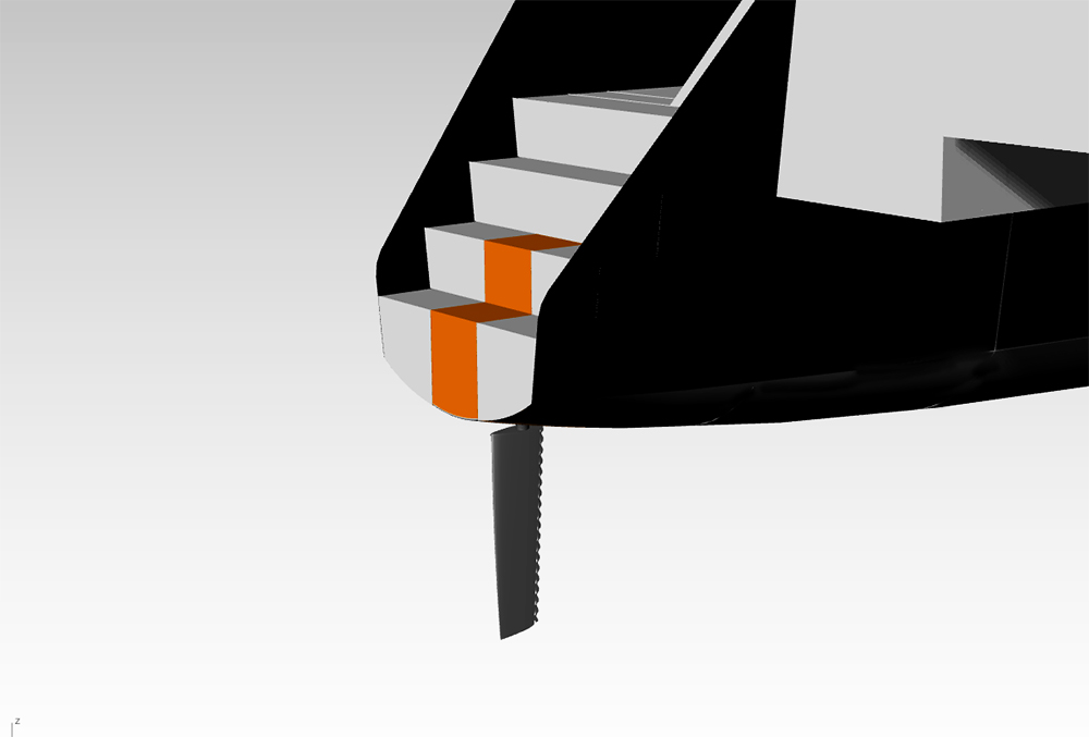

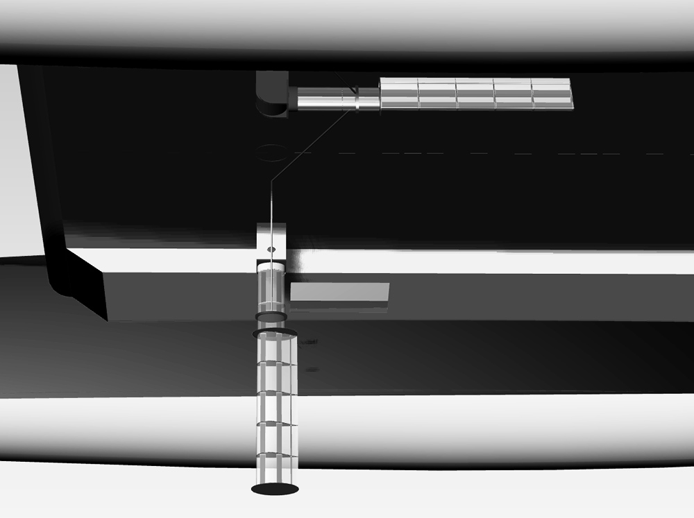

    Didn't like my drives hanging down like that. Thanks to 3D I was able to see that I can scallop a V out of the hull under the steps. So I think I will do that in the mold stage. On the outer hull I will fill it to be a V so the motor is steadied. The power cord will run through the pivot into the hull, it's pretty far above the water line so I don't see any problem with that. When you want to lower, it's at the right angle to just let out on the line but it will need a downline, probably looped to the upline, to hold it when running.
    That frees up that shelf area for either a pantry or more batteries. I'm figuring maximum one ton of batteries but they can be made in different configurations, so I am hoping they will go under the interior deck. That ought to keep my balance pretty nice as well.
    Edit- Here is a better pic with a cutout though it would be V'd not blocked like here. The cutout provides bracing for the pod extension, this is much stronger! I'm excited because it's all pretty easy to build into the mold so makes my job even easier and frees up space. The only potential issue which is easy to fix, that I see, is when up there is a flat spot that could cause wave slap... So on the leading edge I will build a little ridge to deflect water.

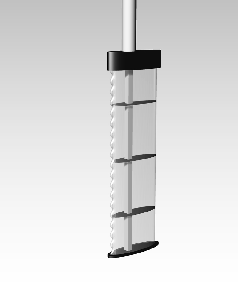

    WhalePower Tubercles :)
    Idea comes from the flippers of a whale and I quote
    In wind tunnel and water tunnel studies, tubercle blades easily overcome fluid dynamic “limitations” that were once considered unavoidable laws by engineers, technicians and scientists.
    The leading edge bumps cause vortexes which keep flow attached WITHOUT DRAG. ... Sent them a letter. Currently the tech has been licensed for computer fans, giant industrial fans and wind generator blades. I can see this working for rudders, daggers and masts even!

    UpOnStands Senior Member
    umm, well yes, if you replace a smooth foil that is just stalling (factors are angle of attack, Reynolds number, profile, surface finish) with a bump foil, you will see a significant reduction in drag and improvement in lift as it is no longer stalling. Rudders are the most suitable application as they are required to have minimal stalling as stalling = loss of boat control. Unfortunately the tubercles will be weed and bag magnets. It seems that when operating at low angles of attack the tubercles provide no reduction in drag.
    Possible that tapered foils may benefit as well. The taper is likely to suffer tip stall and the tubercles might delay the stall. might. The humpback has tubercles right to very end of the flipper so likely to be useful.

    For sure a lot of testing must be done but If a smooth foil is stalling at 10 degrees that is a problem. These foils don't stall even to 30 degrees which means I am too curious not to test them. :)
    When I am not selling boats I could be selling daggerboards and rudders lol
    The slats would have been like mowing the lawn but these are rounded and smooth, I don't think there would be any difference from a smooth foil. Once again needs to be tested.

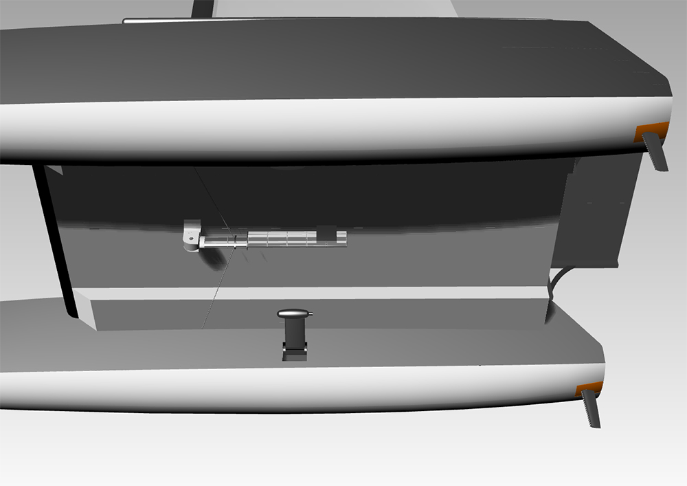

    Decided to go with sort of a standard rudder install. Can't figure out how I would connect this unless I use hydraulic. I'm not giving up ... thinking it would be possible to use direct transmission if the linkage could be fused to allow the steering arm to pivot down when rudder kicks up.
    Also went back to a single symmetrical daggerboard.
    My raw water intakes will through-hull above the waterline. Kind of like the drives, a scallop in the hull will allow the hose extension to be run below the waterline. I like this, nothing in the water to foul or holes below waterline that could sink the boat.
    Had a good idea for some lightning protection. Thinking that some big fat cables fastened to the bottom of the mast could be dropped into the water to give lighting a good path to ground ... will make me feel better anyway!!
