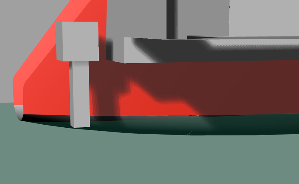

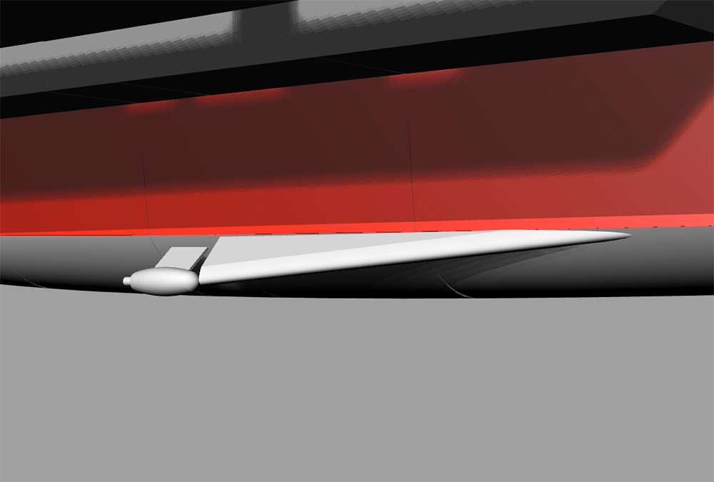

    Added the daggers and rudders for look, they aren't to scale as I don't know what the scale should be but they are close and fit. Daggers are just aft of the mast.
    Not giving up on unstayed masts yet. Lot's of info out there on this and I have to decide between pure performance or so many other benefits such as a smaller main mast beam which would let me have direct access to front of boat.
    My roof is now shaped in the most streamlined shape to reduce drag as per the graphic above.

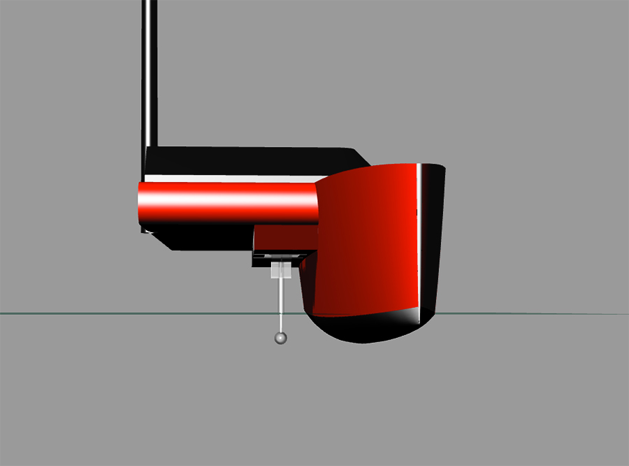

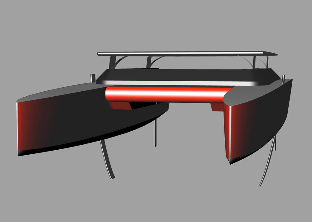

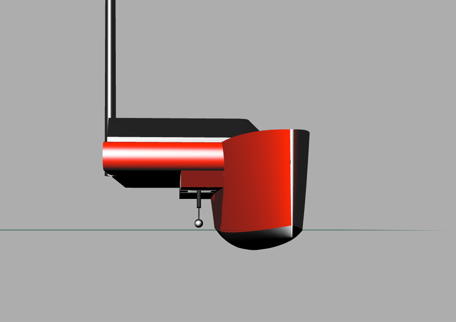

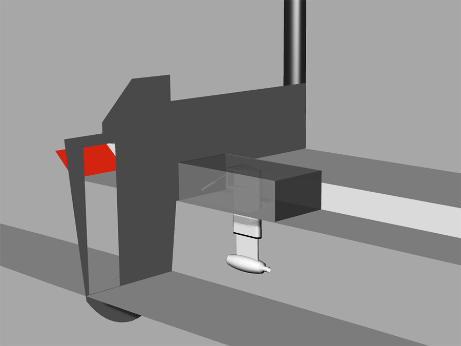

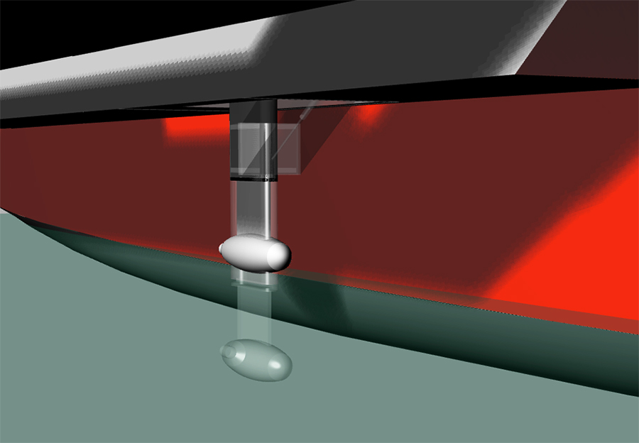

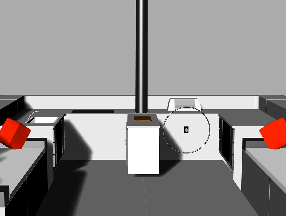

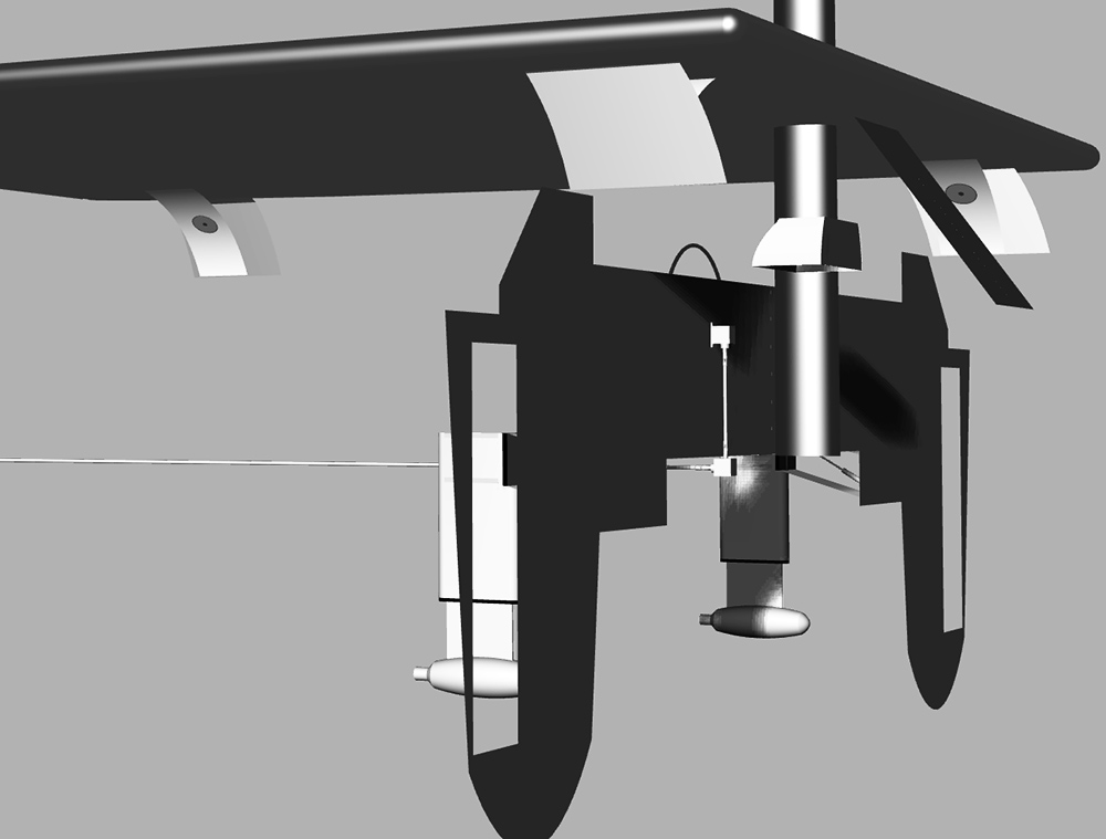

    Almost all weight is in the center of my design. The outboards, or pods on extensions, are just aft of the main mast beam. Here I draw them with a portabracket which gives you 24" of vertical movement. The batteries are inside the hulls no more than a few feet away. In the up position the pod isn't very high above the water, an outboard would give the advantage of having the builtin tilt. There is easy access to the hydraulic bracket from above and to the pod from below, no need to yank the boat if the pod goes bad.
  11. groper
    Joined: Jun 2011
    Posts: 2,506
    Likes: 174, Points: 73, Legacy Rep: 693
    Location: australia
    groper Senior Member
    If you are to have them hanging like that there will have to be zero play in the mechanism (hard to acheive in practice) or it will flog back and forth in a seaway when waves strike it. Constant flogging will make annoying noises and eventually destroy it in the long term. It really should come up much higher if it is to be stowed.
  12. jorgepease
    Joined: Feb 2012
    Posts: 1,620
    Likes: 51, Points: 48, Legacy Rep: 75
    Location: Florida
    jorgepease Senior Member
    Yes, that is the argument to also have a tilting mechanism, probably worth getting an outboard it might be nice to rig a tilting mechanism on the pod because then motor noise would be non existent.

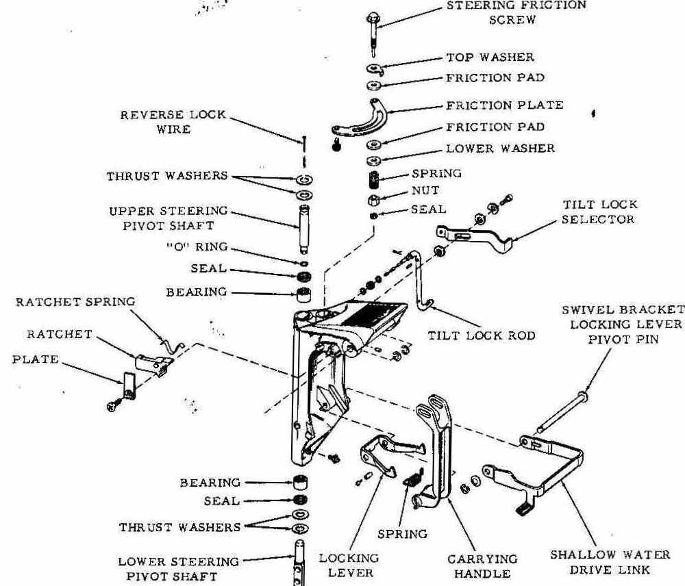

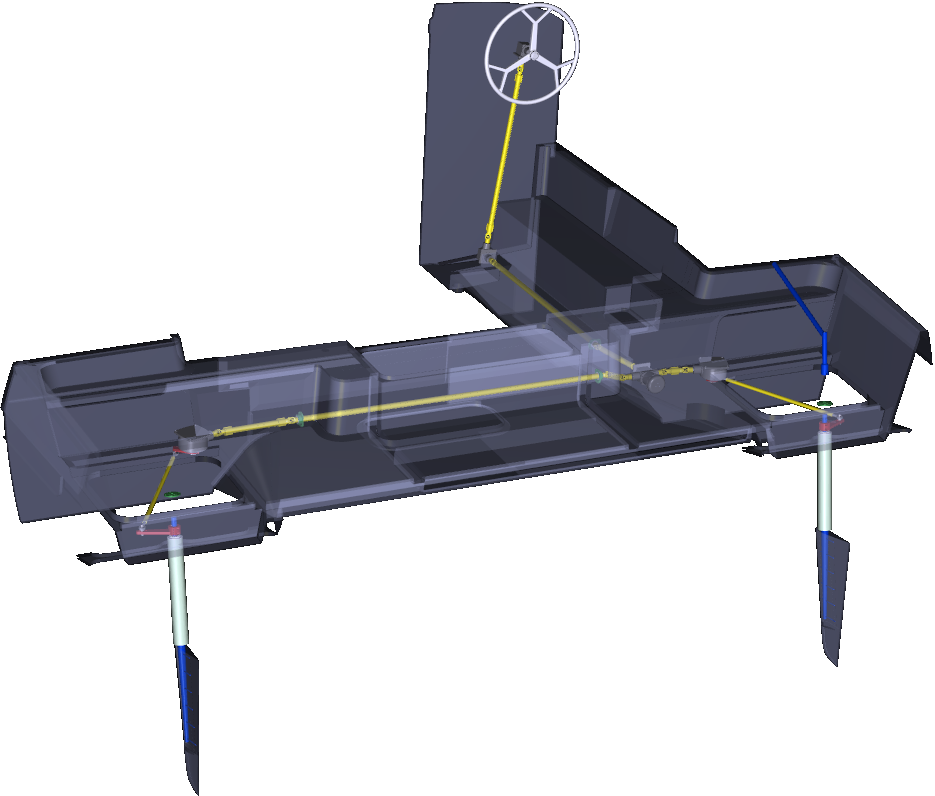

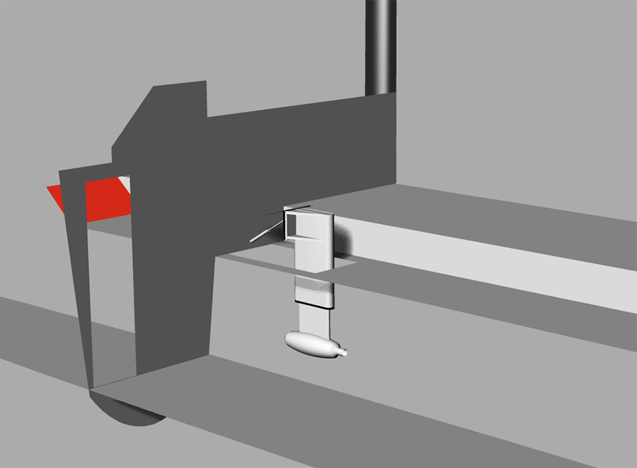

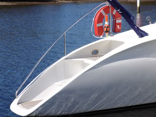

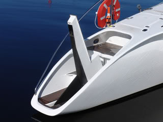

    Im going to lay out the steering for the interior helm. From what I read the transmission steering is good for when the helm is a long distance from the rudders. I plan to use a kick up rudder system similar to shuttleworths where the rudder kicks up between the transom steps unless I can find a better way. I can't figure out how the steering would hook up, only maybe if I terminate in a hub and switch to a flexible chain or belt. How is this normally done?
    cat-trans-1.png Kick-upRudderSystemweb.jpg PortTransomweb.jpg TransomDetailweb.jpg
    Thinking on how an outboard motor works, it can be raised, tilted etc without losing steering

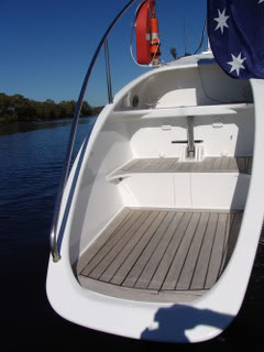

  14. groper
    Joined: Jun 2011
    Posts: 2,506
    Location: australia
    The way i normally see it here is the rudder shaft is mounted into a box which sits fair in hull. The tiller head on the top of the shaft is connected to hydraulic steering ram which has flexible hoses to it and the ram is also mounted on the pivoting box. So the whole lot kicks up and the flexible hoses allow the little bit of movement for changing geometry.

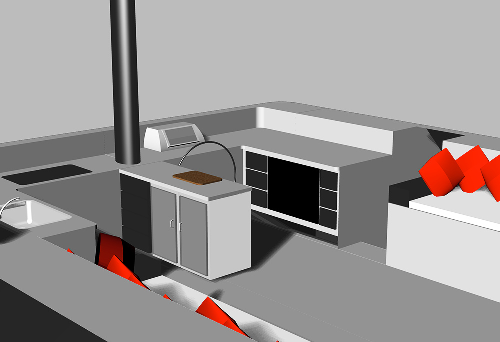

  15. jorgepease
    Joined: Feb 2012
    Posts: 1,620
    Location: Florida

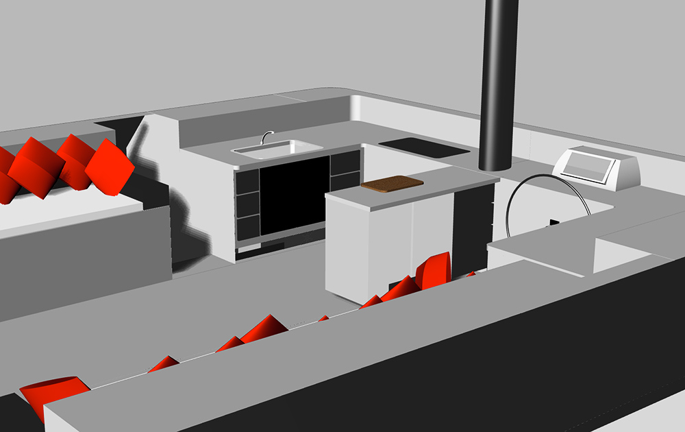

    I'd like to provide the tiller option but also want the inside helm to have a good feel. The Jefa transmission steering systems look pretty robust, easy to install and is supposed to give you a nice feel, I don't want to ruin it in the last few feet with hydraulic but maybe a cable system at the end. First I want to see how the rudders will work on this boat.
    I had to shrink the galley a bit more, got rid of the barstools, I will put a nice helm chair instead, just leave that side of the room to navigation and controls etc... boat is getting lighter by the day ))
