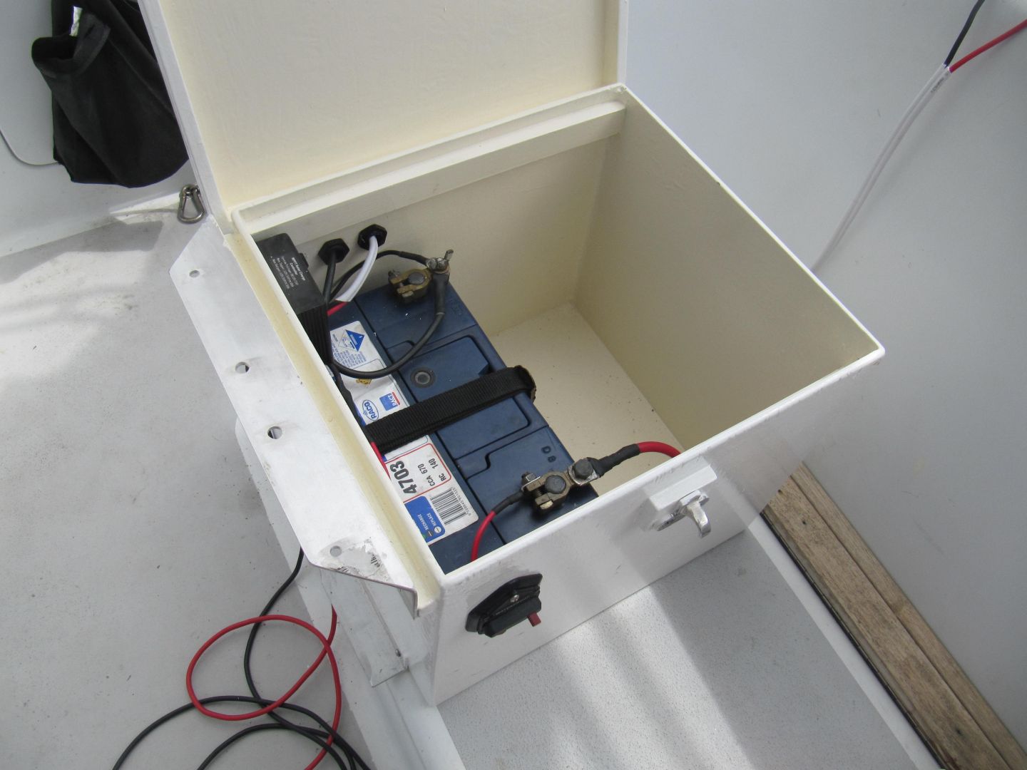

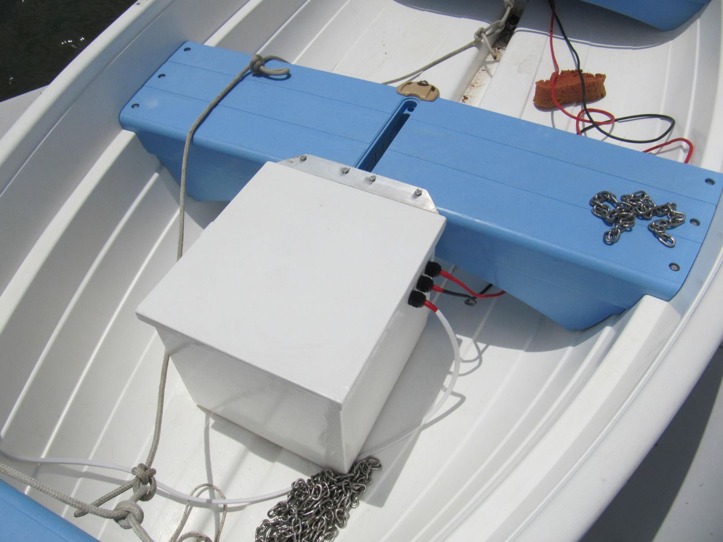

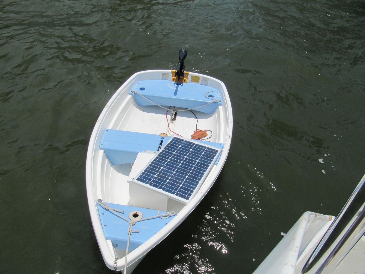

    Here is one I knocked up cheap. $12 charge controller (epoxy encased) a free car battery, 60w panel (the max physical size I was willing to tolerate), and $140 ebay trolling motor.
    Dingy is a walker bay 10 (the BIG walker bay, most are 8 foot!) and did hull speed, range of a few miles. It was used primarily to get to and from the dock daily for several people at the cats usual mooring in the Brisbane river. The trip was only about 300m return. It was never flat. It had to be all cheap stuff for theft reasons.
    I loved not having to fill in fuel, no noise and smell. It was great. The perfect tender for this job IMO. People always asked about it. However, I used a RIB for actual cruising and left that one as a mooring minder after attempting to use it as a real yacht tender a few times while actively cruising. It was woefully inadequate in any sort of chop when we went cruising, to mainly due to the dingy itself. Obviously it was no good as a dive boat etc either.
    The cheap motor died in 6 months due to the cowling not being waterproof. This was never packed away and was expected to take salt and fresh water daily. We purchased a far more expensive "watersnake" which lasted about 1 month showing a high price often means SFA. I think a real salt duty electric outboard may have fared better, but no way was I leaving that tied to a dock.
    Obviously many people have this sort of dingy as their main tender and seem to put up with its deficiencies, so its not like you cant do it. :) I reckon a 10 foot rib with a torqueedo and big lithium battery would be a big step up in usability. Not being able to plane would suck, but obviously planing IS possible with electric tenders too.
