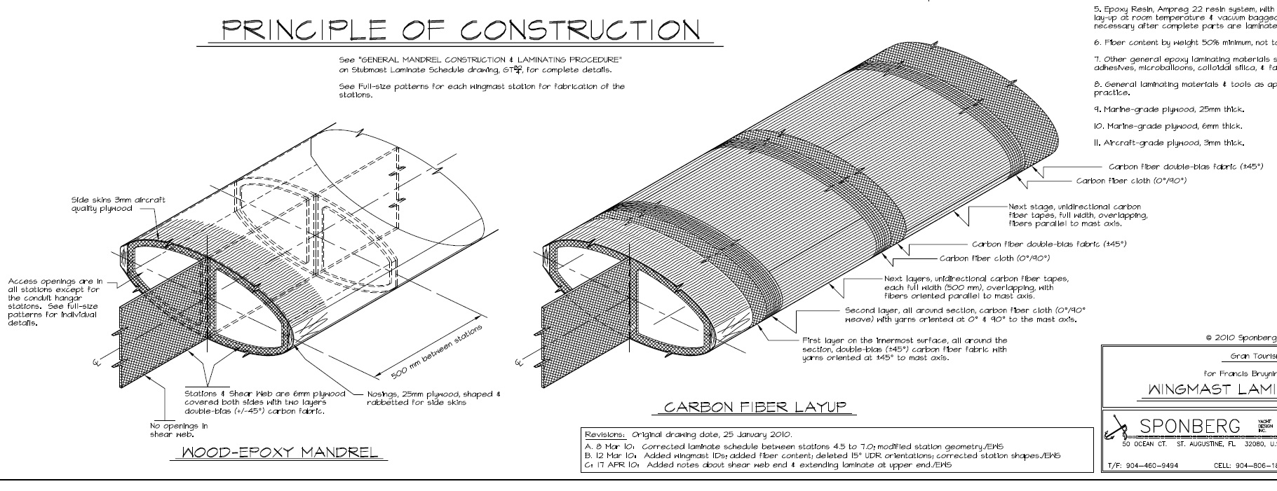

    Doesn't work like that Jorge. It has to be in a female former so that the fibers are being stretched outwards against the mold surface instead of crimped inwards and you end up with wrinkles and poor fiber volume fraction. I've a lot of reading on this, female is the only way to go.
    The sheet metal should be supported by longitudinal battens inside the frames spaced closely to get rid of most of the waviness. Again this is for a one off, if building several you could justify a bit more of a substantial mold such a a 2 piece mold with a vacuum bag sleeve inside...

    Ah okay. ... Well, then battens would do it. Love it!
    I don't know the material but it seems you could edge butt, tacky tape, then duct tape over that and fairing would be minimal.

    remember the uni!
    IMHO, best to lay and bag the assembly - uni tapes (cheaper than cloth) and biaxial - in female half molds as any bulk waviness is inside the mast.
    using half female molds also allows you to reinforce attachment points easily.
    layup in 2 halves, run conduit and mast track, join, fair if necessary, and layup fine cloth with vacuum bagging against the mast itself.
    big question, do you want to gel coat the female mold or paint after joining?
    are you going to have a professional design the layup schedule? this was on the web and is for a wing mast with plywood base so your schedule would be different -- from Spoonberg and just for reference

    Making a ply mandrel and wet laminating then vacuum bagging over it (multiple times) is a huge amount of work. Try the method I described on previous page and you'll see how quick and easy it is, just make a 1m long section to test.
    I'd hire a composite engineer to design it- although it wouldn't be too difficult to figure it out, I have lam schedules for similar masts but the RM of every boat is different so it should be checked.
    I'd opt for spreader less mast with upper and lower shrouds coming back to the same chain plate. No diamonds or any other junk, single forestay. All synthetic fiber shrouds. It's all DIY friendly and quick to setup- check out Colligo marine website to see how it works. We used this on our last cat and it's so simple and lightweight. I think it even works out cheaper than stainless at current prices.
