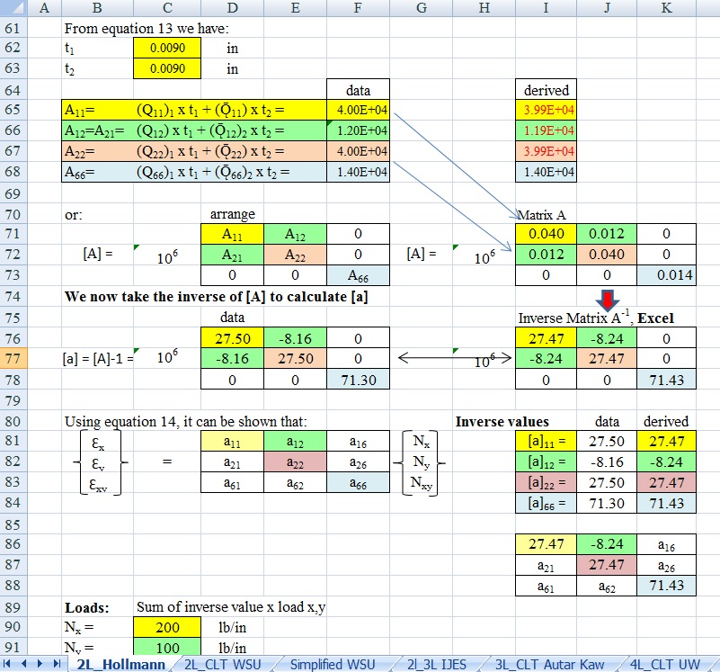

    You can easily program the CLT matrix format in Excel. Excel has the inverse command to build up the ABD-1 matrix. I have done it using textbook examples. I don't know of any FREE CLT program available but I bought mine some 15 years ago at SAMPE for $200. Still works fine but I have to use an old computer. Generates report on ADB matrix format. The Newer programs available now cost $2,000 above.
    Just remember that CLT programming would require at least the material properties even for a single ply orientation. If it is rotated, the matrix will do it for you but the initial properties has to be right.

    So if I cannot avoid matrix inversion , I will have to do it, and at least it will be a good intellectual exercice.
    So I have to find the relevant inputs:
    E(theta) =probably the Young Modulus
    E2 = Transcerse Modulus
    G = Shear Modulus of Elasticity
    vega= Poisson's ratio
    I guess I will have to calculate E(Theta) for the different wrapping angles (0° / +45° /- 45°/90°) ?
    Please can you tell me if it is a correct approach ?

    E, Poissons, at 0 and 90 degree. Shear modulus and thickness can be computed. These are minimum inputs for 1 laminate. The Etheta can be calculated by the CLT.
    CLT models can be same laminate, one rotated to an angle, two laminate, different material, three laminate with same properties, three lam with different properties.
    I have several models. The one downloaded from Wayne State university is the most complete as it has solved examples.
    Should be easy for you. You have formal training. Me, I have to figure out everything.

    Possible to do inversion in Excel

    Thank you very much RX, and Dejay,I will pay attention to the document DEJAY has post, as there are many solved exemple and it will be a good way to learn.
    I know Excel has a matrix inverter, but I never used it so far, but soon I will.
