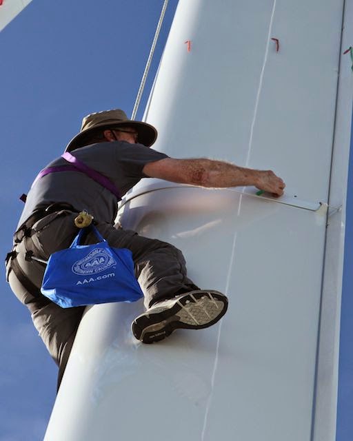

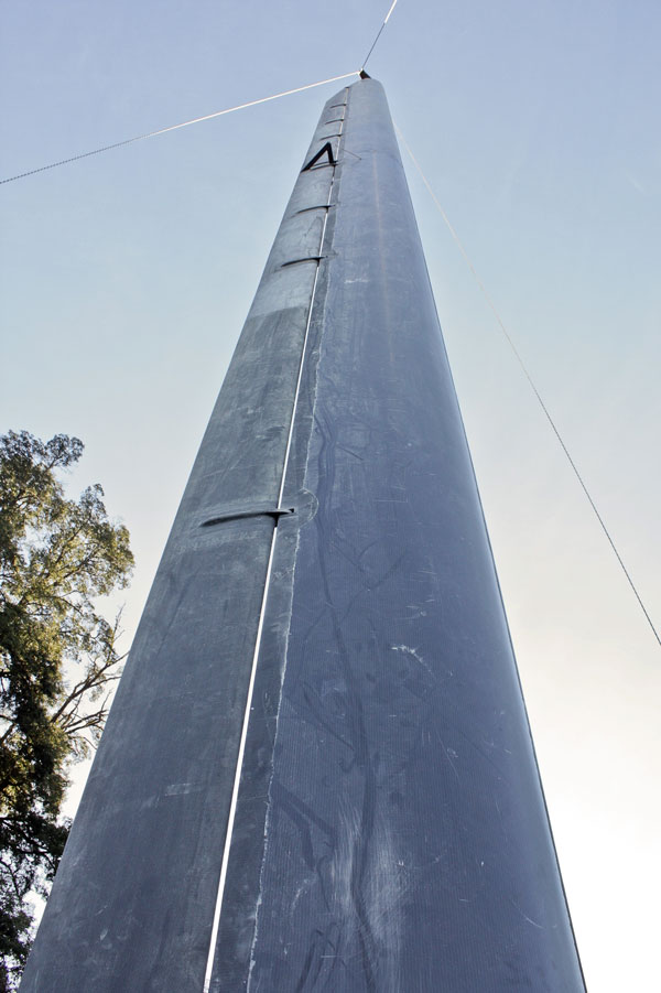

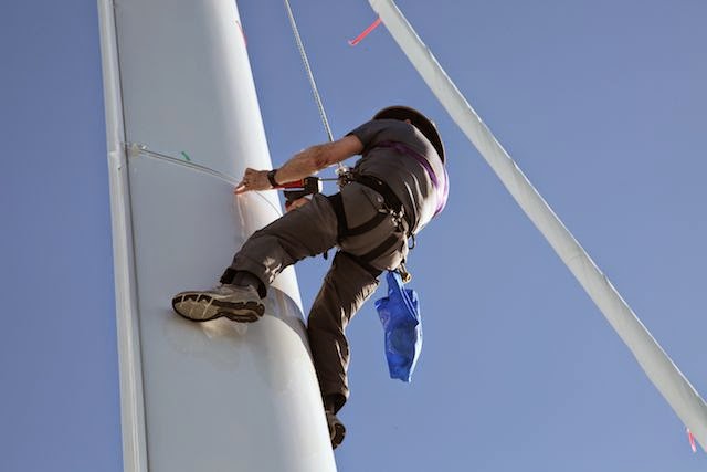

    brian eiland Senior Member
    Found this photo today of the original MastFoil mast.
    Appears to answer 2 of my questions about the size of the original foil
    1) bigger than the more recent design, and
    2) there are some hints as to how the foil was attached.
    As found a few photos that might give someone a general idea of the size of these foils.

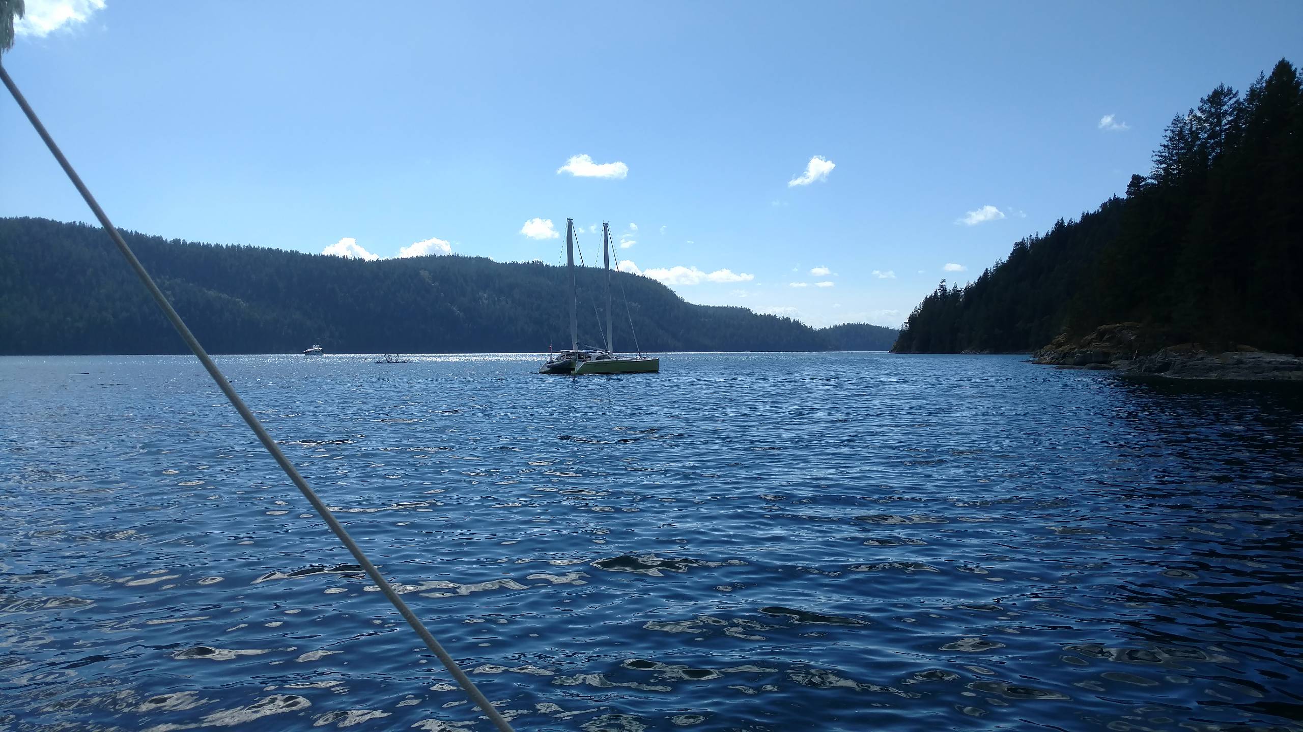

    I did see a Mastfoil cruising in BC this summer in Desolation Sound at Teakerne Arm. We had already anchored near the waterfall when one came in. There was wind in the channel but it was light in the arm so it powered after crossing the wind line. From what I could see it seemed cruising oriented in performance as you would expect. Steady rather than hot. From a handling perspective it seems a nice update of the staysail schooner concept. For light winds I imagine code 0s would be in order.
